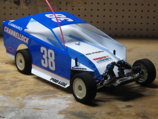

i'll check it out. my wife told me that they're calling for rain, so i might not get there tomorrow. i hope it doesn't. i'm planning on taking "old reliable" out for some hot laps. it's been sitting on the shelf since '01.
- Attachments
- IMG_0248.JPG (174.95 KiB) Viewed 1400 times
