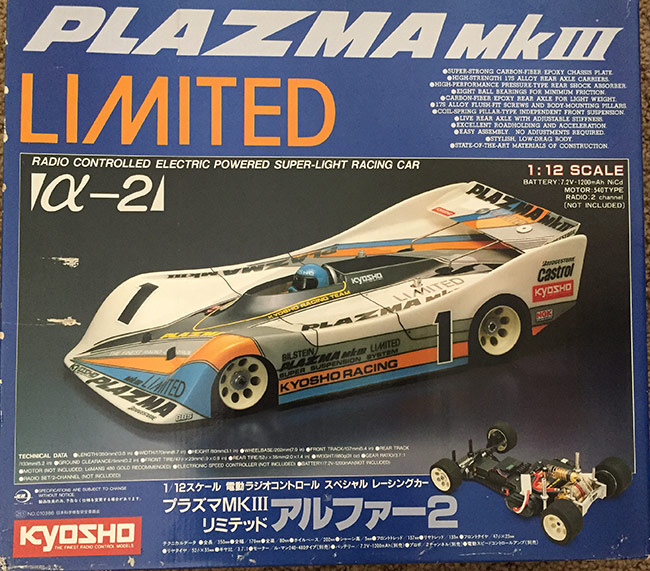

What is the best way to preserve a vintage decal sheet just in case I need to have them reproduced at some point? Anyone have a preferred method they've tried successfully? I am getting close to attempting to paint one of my bodies with a decal sheet containing several specific decals that are almost certainly irreplaceable, since the exact kit is so rare (Kyosho Plazma Limited α-2). I wouldn't do the actual decal creation/reproduction myself, but I want to scan them & make sure I prepare the digital file properly in advance, just in case I goof up the body prep or just want to produce a spare. I have a few other really rare kits in my collection for which I will wind up in the same situation (if I ever get around to building them), so I’m interested in opinions on the best process.
