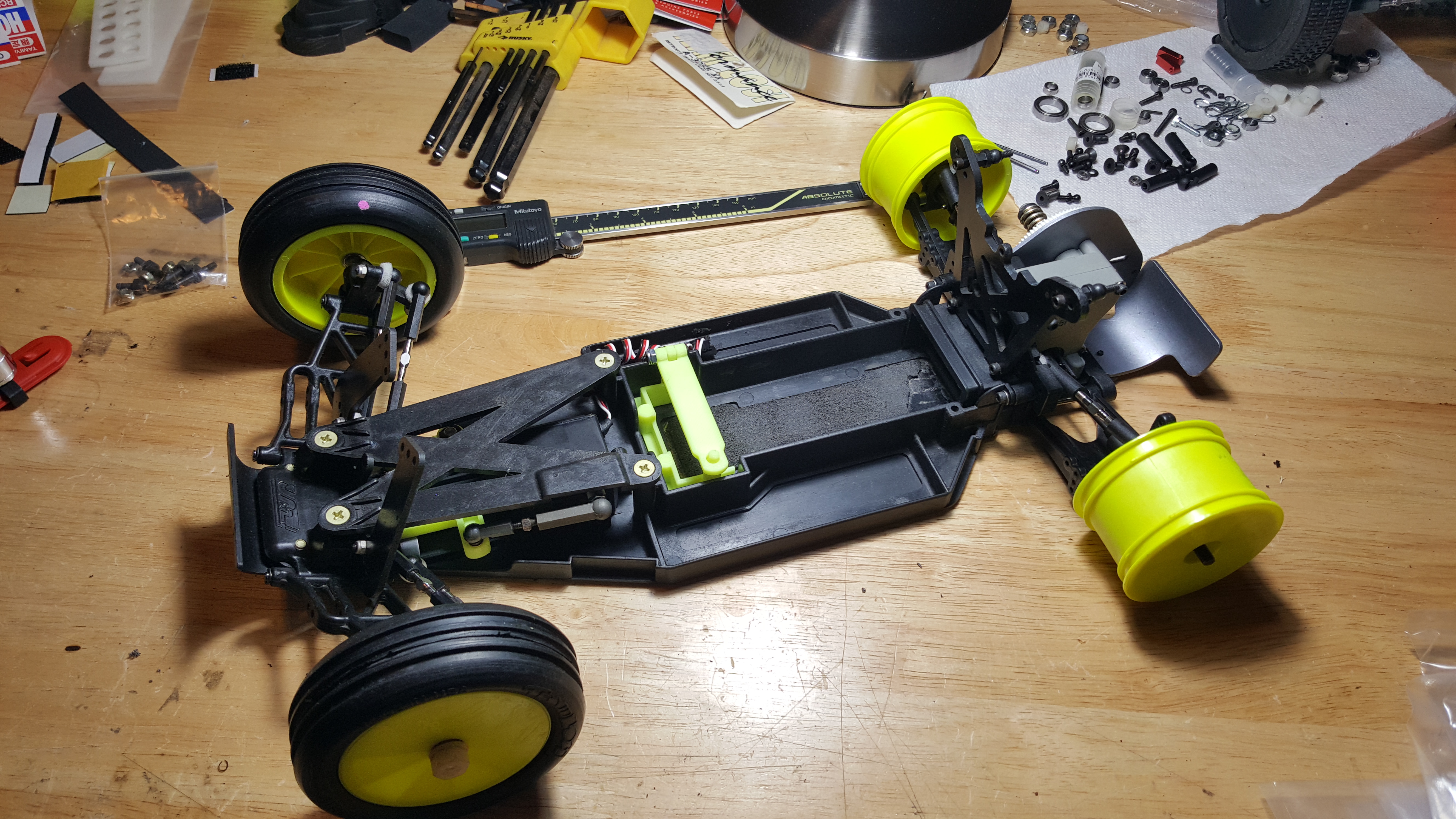

JRX Pro SE runner build
Post by sixdub »
The original idea for this build was a low budget runner using the best used parts from my pile. As with any project, there has already been significant "scope creep" as visions of big bore shocks, modern tires, and mild brushless power sent me to Ebay. :mrgreen:
So now I'd like to end up with a mildly capable, trackable buggy thats equipped with modern parts in the right places.
I forgot to take pics earlier in the process, but up to this point it is basically a stock SE in long wheelbase configuration.
Test fitting B4 wheels
XX retrofit trans in 2.6:1 "truck" ratio. This ratio is the same as modern buggies and will allow me to use the brushless gearing knowledgebase on the intarwebz. Also using dogbone outdrives and tecnacraft turnbuckles.

I'm still working on axle lengths and shims to get the track width right. I'll post details when I get it sorted. I'm sure a thread exists here that spells it out, but I haven't spent much time searching.
A little progress. Upclose with the Sabulatech battery holder and servo mounts. To avoid servo tape, I'm using Kyosho RB5 mounts I had at hand. I'm also using Sabulatech bearing bellcranks.
The shocks arrived, bigbores for a Losi 22-4. They should be pretty close to the right length, but may need an internal limiter to be perfect. Spring rates may be a challenge to get right, but I'll build them with the supplied springs and deal with it later.

A little more progress. Built the 22-4 shocks without oil to test fit.
Rears fit nicely. Length looks spot on.
Droop looks ok
Fronts fit well. Overall length is a couple mm too long. I'll have to install some internal limiters .
I'm using upper shock mounts from a Losi SCTE and had to drill both the towers and the 22-4 shock bushings to fit, as the mounts are larger diameter with 5-40 hardware.

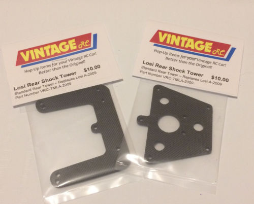

I did.....
I'm now just waiting for them to arrive. :D
Those towers look nice. I even like the packaging. I see they are both labeled as rear towers though. The seller must've needed to save some $ on the fancy packaging. :D
Matt

LosiXXkid
Posts: 757
Re: JRX Pro SE runner build
Post by LosiXXkid »
matt1ptkn wrote: Fri Mar 03, 2017 8:17 am
LosiXXkid wrote: Thu Mar 02, 2017 6:21 pm
Splat! wrote: Thu Mar 02, 2017 12:37 pm Thats looking great, Nice work!
Did you see the guy selling woven carbon towers on the bay for this and other older Losis? They would set this build off perfectly!
I did.....
I emailed the seller (Todd) because he didn't have the original front shock tower listed to which he replied that it was being cut and would be listed shortly so I think the header card was probably done in a rush!
