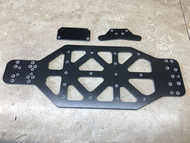

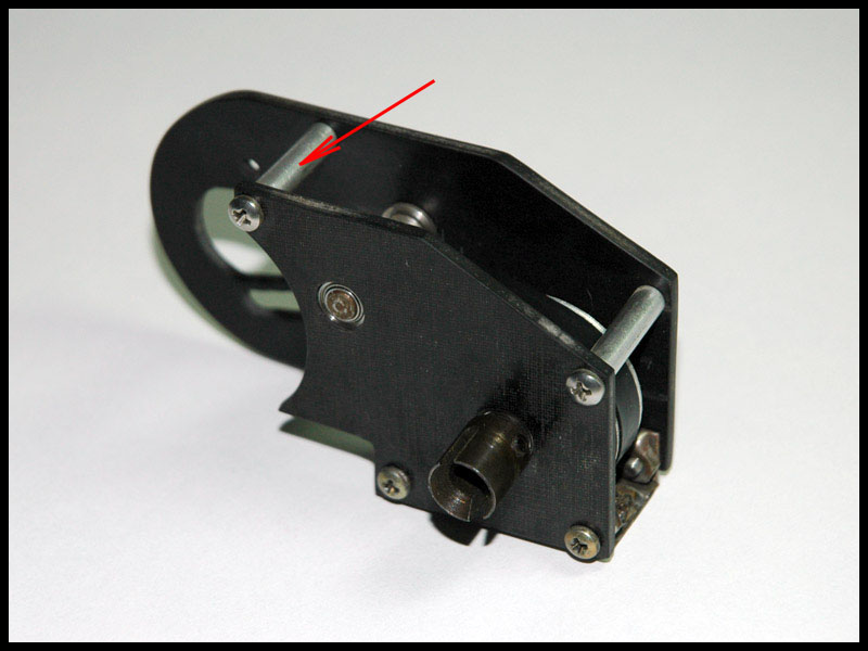

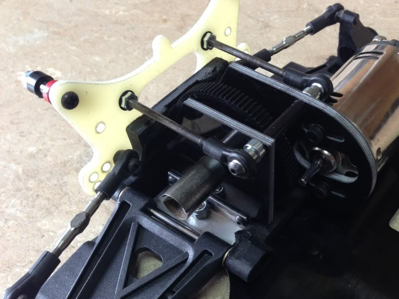

Don't really know which was more appealing or desirable, just something different. I kinda assumed the direct drive was designed for more on-road and the belt for off-road, just a guess. I've seen them both ways. Trackmaster also made an oval conversion chassis that used the RC10 suspension. GoMachV makes a fiberglass copy of the conversion chassis. There is no provision to directly brace the drives to the bulkhead, but you can get creative. On the belt drive, I thought replacing the threaded standoff with a thru bolt, 2 wide spacers, and a turnbuckle to a brace on the bulkhead. There is an example of anchoring the direct drive also.
Replace standoff with spacers and tie rod to bulkhead
Bracing example on direct drive
GoMachV's conversion chassis
