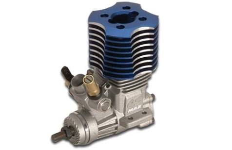

Re: RC10GT & modern starter boxes?
.12 OS CV-R is one of the best engines made in my opinion.
Wow!! That looks perfect just what I am looking for .12
The thing that made the CV-R a standout over the CZ/CV was the chrome plated sleeve. They were extremely reliable, easy to tune and made good power for the time. The .15 CV-R would make a GT wheelie easily all day long while the .12CV-R would occasionally, for racing you could only run a .12 anyways.
Believe it or not those AE .15's were really good engines.

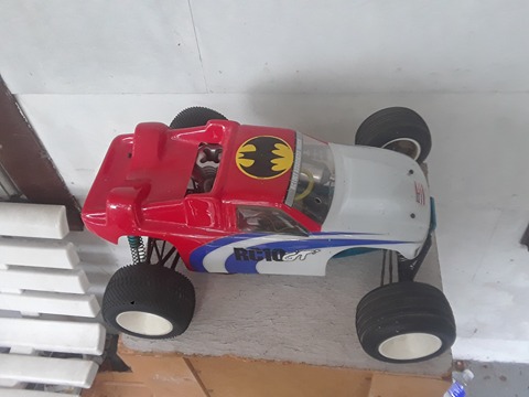

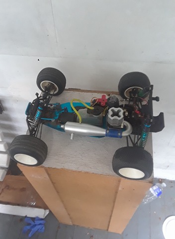

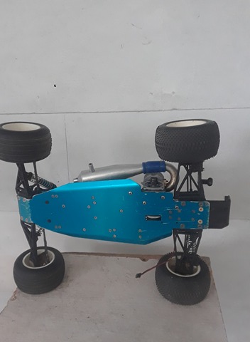

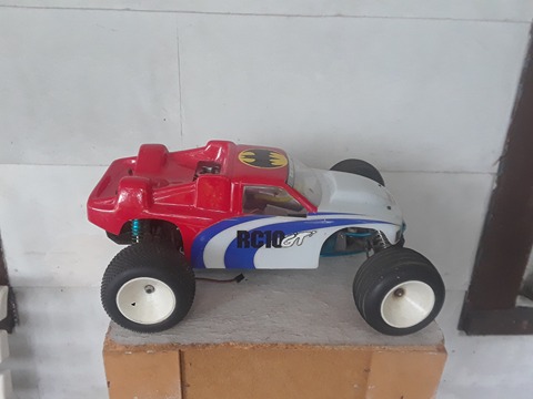

Fired her up for the first time since 2003/2004 using the LRP blue competition starter box with just a 2s lipo. Had to use my os #8 glow plug I had laying around new in package. She is almost ready to make bacon on the beach!!
