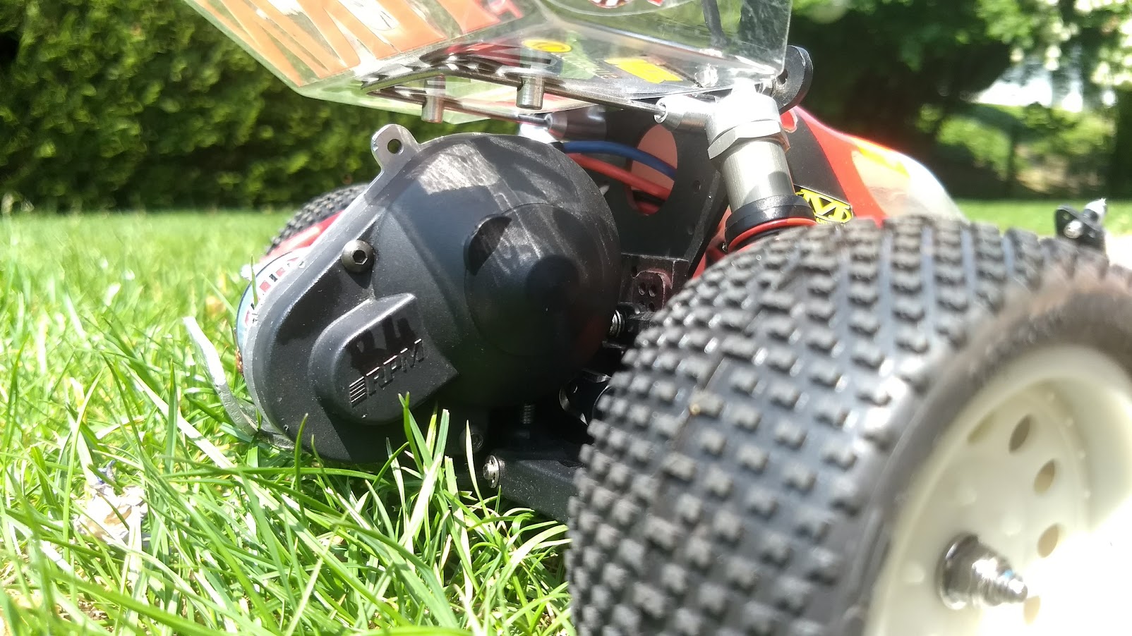

Hi guys,
I wanted to give a quick update about this one.
I got my hands on a Rustler cover, but the "bracket" bit looked a bit odd, really.
I had an RPM B4 cover laying around... a quick blank assembly showed it could work, albeit with a smaller spur than the 87T I had planned.
The bottom hole works just fine... but one needs to drill the motor plate for the top hole, then tap it. But it's a rather easy one, really. And it's as a good a fit as can get :)
Thanks everyone for the help :)
