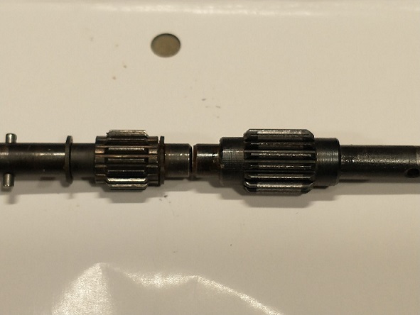

It's almost a direct swap for the layshaft. My post right above yours describes the steps for doing this
I'm pretty sure the diff gears have a different number of teeth, as do the output gears. That's why they have a different part number. The reason the layshafts have a different part number is not because of the teeth count (which is identical), but rather because of other differences, such as the drive pin location, again which I point out in the post above.

Okay, got some bits for the gearbox rebuild but I want to check on what you've done with the layshaft.
There is a considerable difference in diameter of the toothed section between the standard Rampage Pro layshaft compared to the Pro X version (SST7)
It does go in (once spaced correctly as you've mentioned) but there is considerably more backlash obviously due to the smaller diameter - to be honest I didn't think it would even drive.
I certainly wouldn't be confident driving with it. Have I misunderstood something?

I think what you mean is the lengths (not diameters) of the toothed sections are different, and yes, they are. That is compensated with an additional bearing on the longer side (per my recollection and as stated above in the thread and video link), to pick up that extra slack.K Rob wrote: ↑Wed Dec 29, 2021 9:05 am Okay, got some bits for the gearbox rebuild but I want to check on what you've done with the layshaft.
- K Rob
- Posts: 36
- Joined: Mon Aug 08, 2016 11:00 am
- Location: Birmingham, UK
- Been thanked: 5 times
Re: Kyosho SST transmission diagnosis
I mean the diameter of the section of shaft with teeth on it.
Unfortunately I don't have the Rampage shaft to hand as it's with a chap making a motor plate for me to show a comparison, but it is bigger in diameter than the Pro X version.
So the Pro X version does not give a good connection to the diff gear when it's in the Rampage box.
There is too much backlash between the gears using the Pro X shaft.
