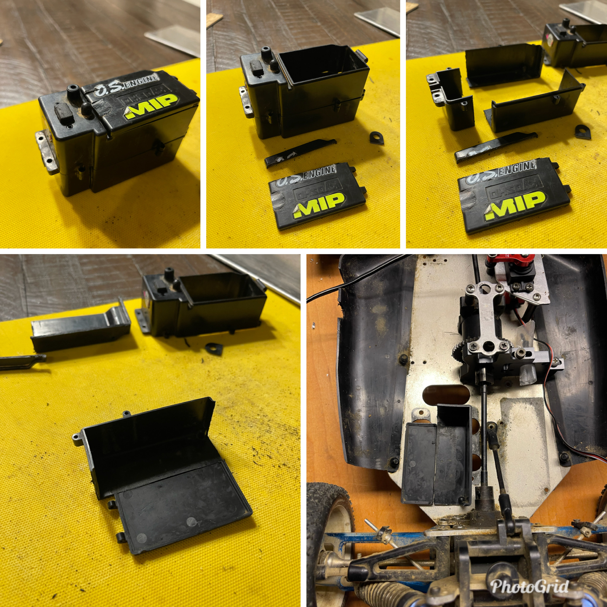

Re: Electric conversion Kyosho MP5
I’m converting my original MP5 to brushless. Already got the harder part done (motor mount). As soon as I figure out how to share pictures here, I’ll show you!
This is the motor mount I used: https://m.banggood.com/1-or-8-Rc-Car-Off-Road-Vehicles-Truck-Nitro-Change-Brushless-Motor-Mount-Holder-Parts-For-Kyosho-HSP-Hobao-FS-Racing-p-1615165.html?rmmds=orderdetail
The holes were off, but not significantly, so I was able to just use a round file to extend the chassis holes a bit. I also had to 1.) cut that little metal square off the mount with a hack saw, and put a shim under the remaining factory center diff mount because it was an 8th inch raised after installing the metal motor mount. I just cut off an 8th inch from the scrapped diff mount in order to lift the remaining one.
Cutting the servo tray was easy.
