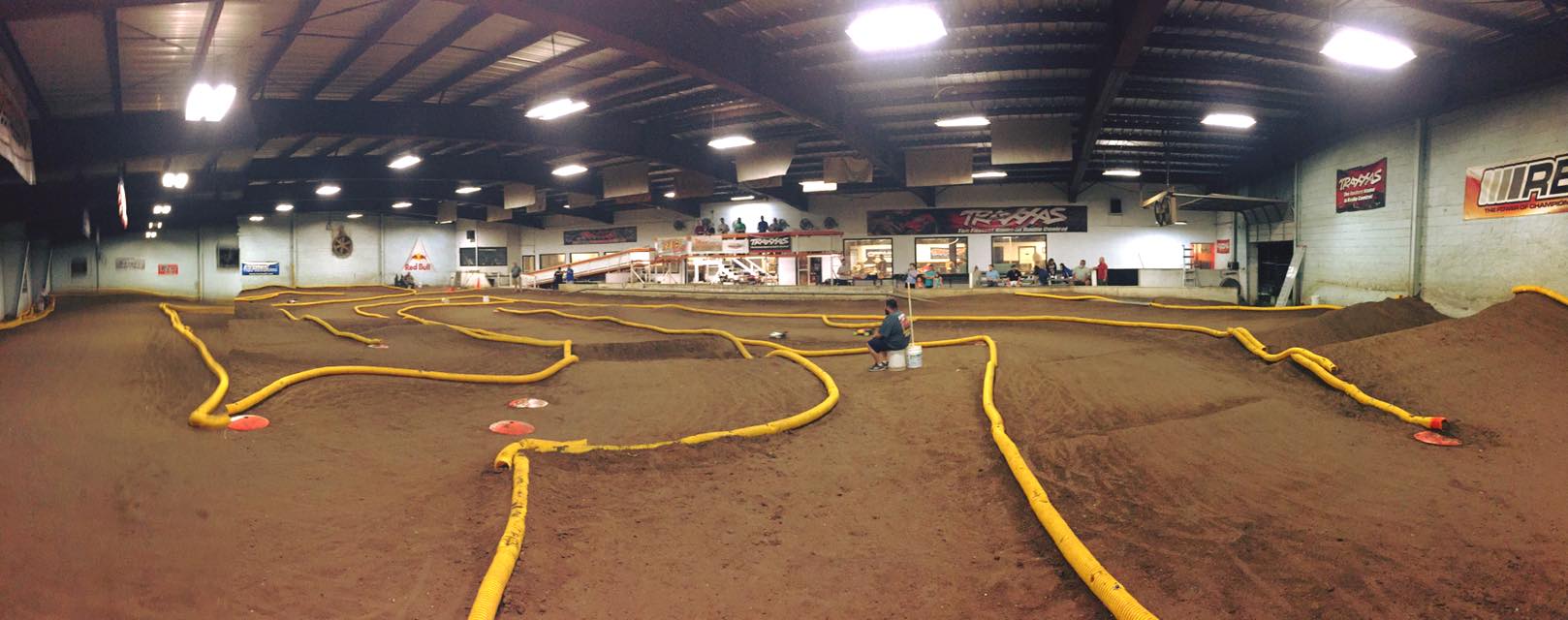

I mainly want to go at practice times, but if I decide to race......I'm not expecting to win anything, just fun.
This is the track right now.
