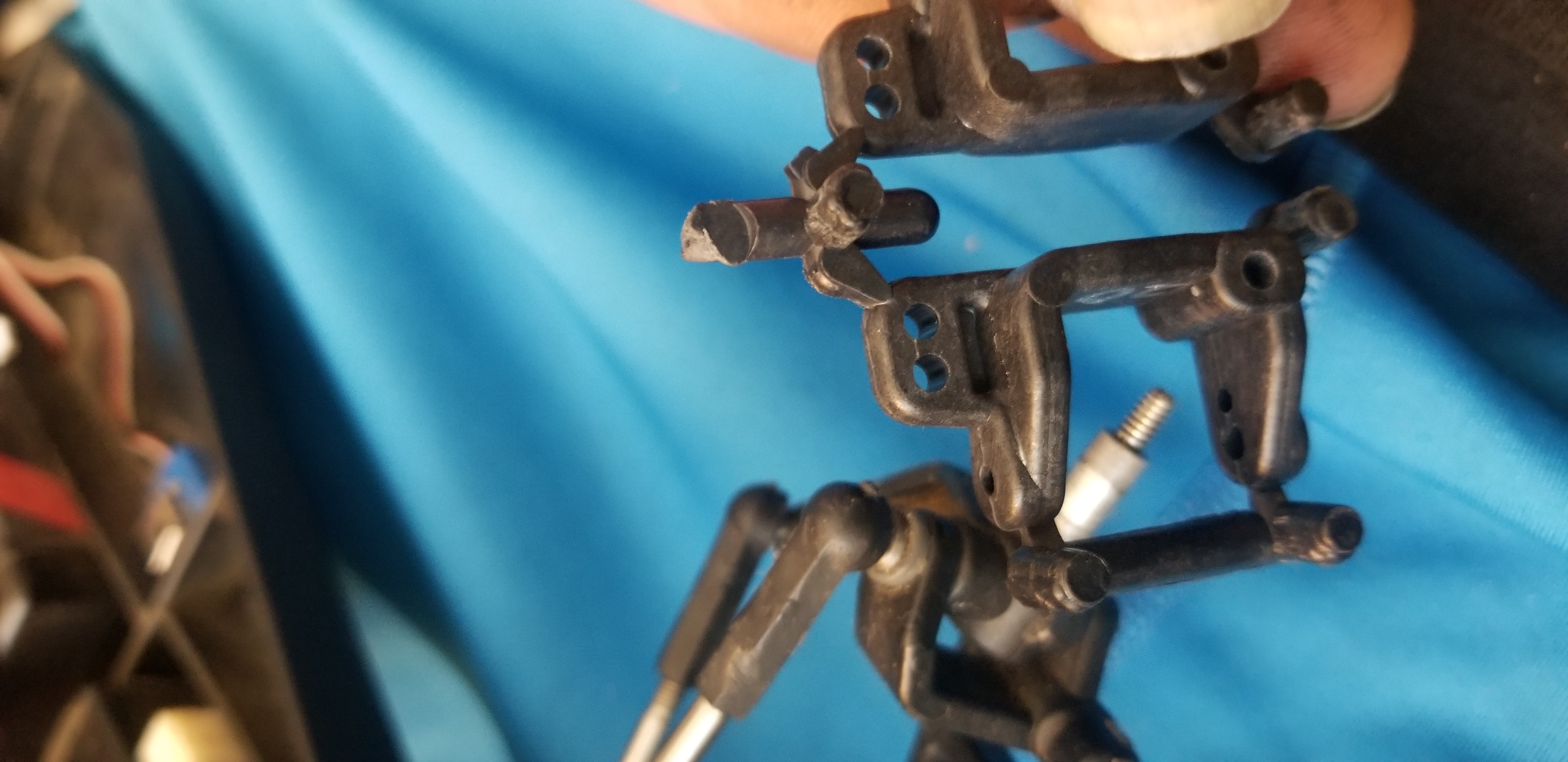

Anyway the B3 25 degree caster blocks are too hard to find and a few have suggested getting 20 degree B4 caster blocks bec of the 5 degree kickup difference, hence with my 20 degree B4 caster blocks on my B3 (which i restored and love to drive) i can achieve 25 degrees caster.

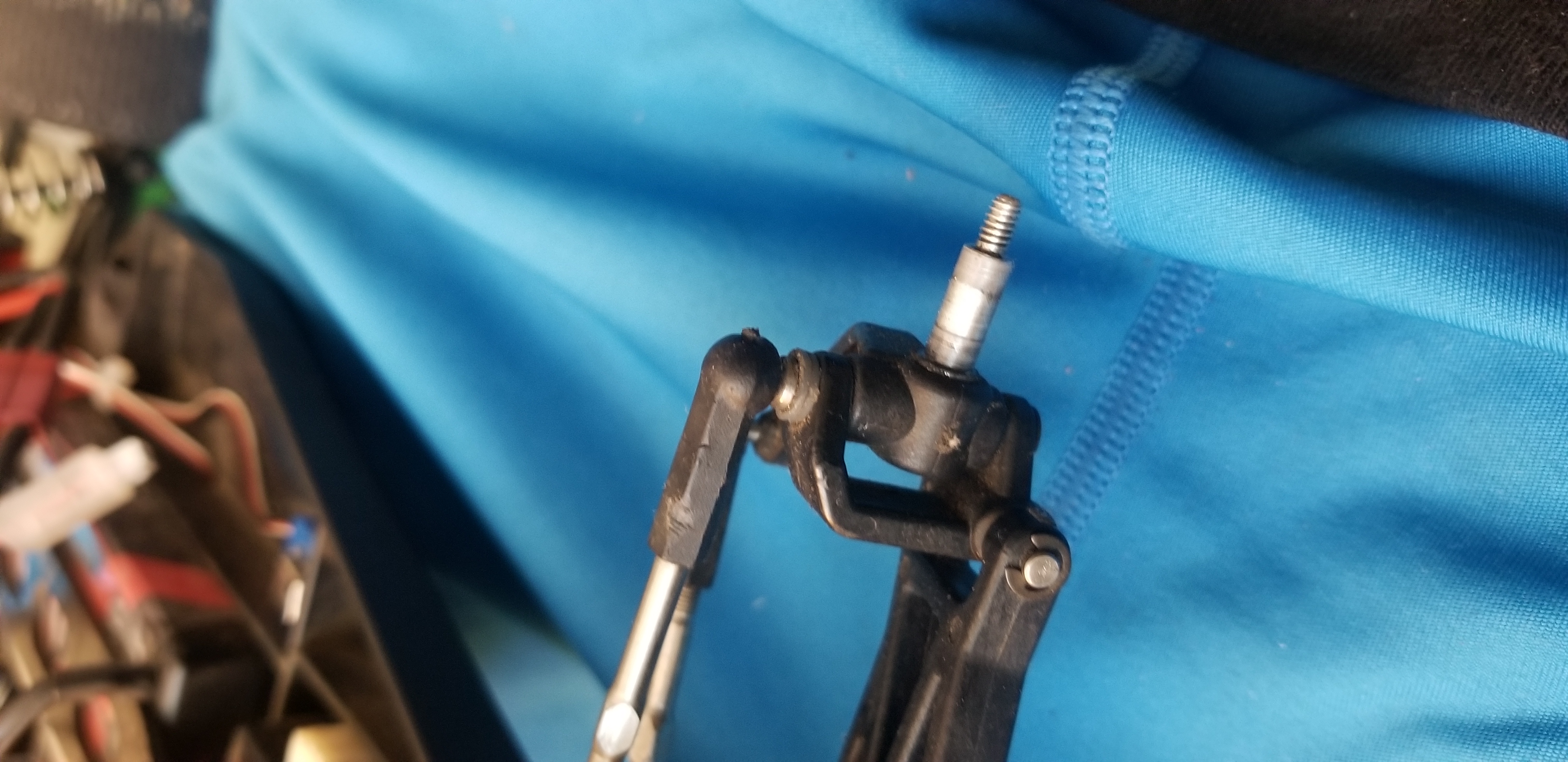

Only problem ive run into is the steering block/arm/axle carrier vertical pin on the B3 utilizes a ballstud to screw into the top of the pin and thats what holds it in rather than an eclip.
Should i cut the horizontal mounting holes for the camber link ballstud off of the B4 blocks and utilize the vertical hinge pin mounted ballstud configuration on the B3?

Here are some pics to clarify....

the b4 parts are cheap enuf to see if it would work to dremel off the top ball mount so you could keep the original king pin setup. Its gonna take some experimenting no matter what at this point. I too would go to my b3 over quite a few other runners so kinda curious how it turns out for you...
