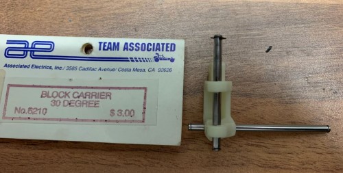

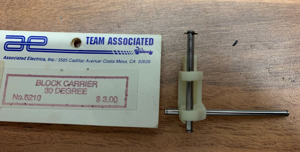

Hi all,
I am confused, I just opened an old package out of my stash of 6210 caster blocks, see picture below. These caster blocks are no where near the 30 degrees. More like 0 degrees. Is this a known issue?
I also found black 6210s in online shops. Will these have the correct caster angle?
I forgot to take a picture with hinge pins installed to show the angle, I will add that when I get home.
Thanks for any help,
Tony
Tony

Re: 30 degree Caster Blocks 6210
30 degree blocks will have a straight through hole, 90 degrees to kingpin. When installed in the arm with 30 degree kickup, you get 30 degrees caster
And the 0* makes it so its 90* to the ground when installed correct.
- Posts: 12336
- Has thanked: 1129 times
- Been thanked: 3919 times
Yeah, effectively what AE is calling degrees is not the degree of the actual part, it references what it will end up being when installed on a kit with a 30* kickup

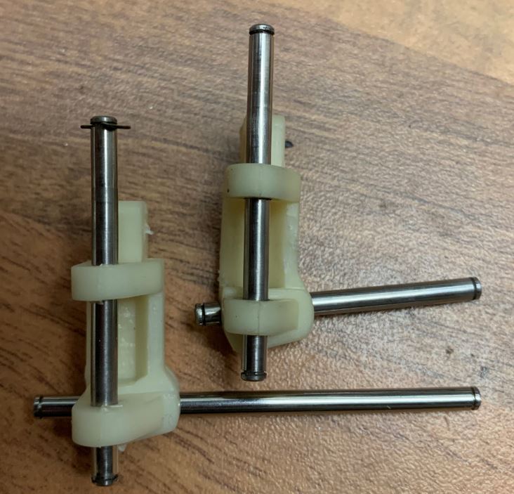

Here are some more pictures.
The one set with the large angle was marked 25°, so that would have been labled as a 5 degree set, right.
Thanks for the replies of couse.
Do they still do it that way on newer parts?

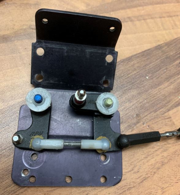

I have almost finished a graphite mid-motor conversion with a flipped front arm mount and shock tower. there I needed the 25° in the caster block to get the front turnbuckles to work.
Will post pics in a different thread.
