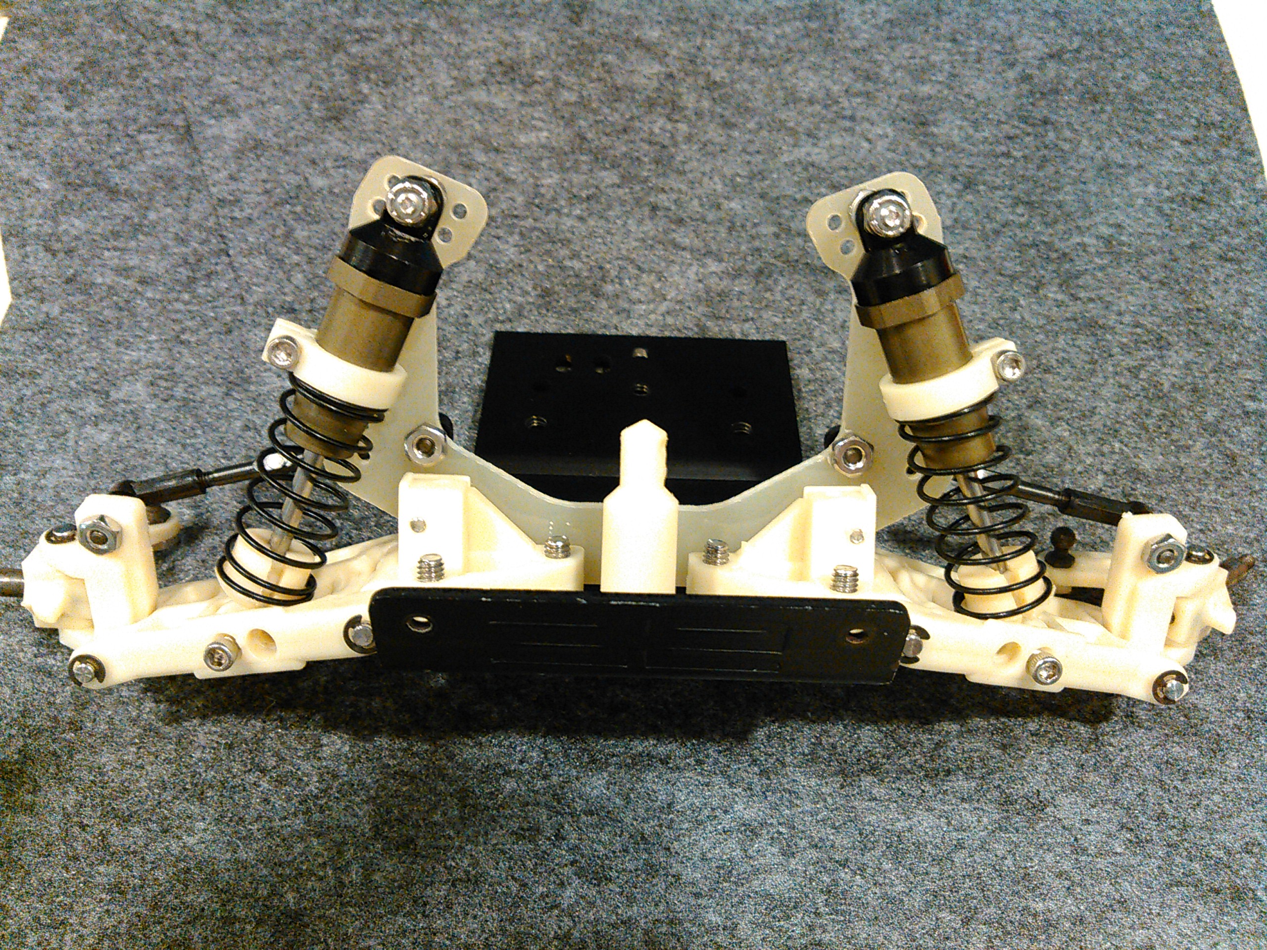

I'm making some progress. Here's the front. I'm using KNK stainless hardware.
