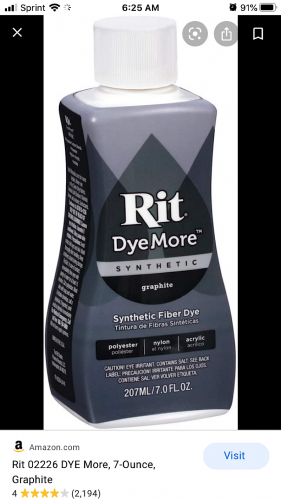

if anyone has time could they possiblty attach a link as to which dye i need?

Re: Dying white wheels black, help
I recently dyed some parts and didn’t use the Dye More stuff until my fiberglass parts didn’t take. The graphite comes out very dark. When I did my parts I found a cheap pot at Meijer that had a little basket included to keep the parts off the bottom. Here’s a picture of what you’re looking for.
perfect thanks, will it appear black?
also has anyone succesfully dyed a set of yz10 wheels? just wanted to make sure they will take the dye before i ruin them!
They will appear black. Under certain light conditions you can see some shading but it's very hard to see.
Real yokomo wheels should be dyeable with no problem.
