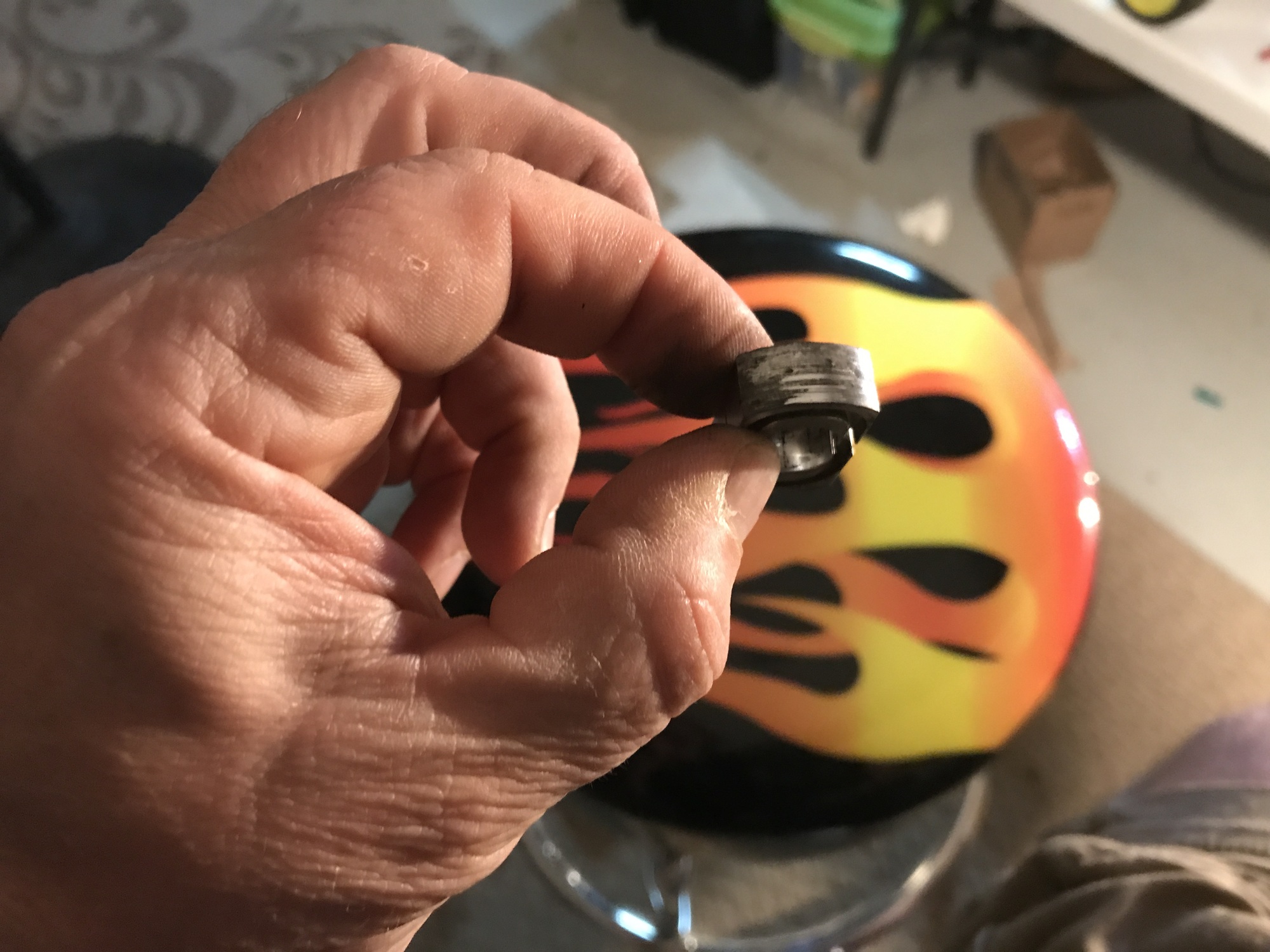

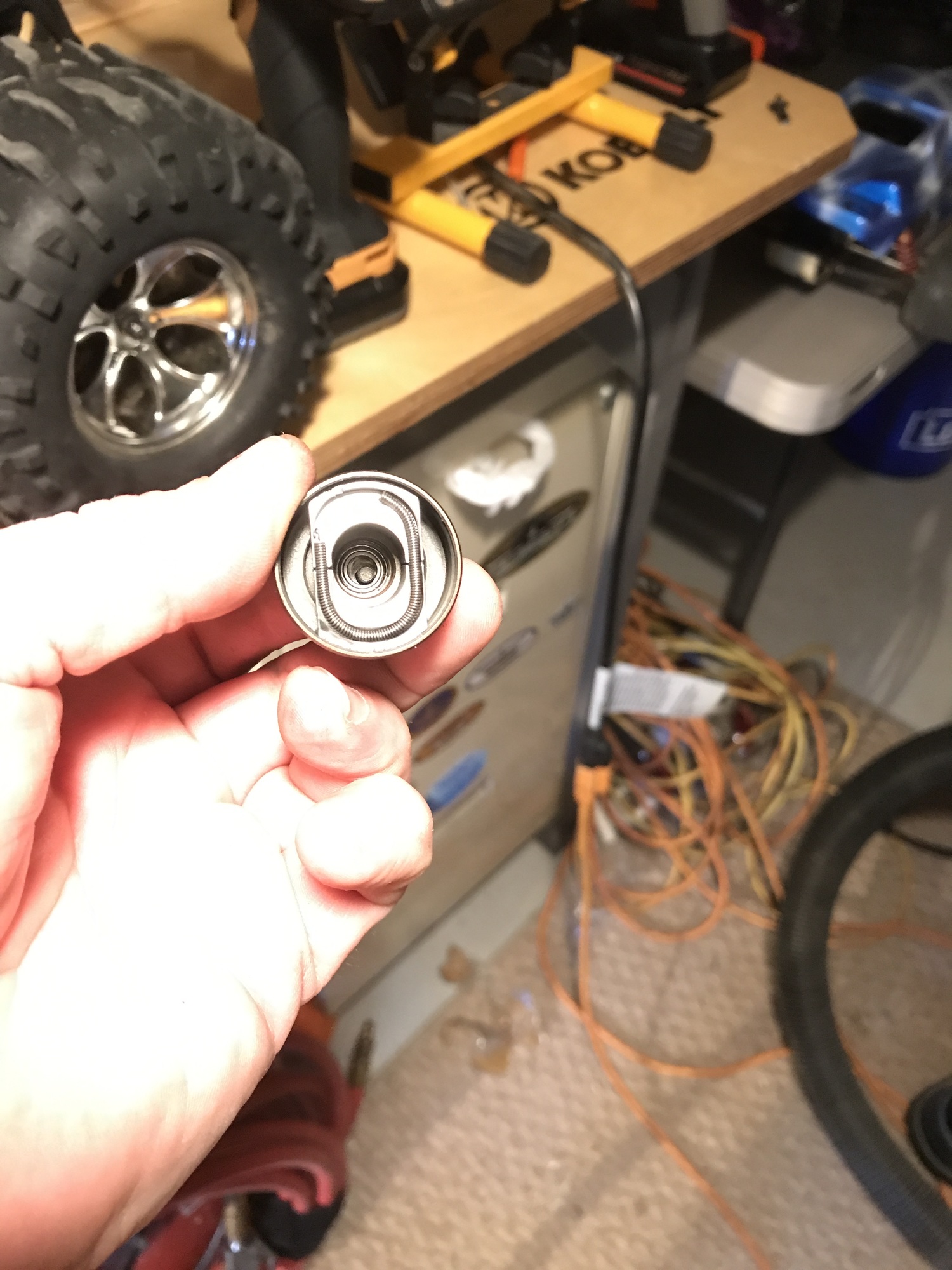

Re: Aftershock clutch issues
You called it spring is broken and clutch shoe looks toasted. Brand new 30 clutch toasted.
How much of the spring is broken? Normally they break at the loop where the two ends come together, quite often you can bend/flatten out another loop from the spring and reconnect it.
It did break right at the loop. I will try to flatten and make another loop. I reinstalled a spare stock set for now. It runs perfect. Now if only I could find a set of clutch shoes for my MGT 8.0 and all my trucks would be up and running. Thanks for the advice. I will try to flatten the spring out and see if I can use it. Parts for the Losi are hard to come by and both the Losi and associated look like new so I keep throwing parts that I can find to keep them running. They are great trucks even compared to modern trucks.
