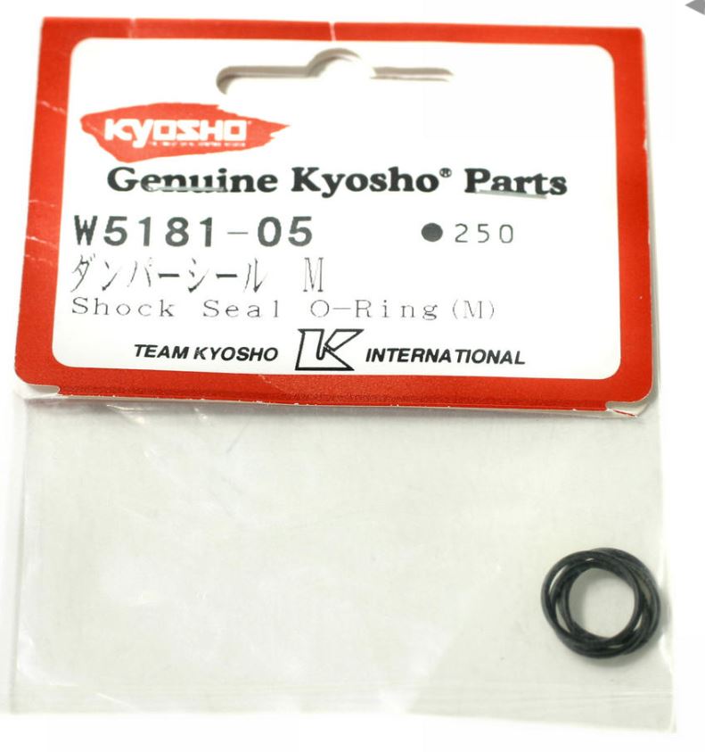

I've used these before as replacement for the top o-rings:
