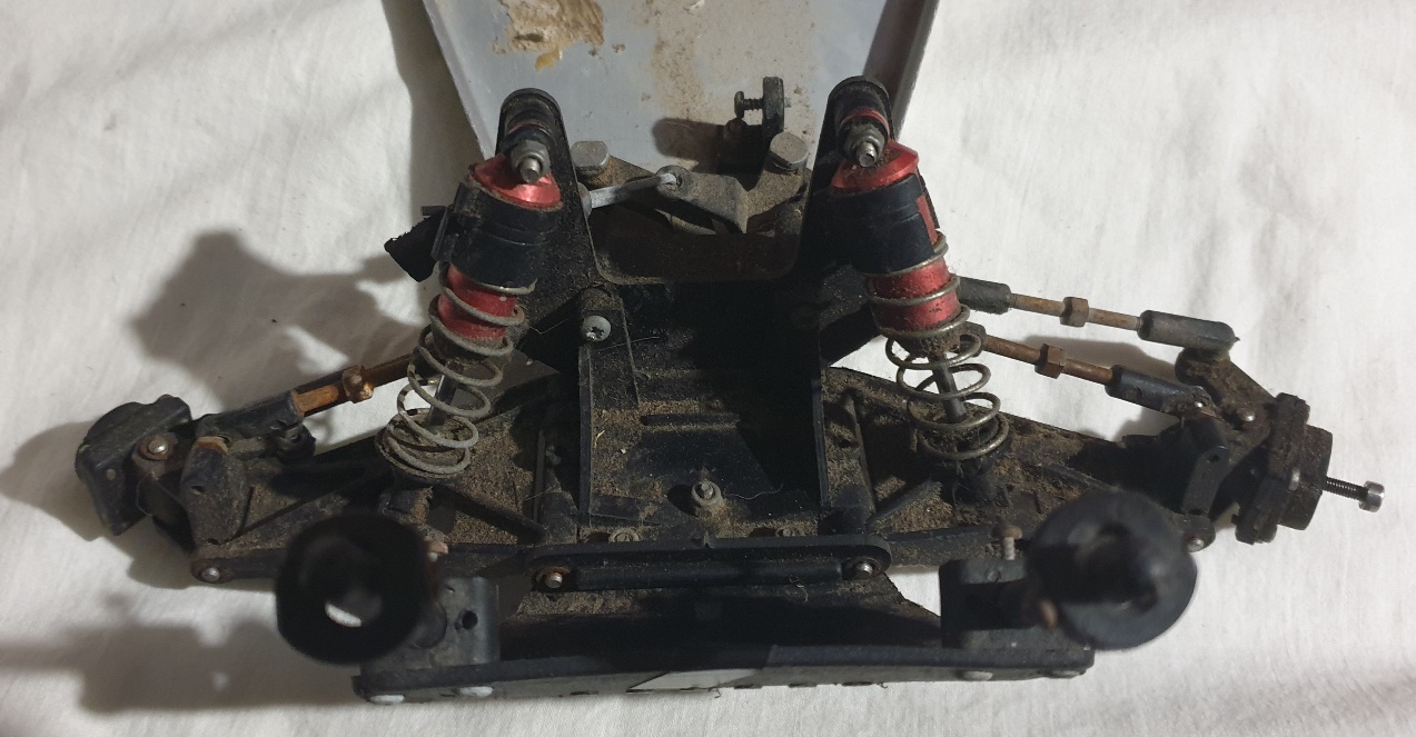

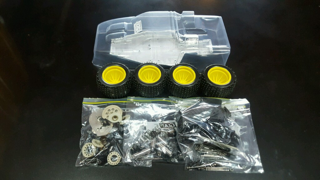

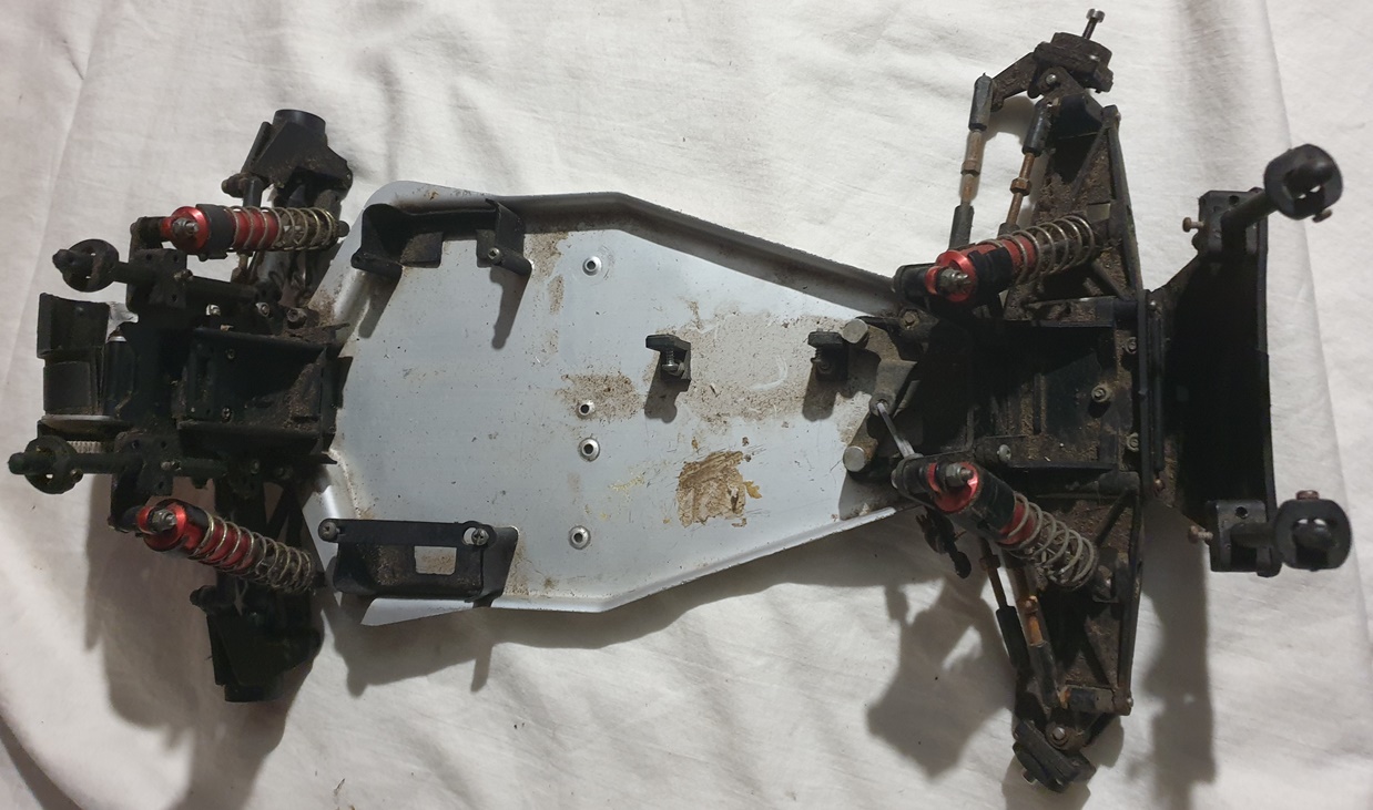

With many thanks to Alex he sent me this, a Schumacher Storm, something completely foreign and unknown. It's going to be a runner so it doesn’t have to be perfect.
I didn't take any before pictures so I'll post his

A few late night rendezvous and this is where I'm up to, just waiting on a few bits like a screw set etc to start putting it all together. So far it has cleaned up quite well and should make for a fairly tidy runner.

Also at a quick look at the parts bags (although without a closer look I cant be 100% sure ) you may have a pro diff already in there, looks like a alloy washer carrier with the diff pulley in th left hand bag. Fingers crossed for ya.

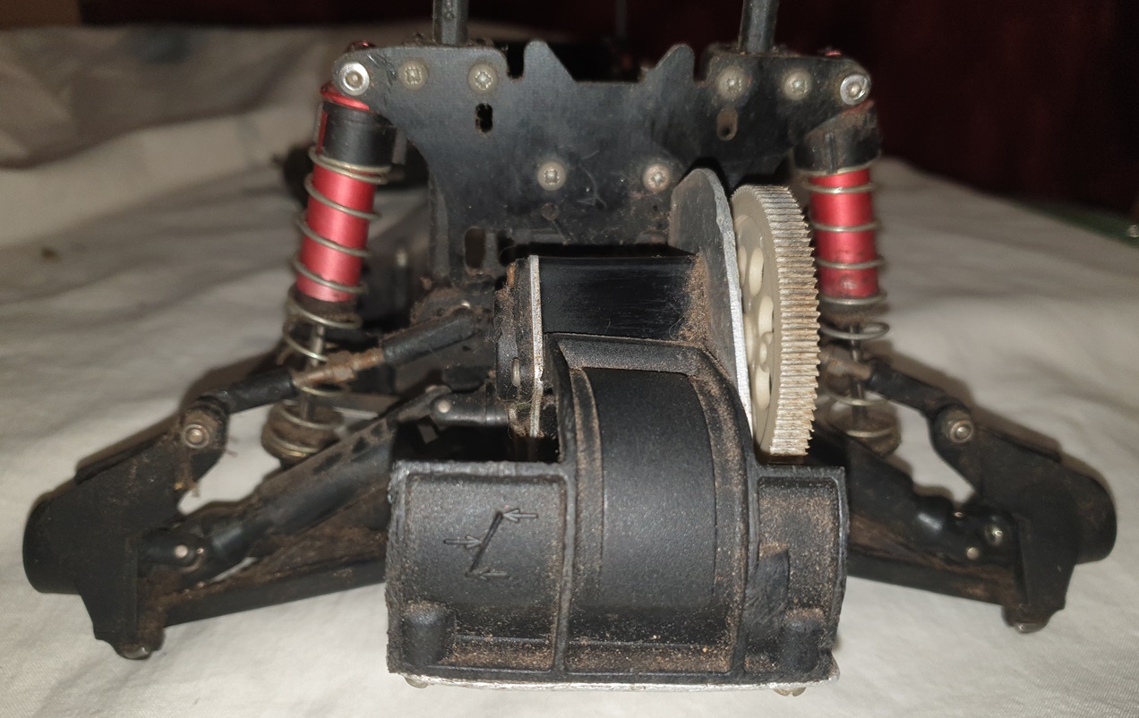

Just something for you to check looking at the third pics from the rear of the truck there maybe a slight twist at the rear of the chassis. ( Pretty common Easy to fix) the giveaway is the motor guard not seating properly into the gear box case. Sometimes it’s as simple as the flat area that the guard sits on has bent on the left side near the fixing point. Somethings it’s the whole area that has been shaped to fit the motor that’s moved- nothing a little bit of panel beating can’t fix

Yeah, he was aware of that... probably already been fixed, better than new.Retro rc wrote: ↑Mon Jul 13, 2020 9:39 pm Just something for you to check looking at the third pics from the rear of the truck there maybe a slight twist at the rear of the chassis. ( Pretty common Easy to fix) the giveaway is the motor guard not seating properly into the gear box case. Sometimes it’s as simple as the flat area that the guard sits on has bent on the left side near the fixing point. Somethings it’s the whole area that has been shaped to fit the motor that’s moved- nothing a little bit of panel beating can’t fix
