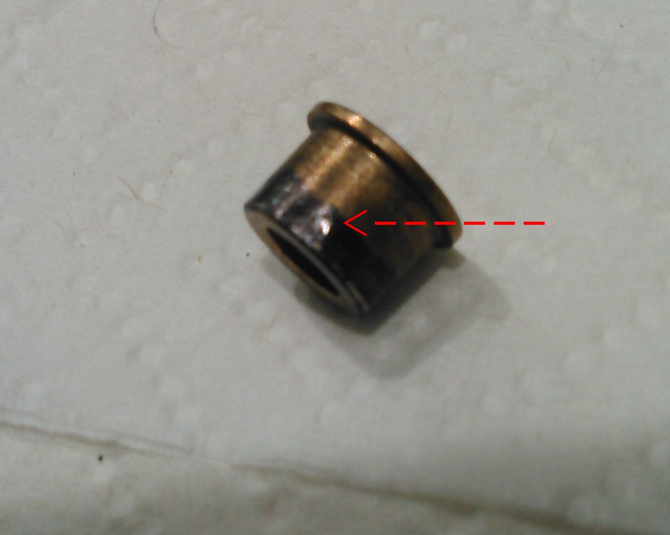

Hey All,
I spent a lot of time replacing bushings for bearings in a 6 gear.
On one of the out drives, its motion springs back in the other direction when moving it slowly. I tried 2 sets of bearings, with the same outcome. The out drive is clean as a whistle. The other out drive spins freely with each set of bearings in the problem one. One of the out drives is "friction-free"
Should I source a new out drive or put it back together as is?
Thanks!
Thanks!

I was able to resolve this with the help of the old bushing and Dremel tool. With a Sharpie, I drew a black line all the way around the bushing and inserted it into the outdrive. I was able to see where it was binding the bearing. Visually, I could not see it. It was only the non-flanged bearing that was the problem.
Using one of those green, rubber-like polishing bits, I was able to hone the outdrive out. I did it little by little, and it got better each time. It's perfect now.
I'm glad I checked the movement of the bearings. This transmission would have been awful!
