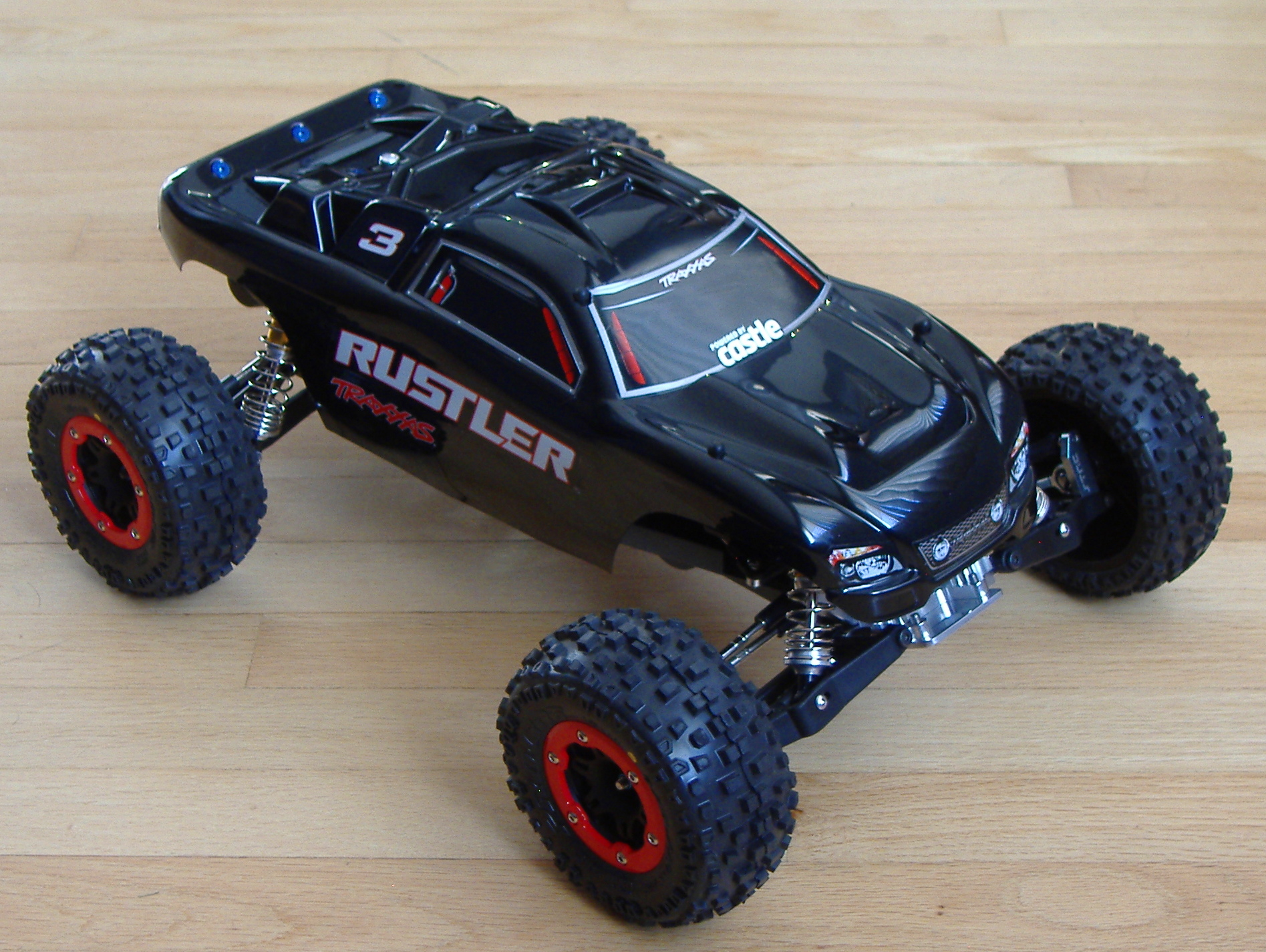

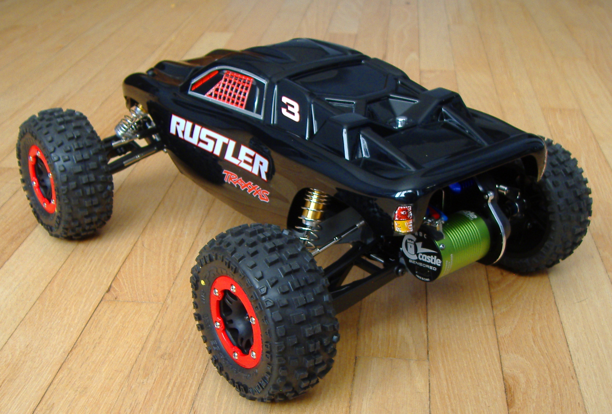

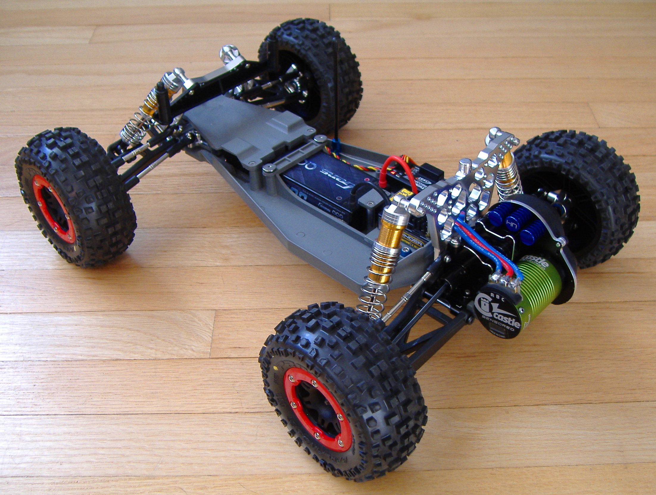

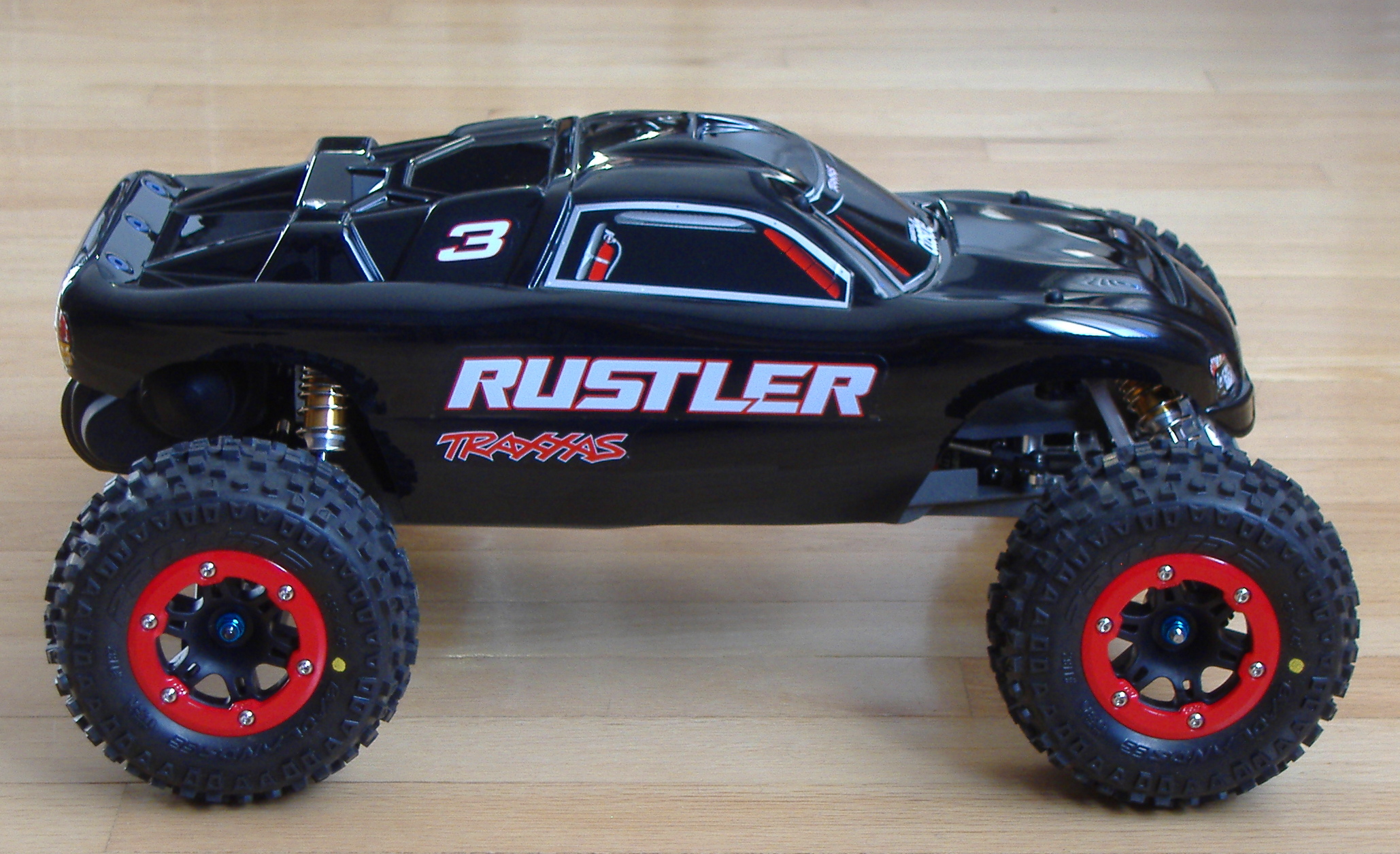

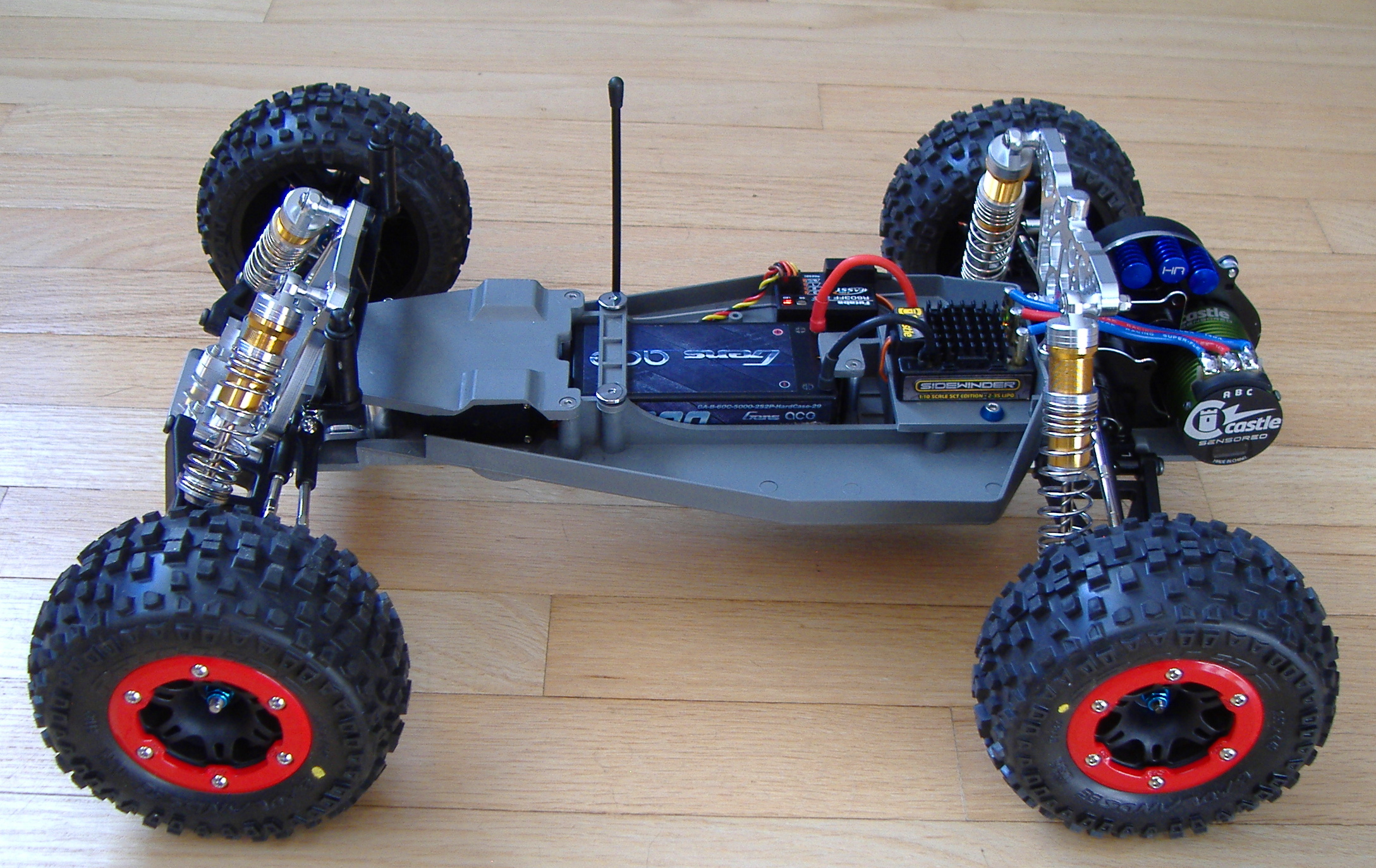

Got bored last year, built another Rustler.
Only thing Traxxas is chassis, links, gears, body & mounts.
Made battery mount to run a shorty pack, mounted the esc behind the battery.
Made the esc tray and battery mount out of an old chassis so the plastic would match.

Only have a couple snow runs on the full aluminum version, ran the graphite version during the summer.
Has good machining and good fit and finish.
Graphite version holds bearings a bit tighter, 32 grams lighter and a bit quieter, and has anti-squat built in to the mounts.
