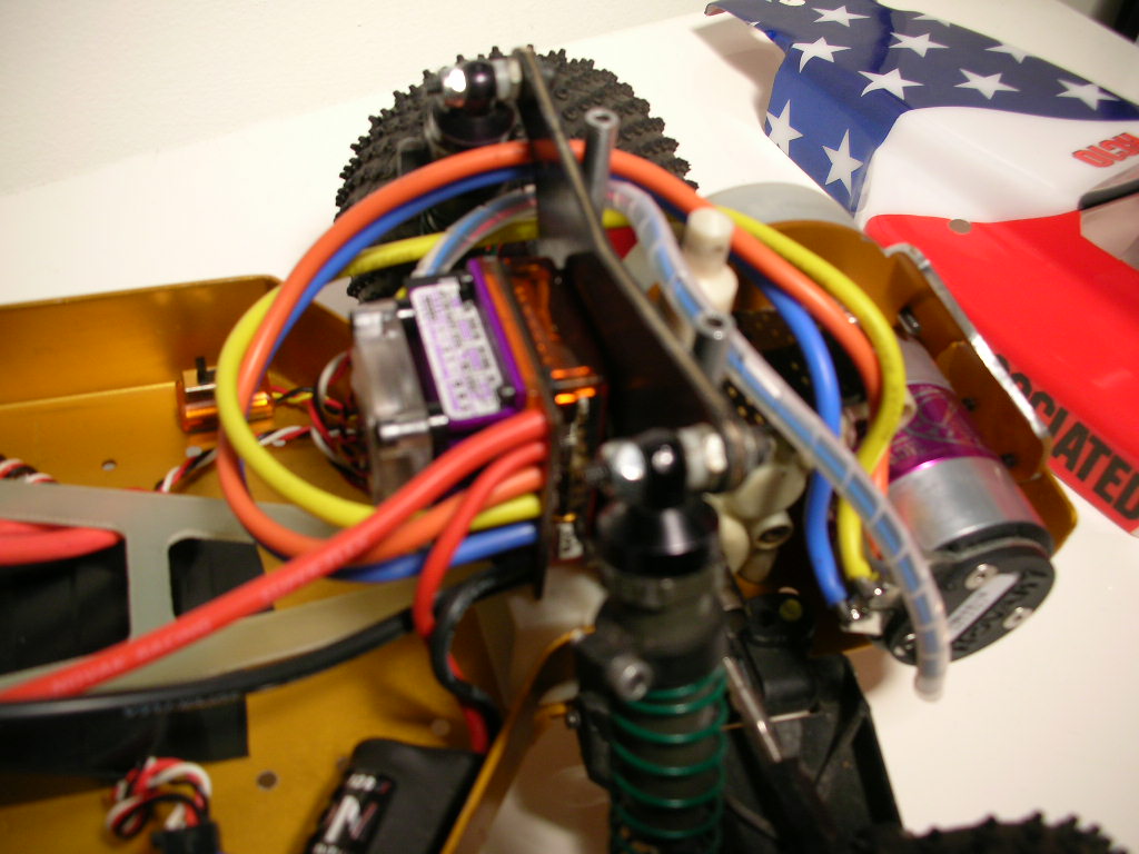

I decided to sell my T4, because I really don't use it very often. But, I couldn't get rid of the Novak brushless system I had in it. I love brushless. So, what to do with it? Well, the only single motor runner RC I own is my beloved gold tub hopped up Stealth. So, it seemed like the obvious thing to do. Now I just have to figure out proper gearing for this massive power plant. :twisted:

It's the Novak Velociti 5.5, which means it's a 5 1/2 turn motor. I don't know what the equivelent brushed motor would be. It may be a 5.5 turn brushed motor, this thing is insanely powerful.

a brushless 5.5 is more or less a 10 Turns :!:

Yeah, that novak 5.5 is a really hot motor and equal to a 9 or 10 turn brushed motor. With the crazy batteries we have today, you're better off running lower gear ratios. For the RC10T, you probably want to run 15/87 and for the rc10 16/81 or 17/84.

84/23-24 might be a little high. try an 84/19-20. give that a shot. the gearing will really depend of what your gonna do with the car.

I run 21/81 on a 6.5 in a sprint car on dirt oval (buggy tire). A 5.5 is crazy in a 2wd buggy for offroad, most seem to run 7.5 or 8.5. Either way a 19 or 20 with an 84 would be a better start.
