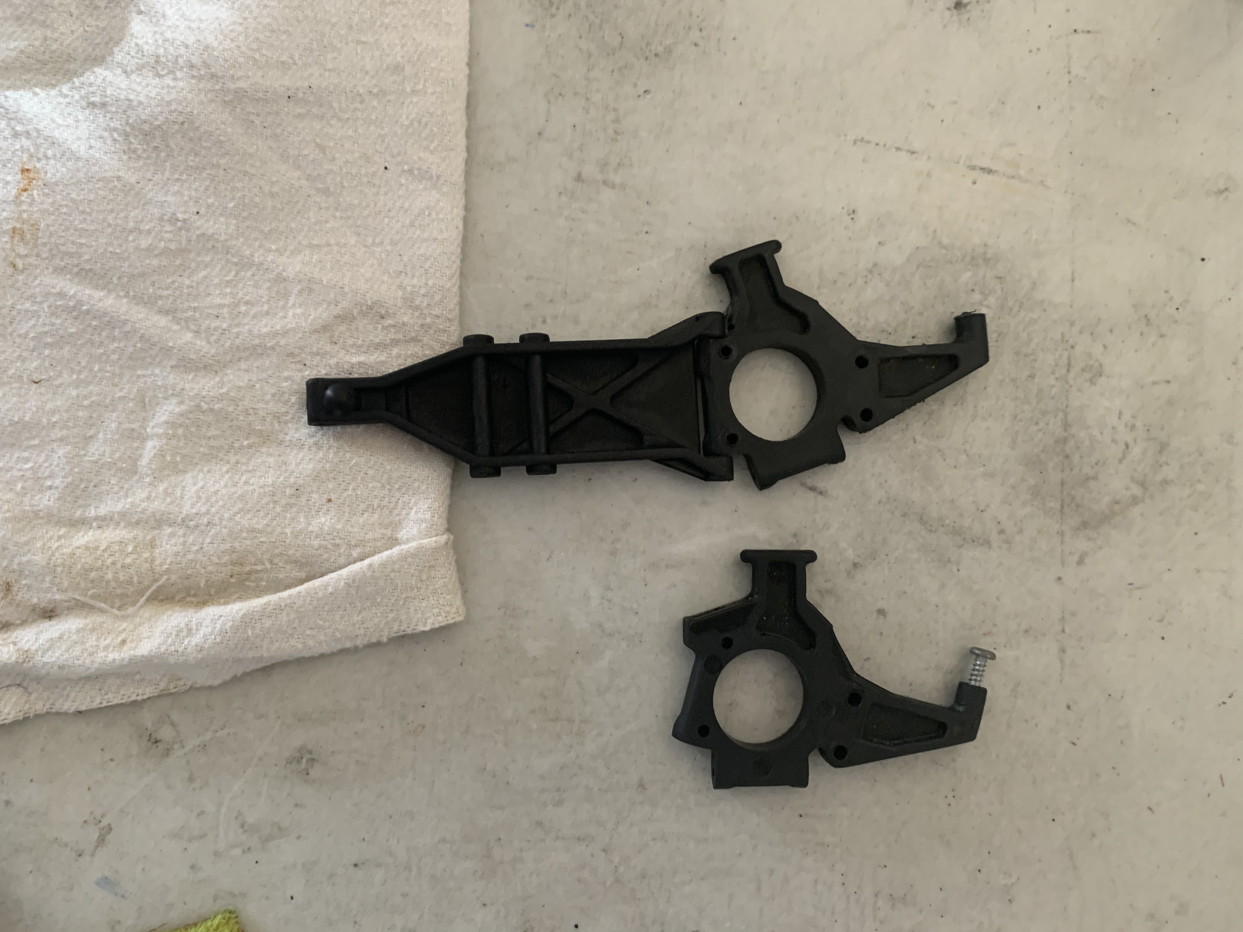

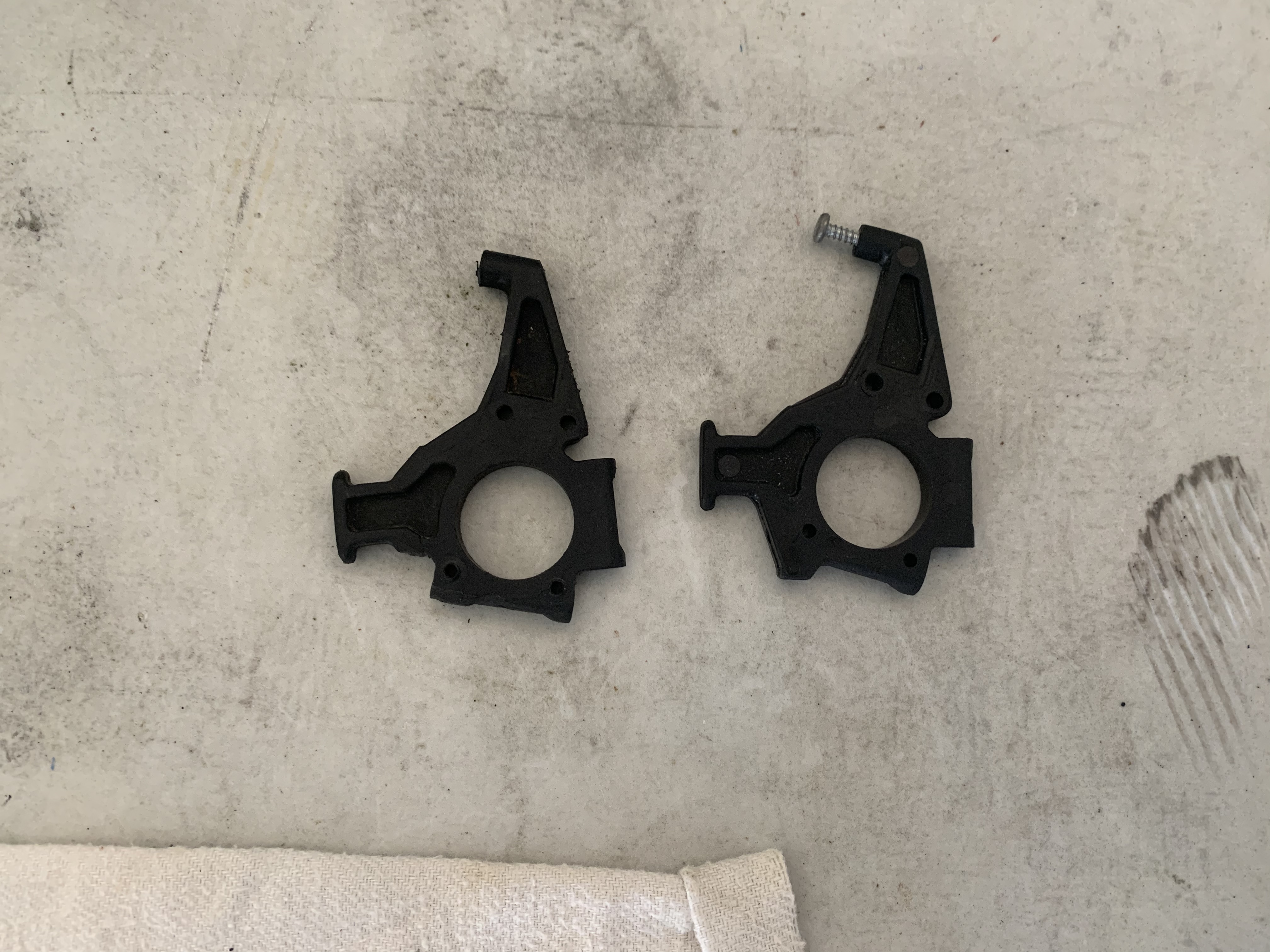

Bit of dremel work to the rescue,
The upright on the left is the modded 1
The hinge pin hole is existing so that made things a bit easier.

Yep, basically convert front shock towers back to XL spec by removing web under crashback lug.

Danf1275 wrote: Thu Feb 02, 2023 6:13 pm Yep, basically convert front shock towers back to XL spec by removing web under crashback lug.
Yep that’s exactly what I did👍🏼
