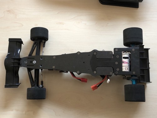

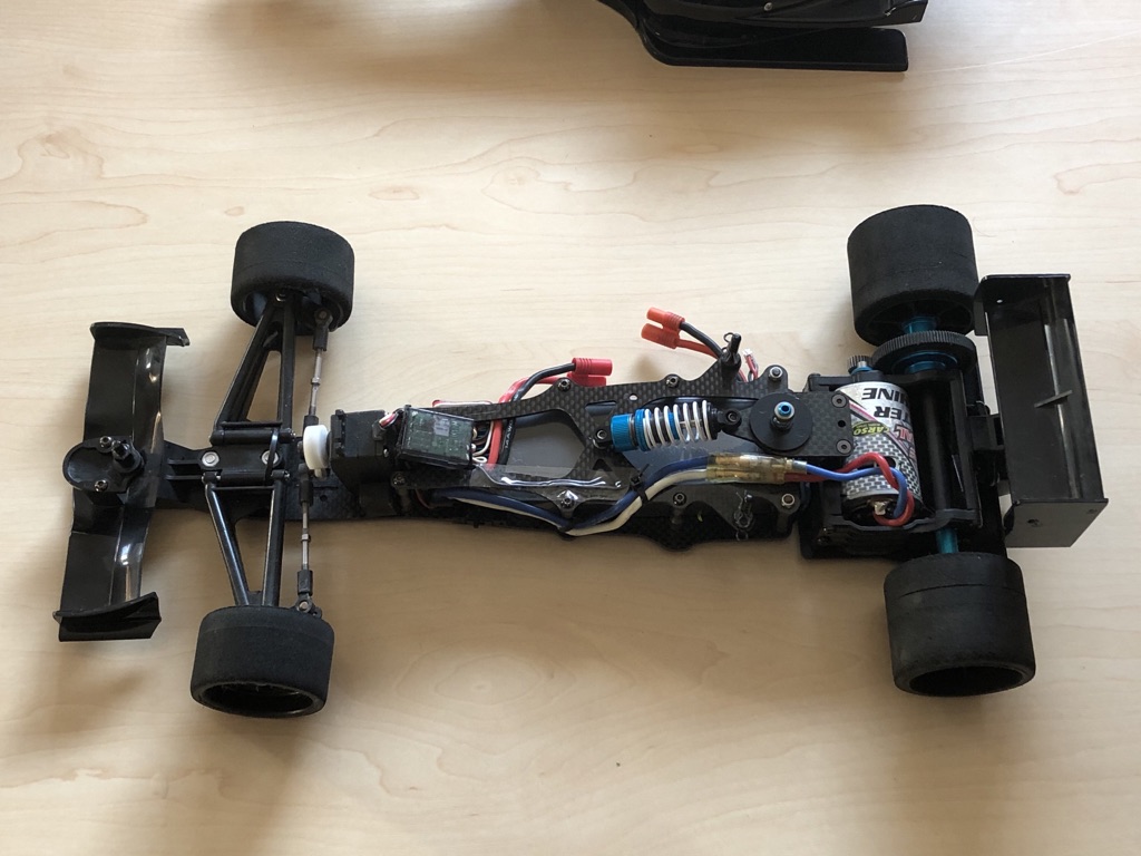

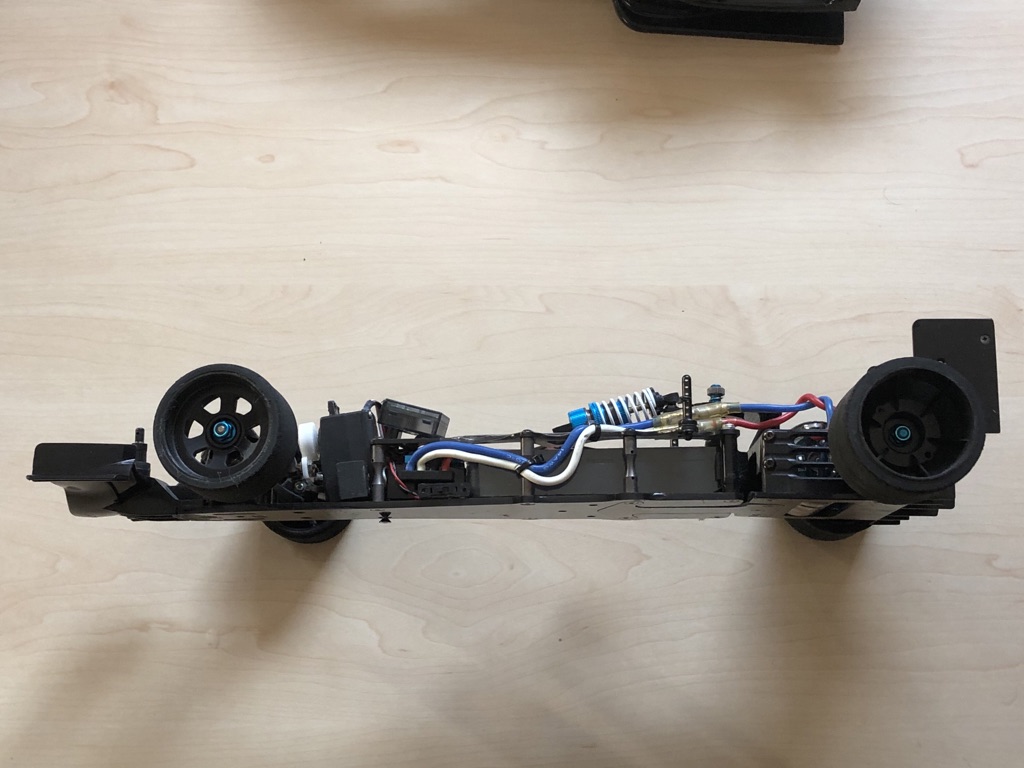

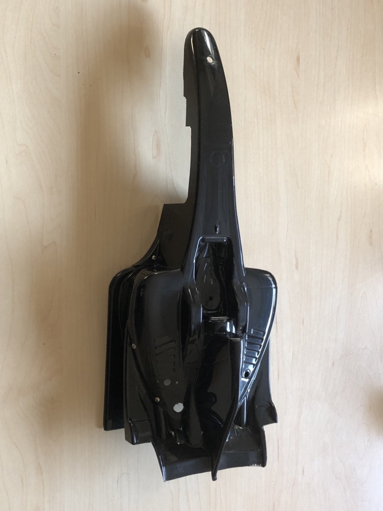

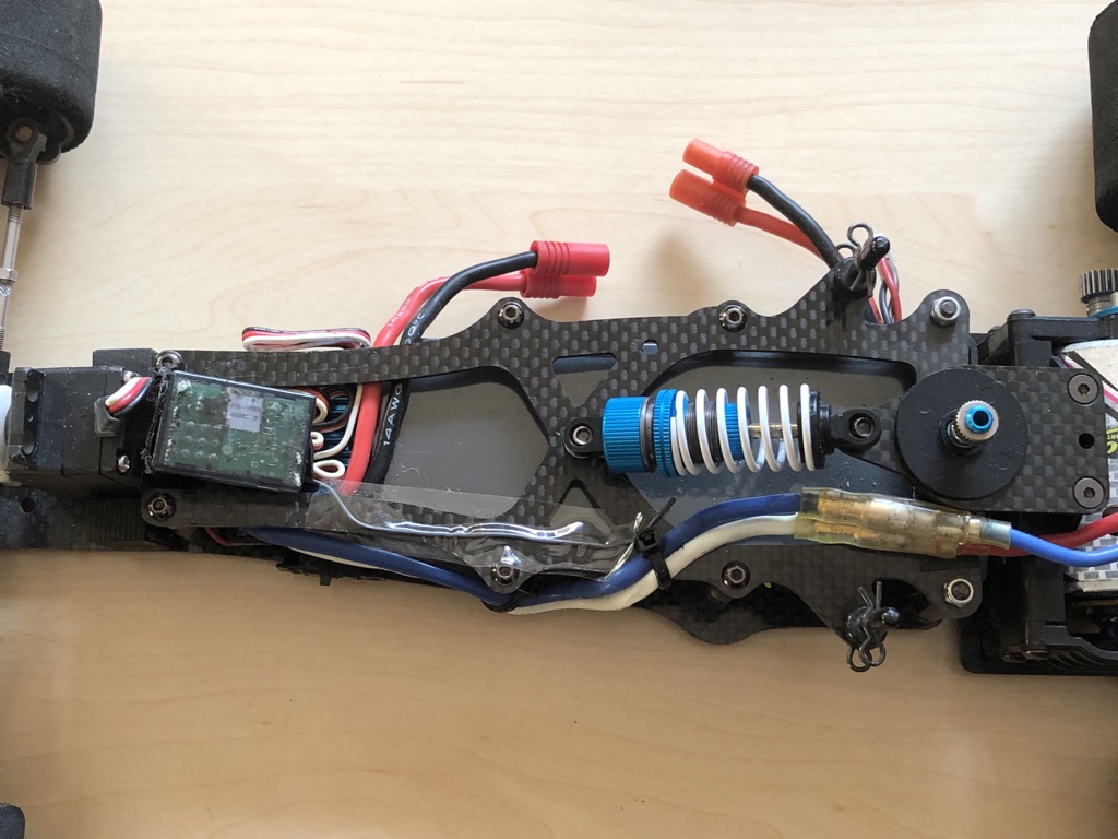

Some pictures for my F103 now.
Which basic version is it and what´s the conversion kit?
And what type is the body?

Indeed it´s a F104W. Just got the information.
But it´s not the basic version.
The F104W is the only F104 car which got the F103 front end, because it´s more wide.
But beside the front end it´s more like the F104 Pro.
Because all of the option parts are used as the graphite chassis and top deck, graphite damper plate, TRF center shock, graphite rear axle, blue aluminium ball diff parts etc.
The body also is "borrowed" from the F104 Pro.
Wheels are unknown
Wheels are unknown

I believe the front ends were interchangeable between the F103 and F104 so you may have a Pro chassis with a swapped front end.

I´m not an expert at all for the Tamiya Formula cars.
But I got the message it looks like a F104W which it does. Beside all of the option parts.
The seller also told me he exchanged many of the parts for graphite. So it looks like this way.
But the car has just very little signs of use, because it was just run for one race at carpet.
Actually it is race ready as everything is here including a Lipo.
