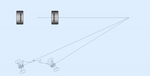

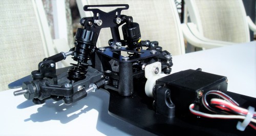

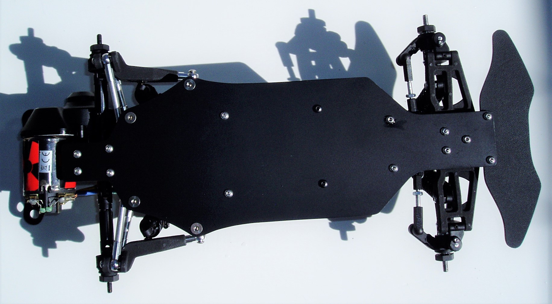

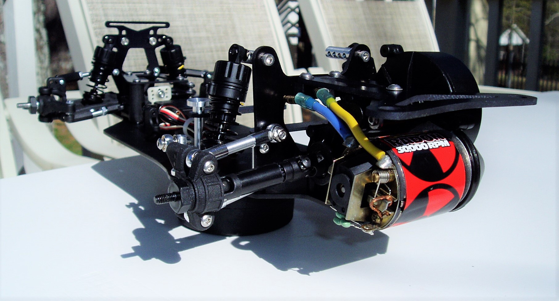

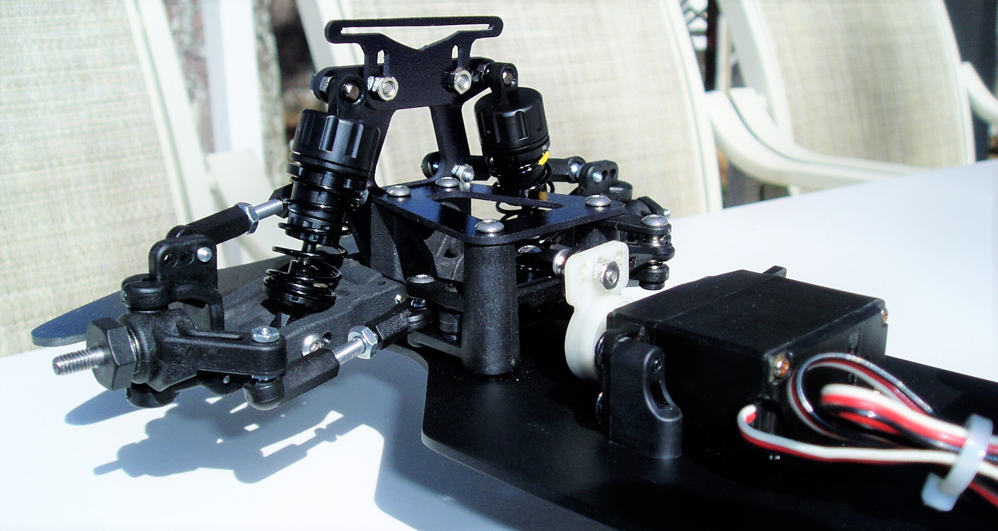

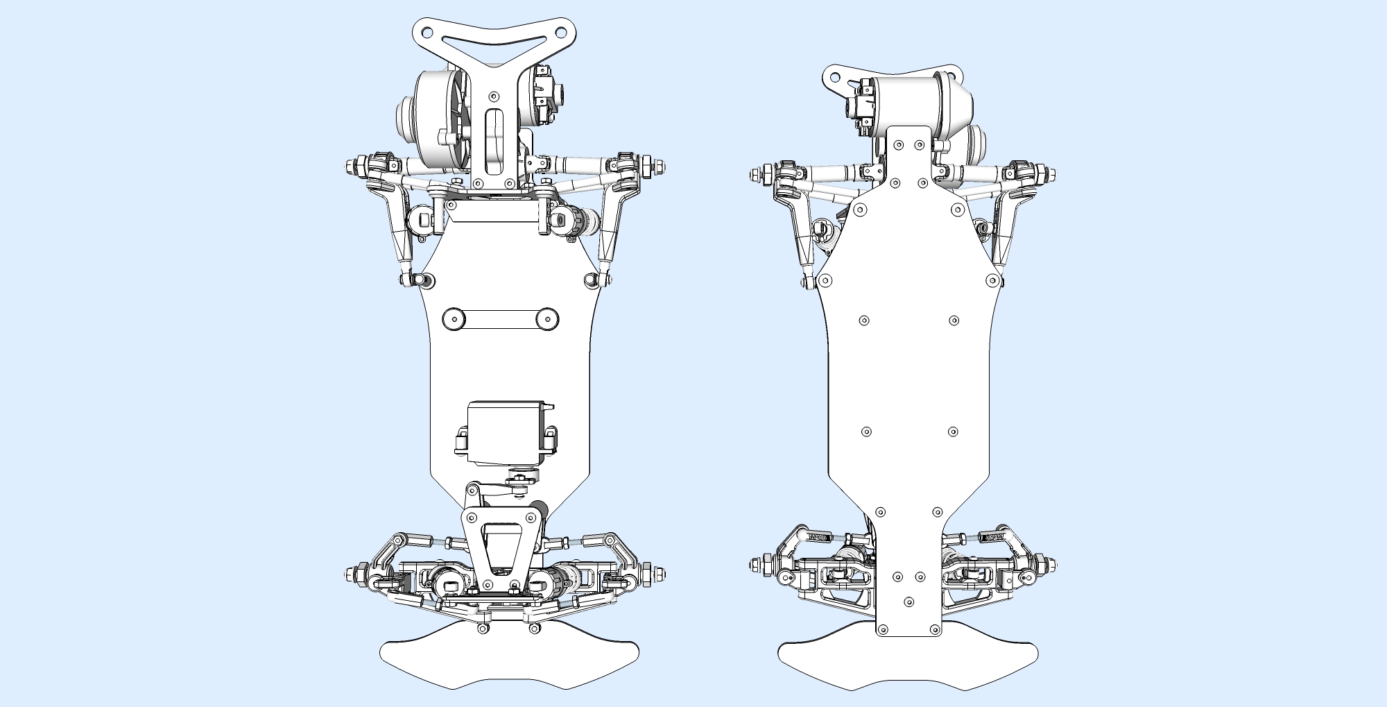

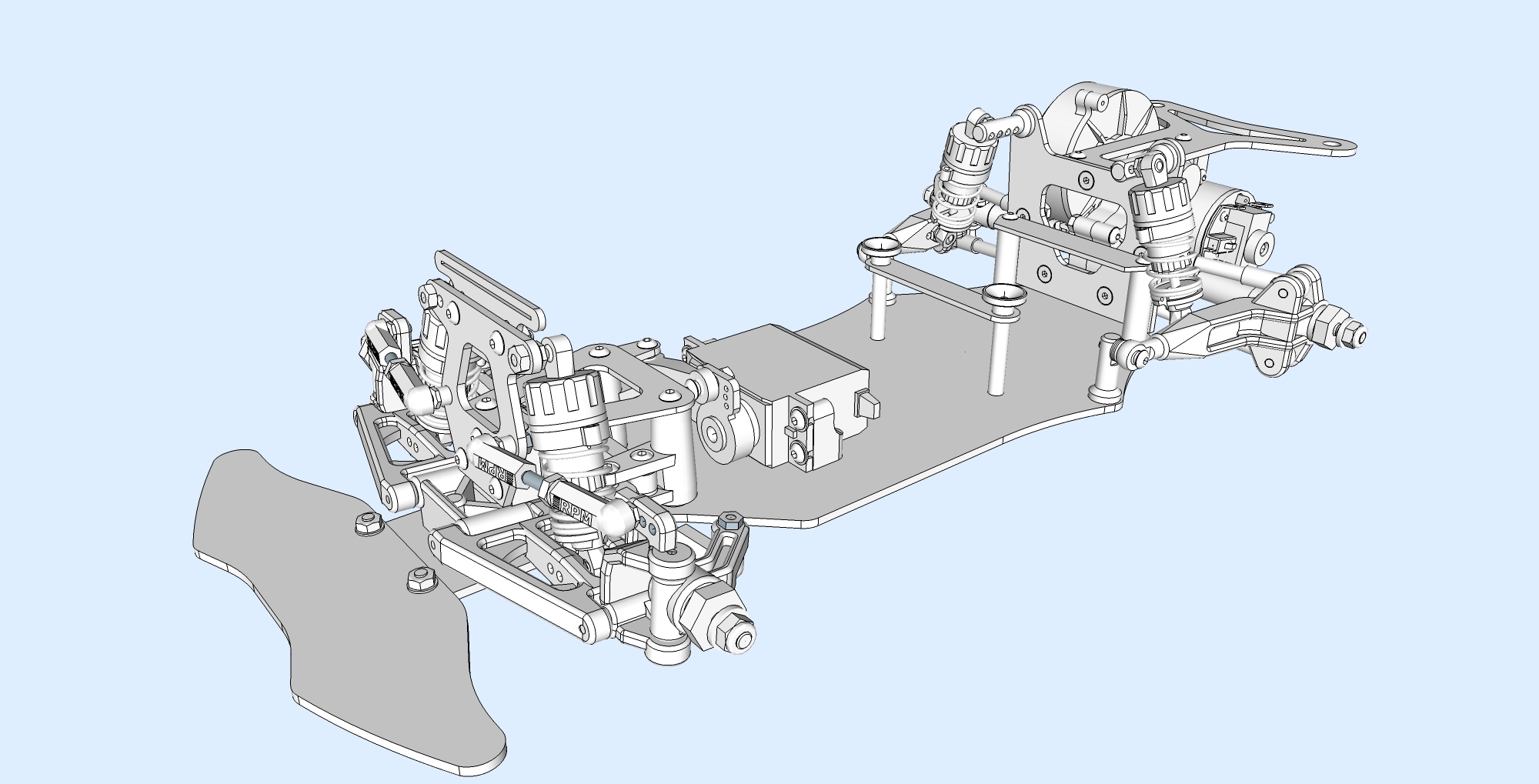

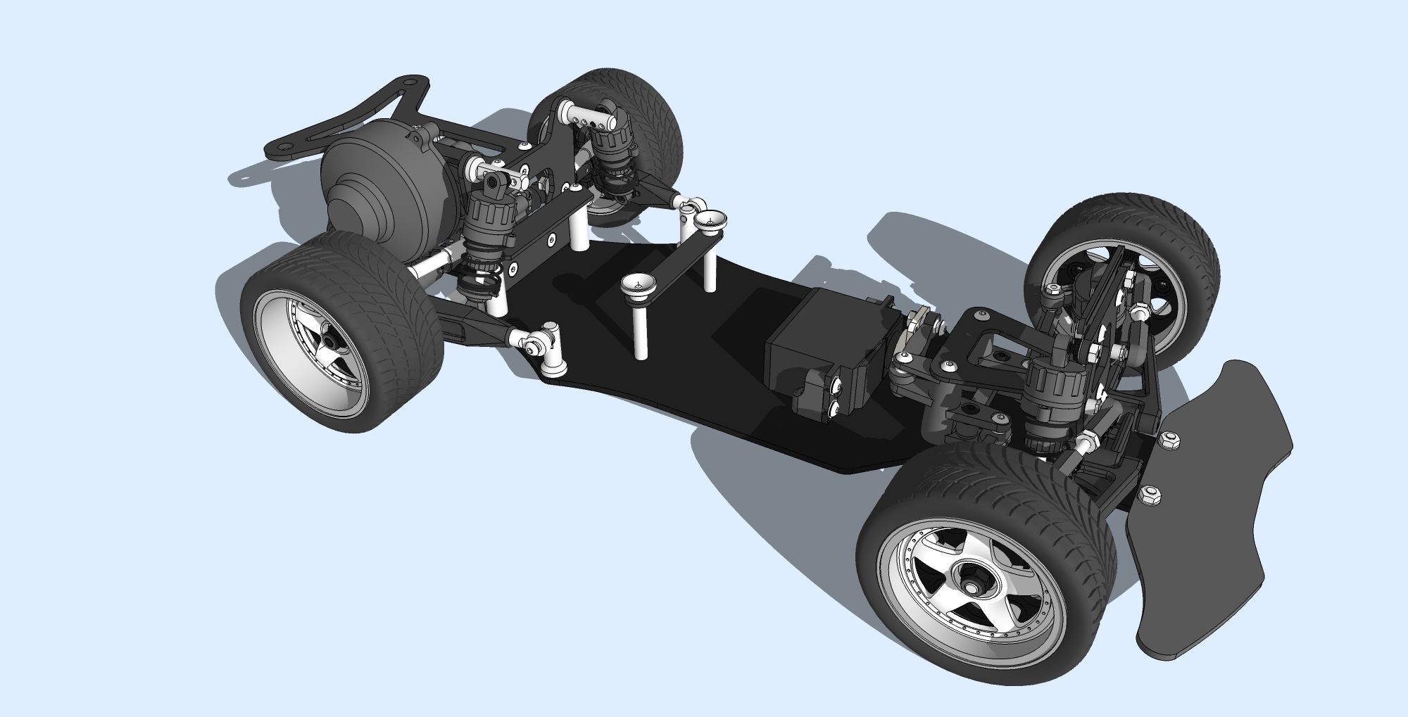

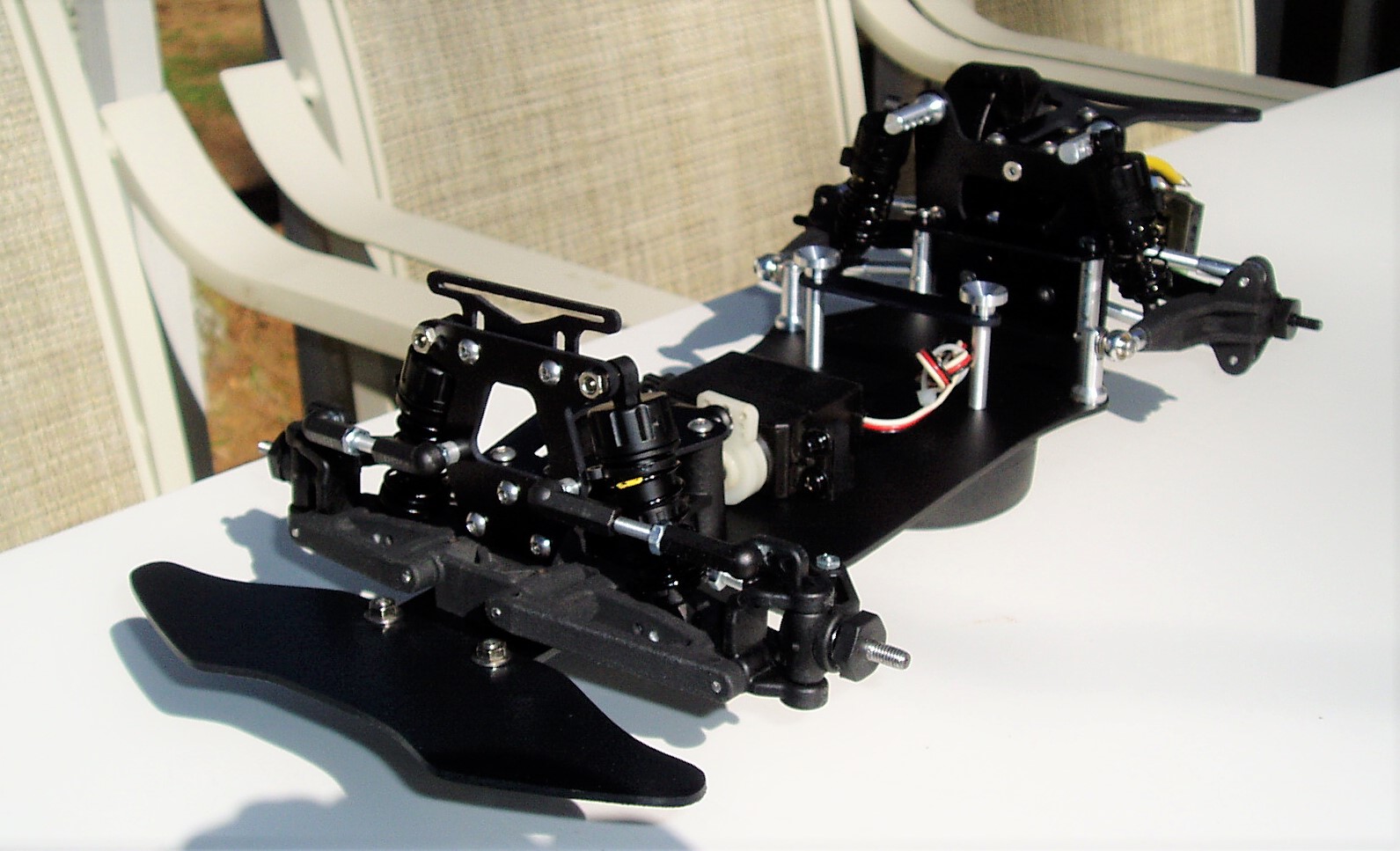

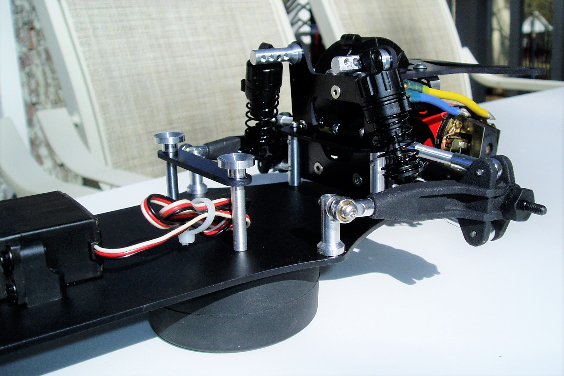

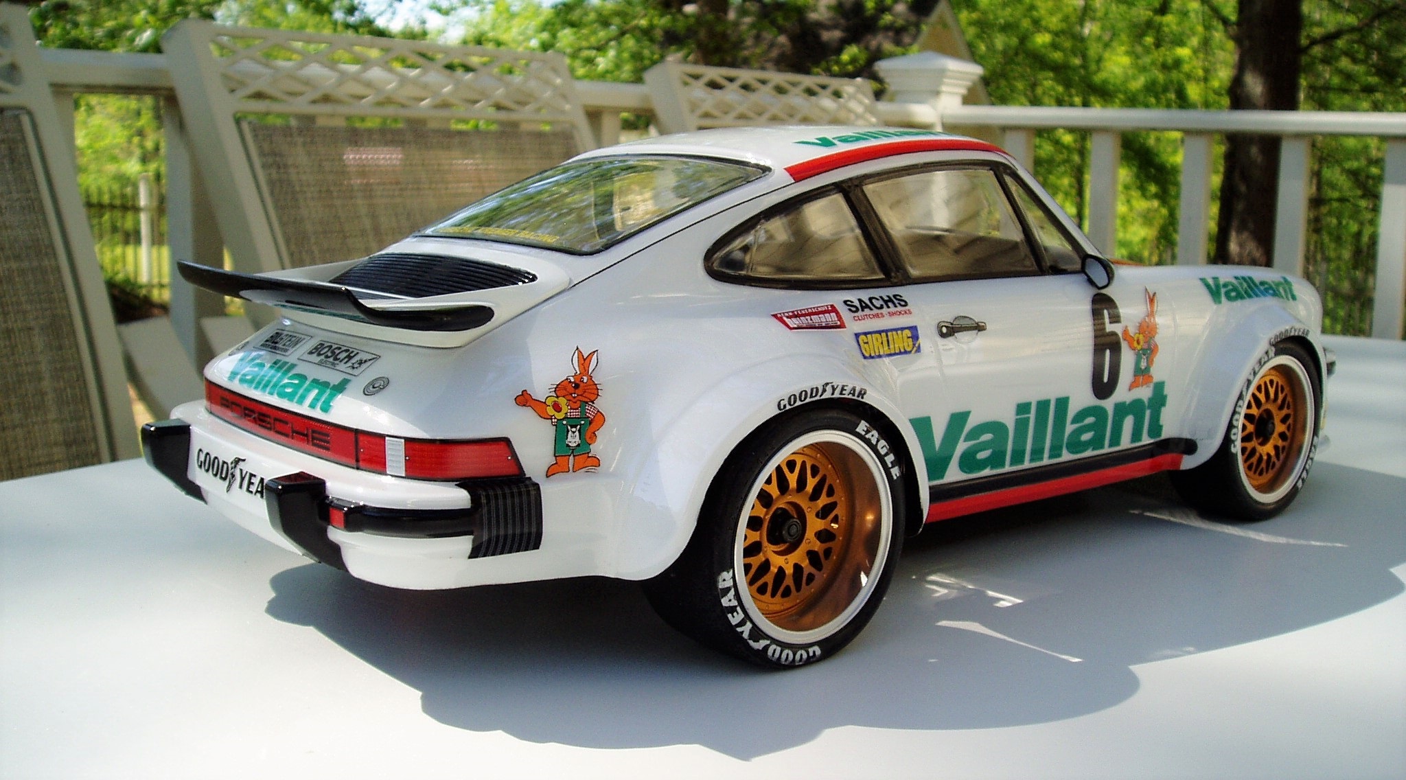

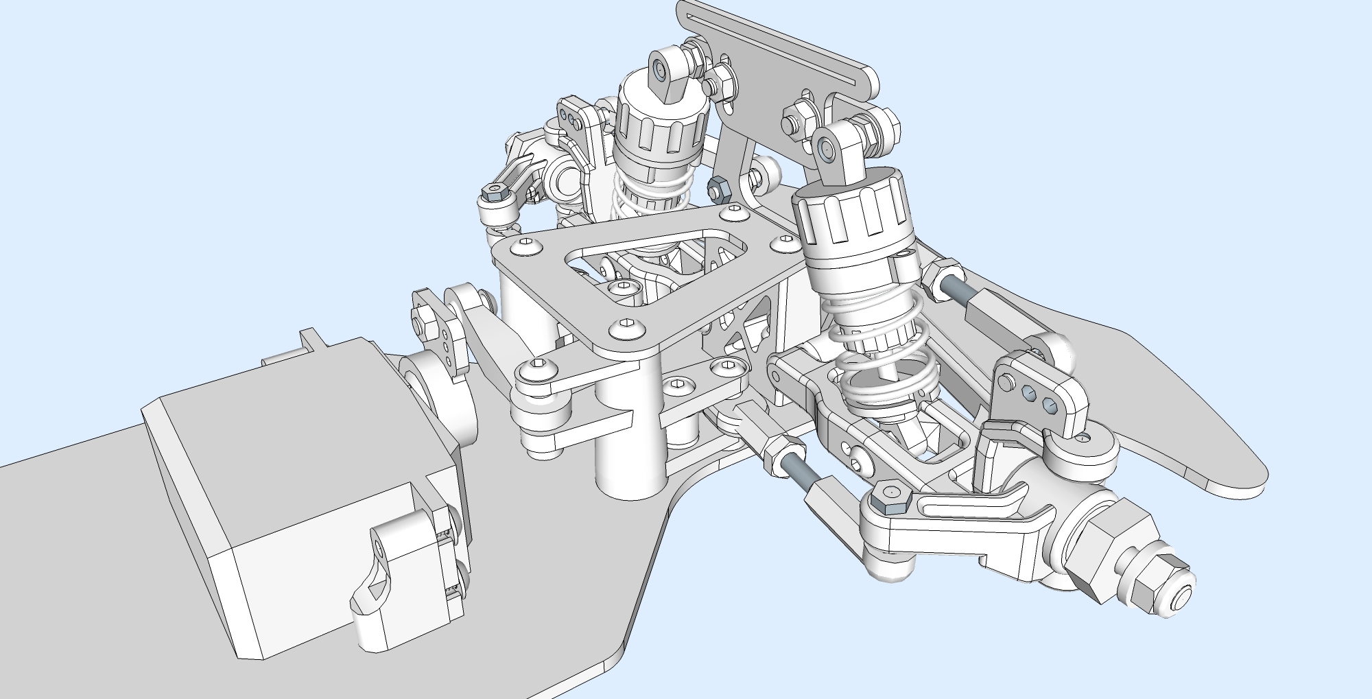

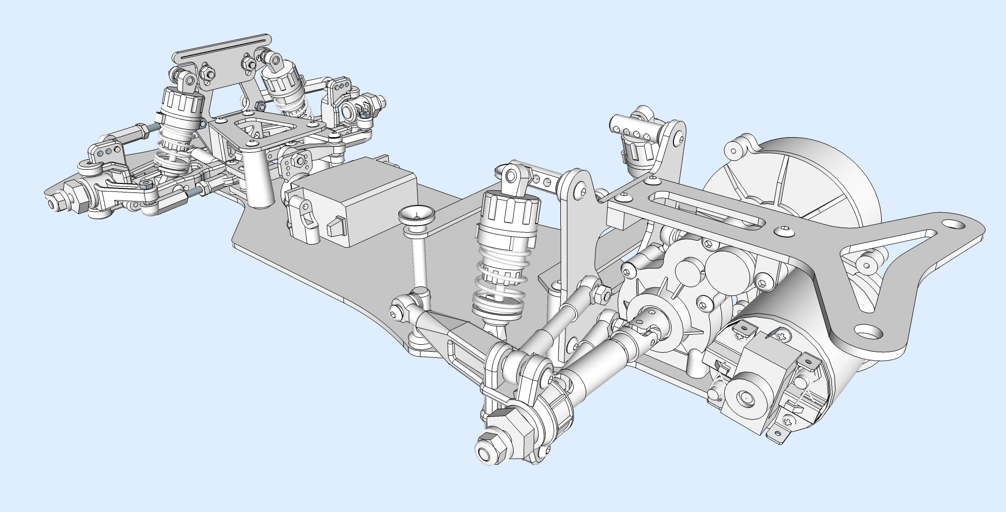

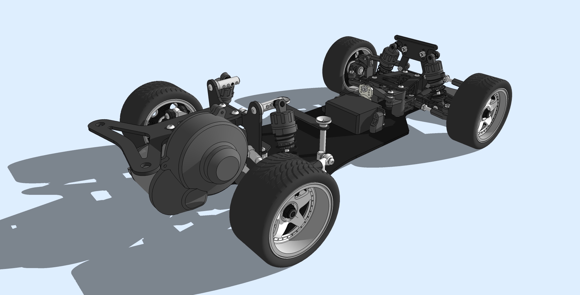

Step 1: Chassis Design.

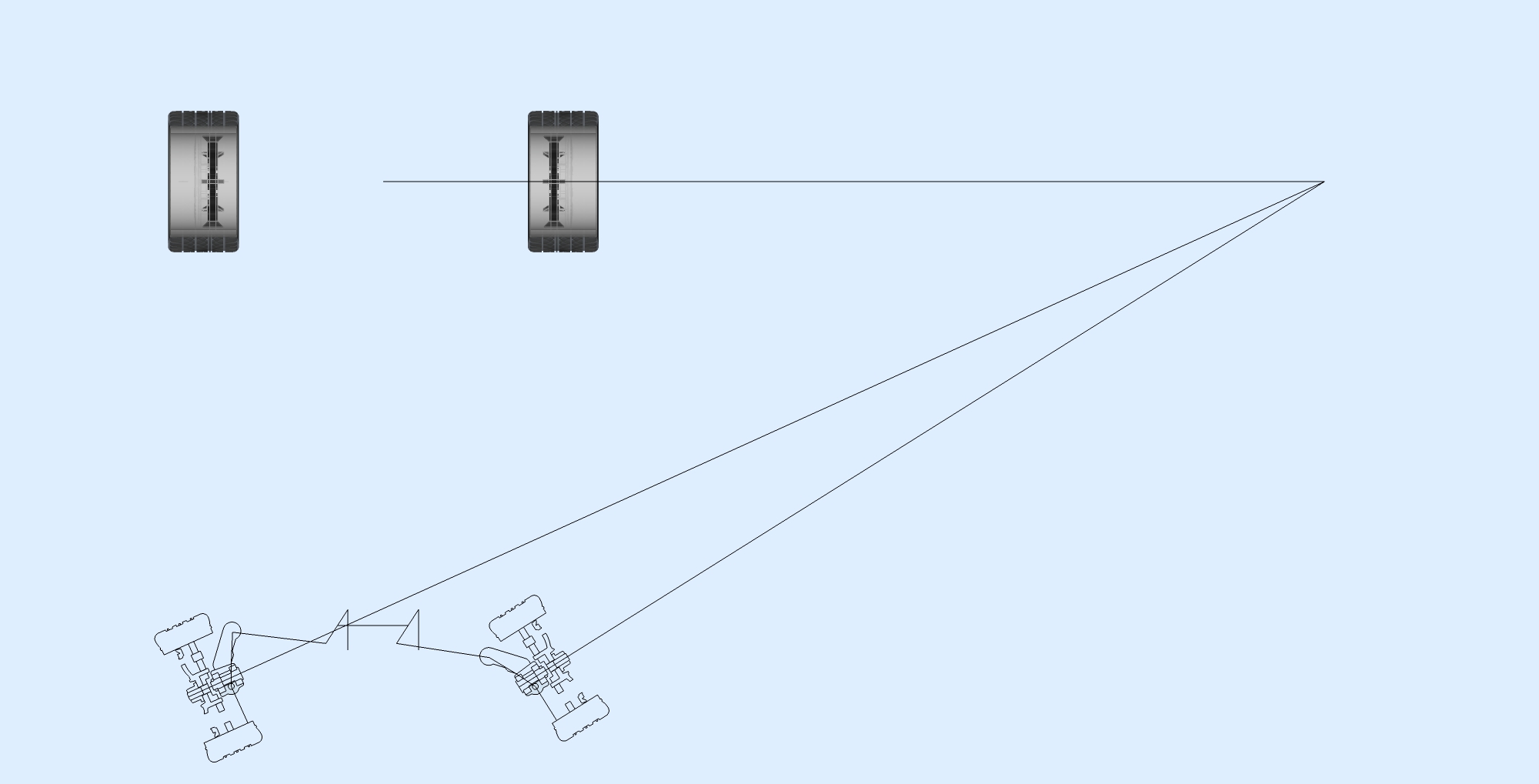

Step 2: Chassis Components.

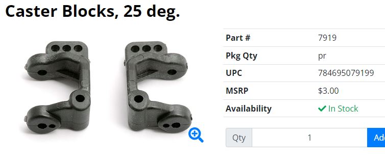

AE Caster Blocks
AE Steering Blocks

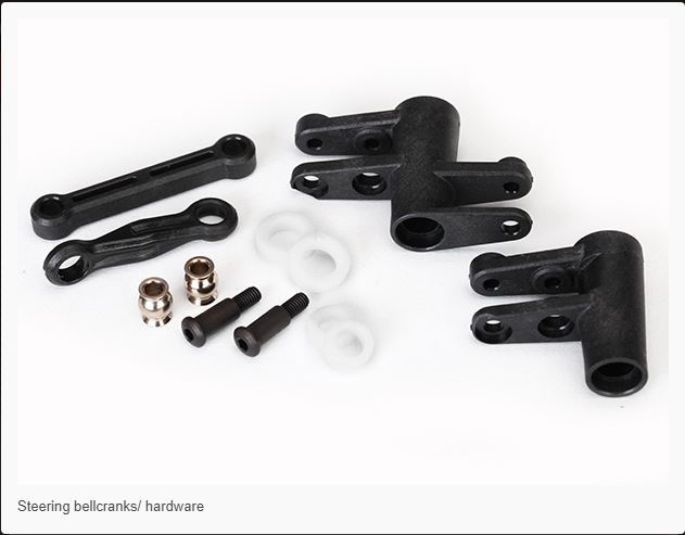

Traxxas 4-Tec Steering Rack assembly

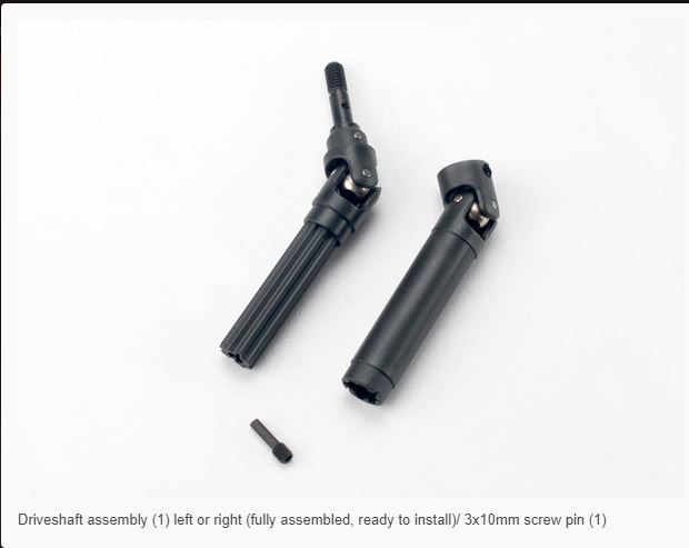

Traxxas E-Revo 1/16 Drive Shafts

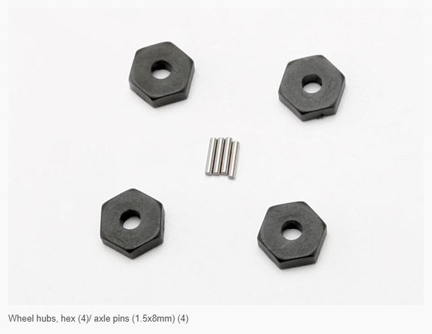

E-Revo 1/16 Drive Hexes

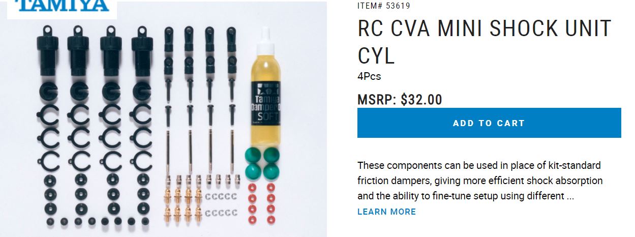

Tamiya CVA Mini Shocks

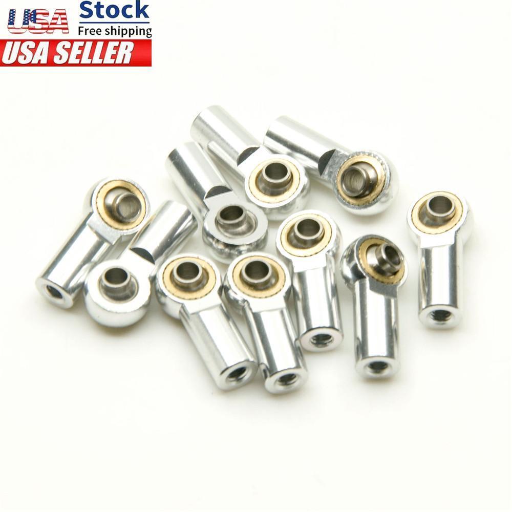

Metal Rod Ends (ebay)

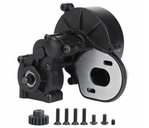

Austar 3-Gear transmission

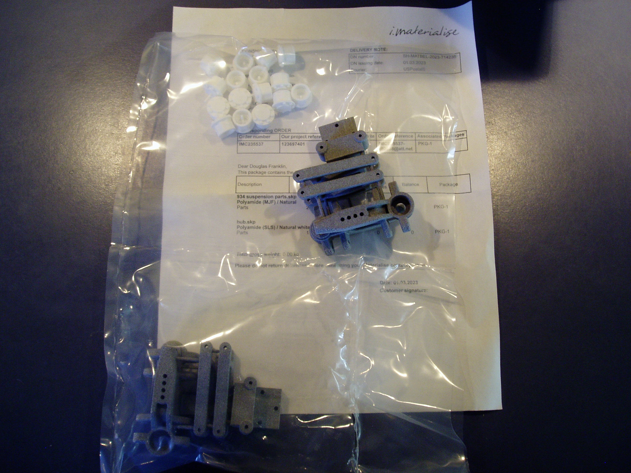

Printed Parts (front bulkhead, front and rear arms)

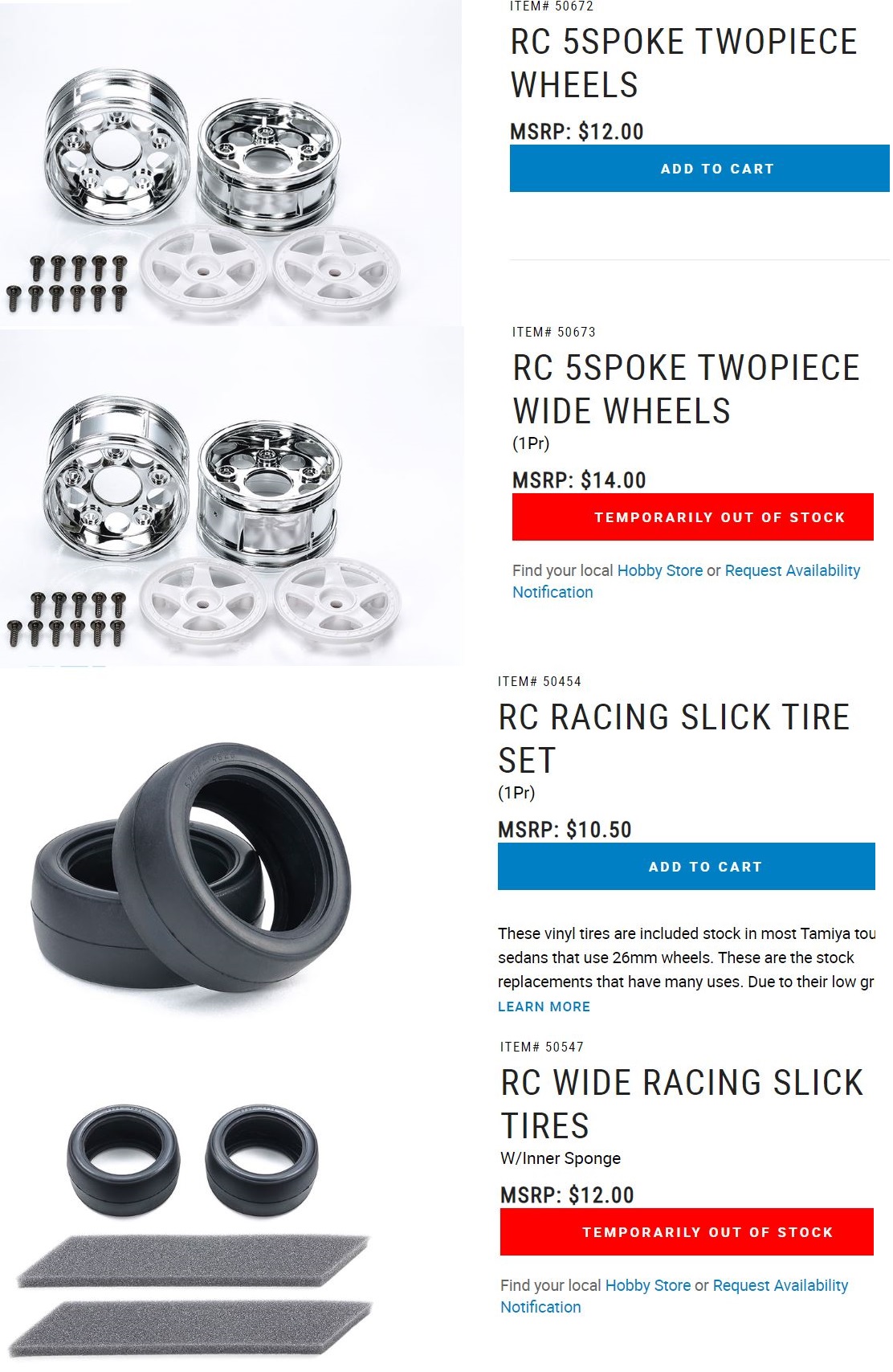

Tamiya Wheels and Tires
BBS mesh wheels from ebay seller (for display)

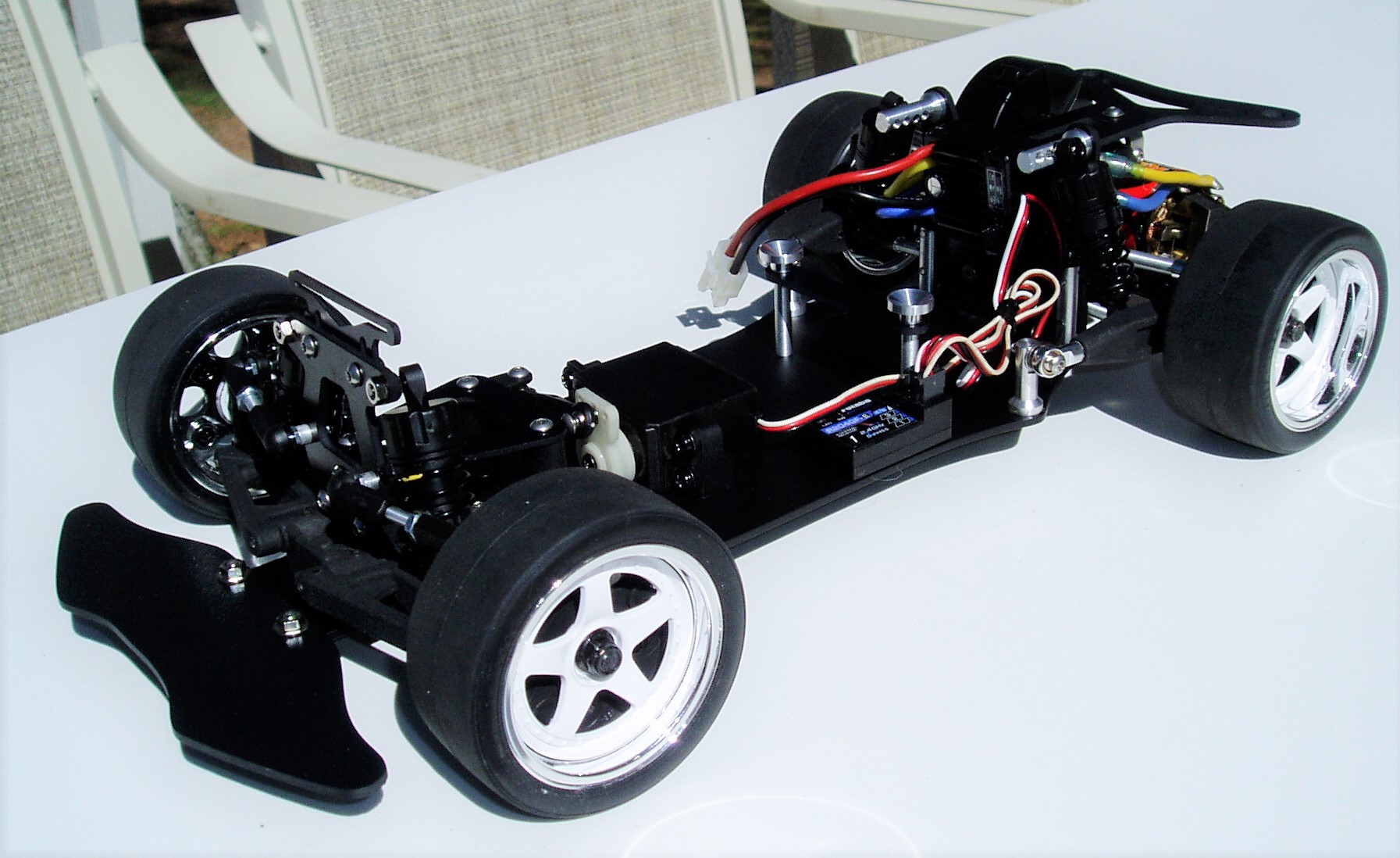

Step 3: Chassis Fabrication and Assembly.

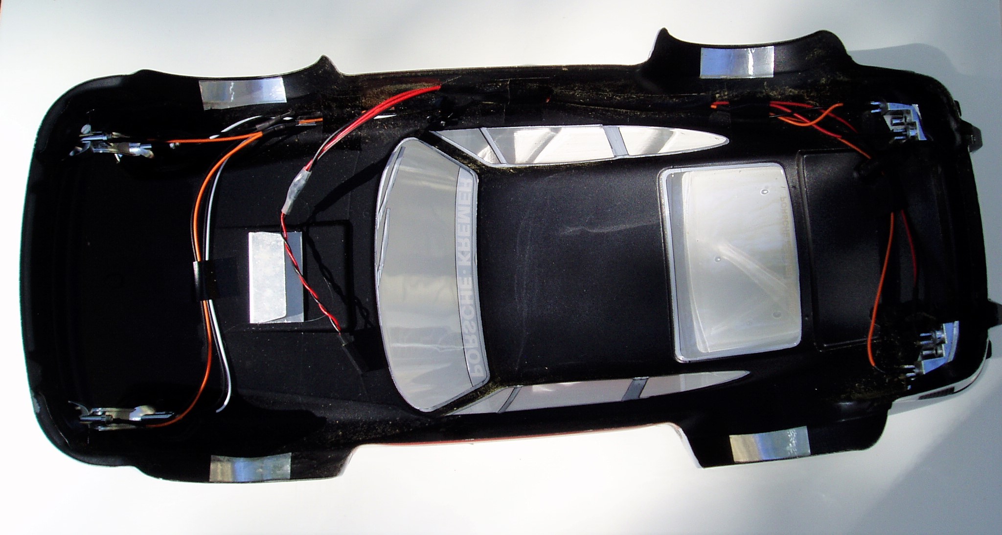

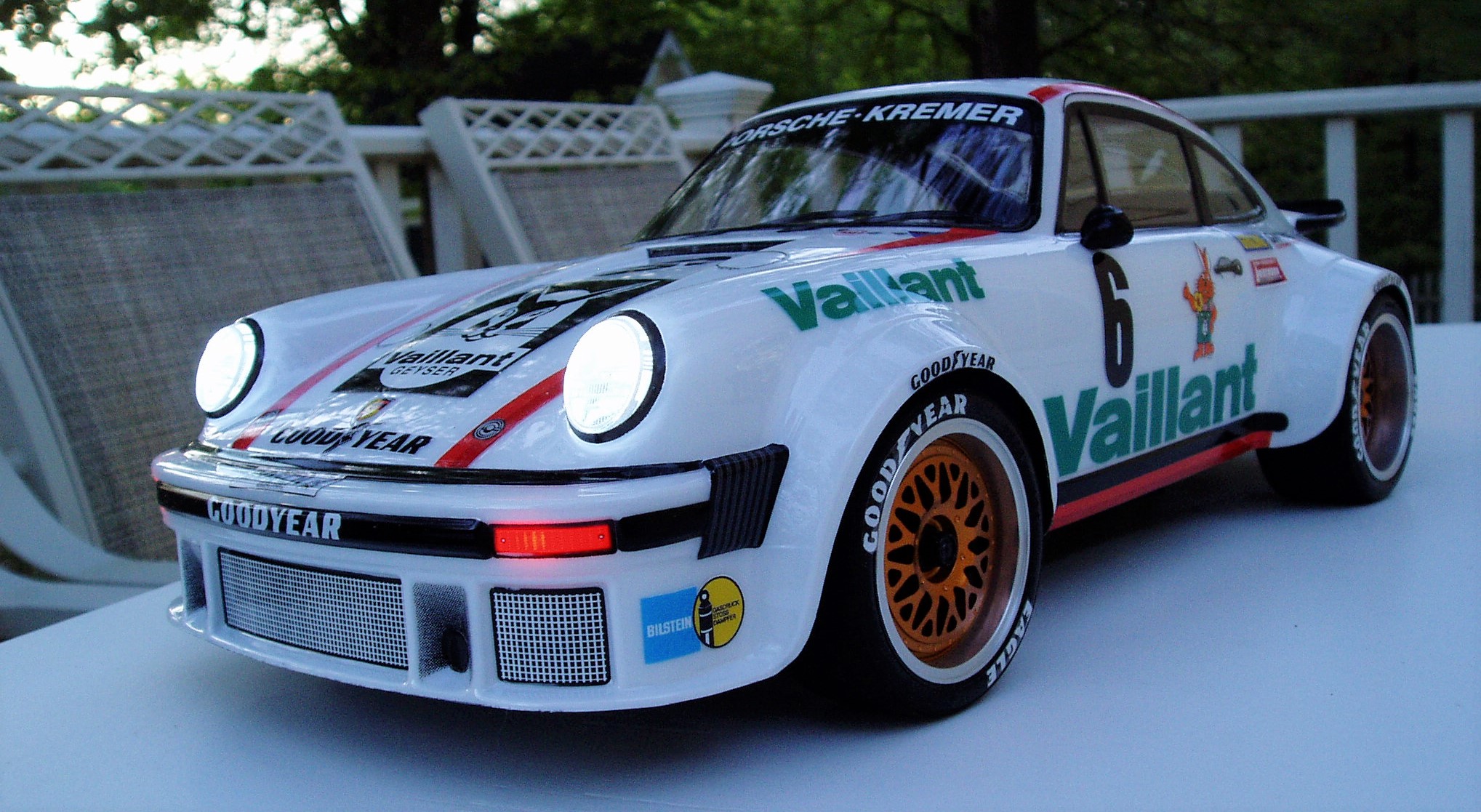

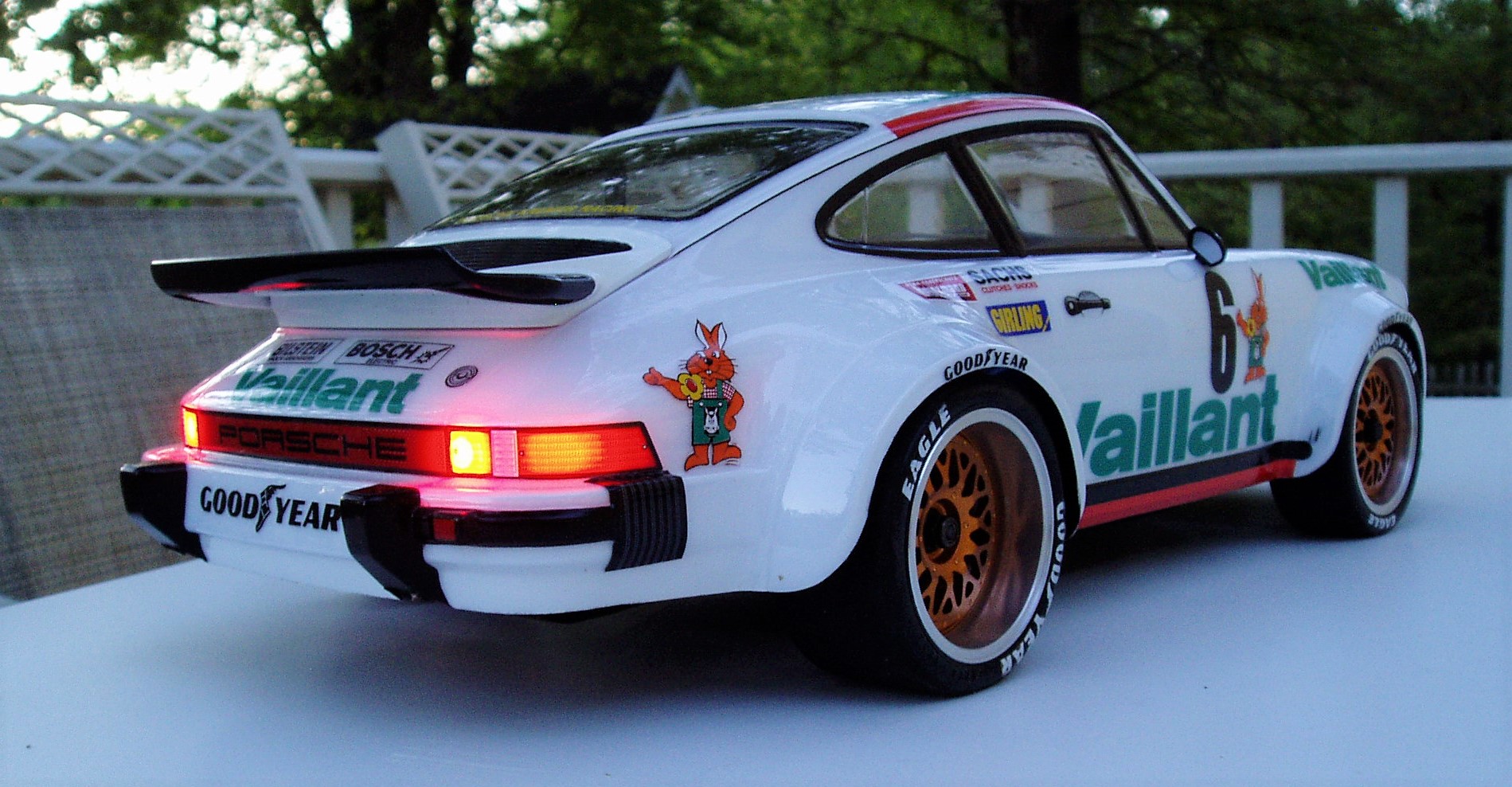

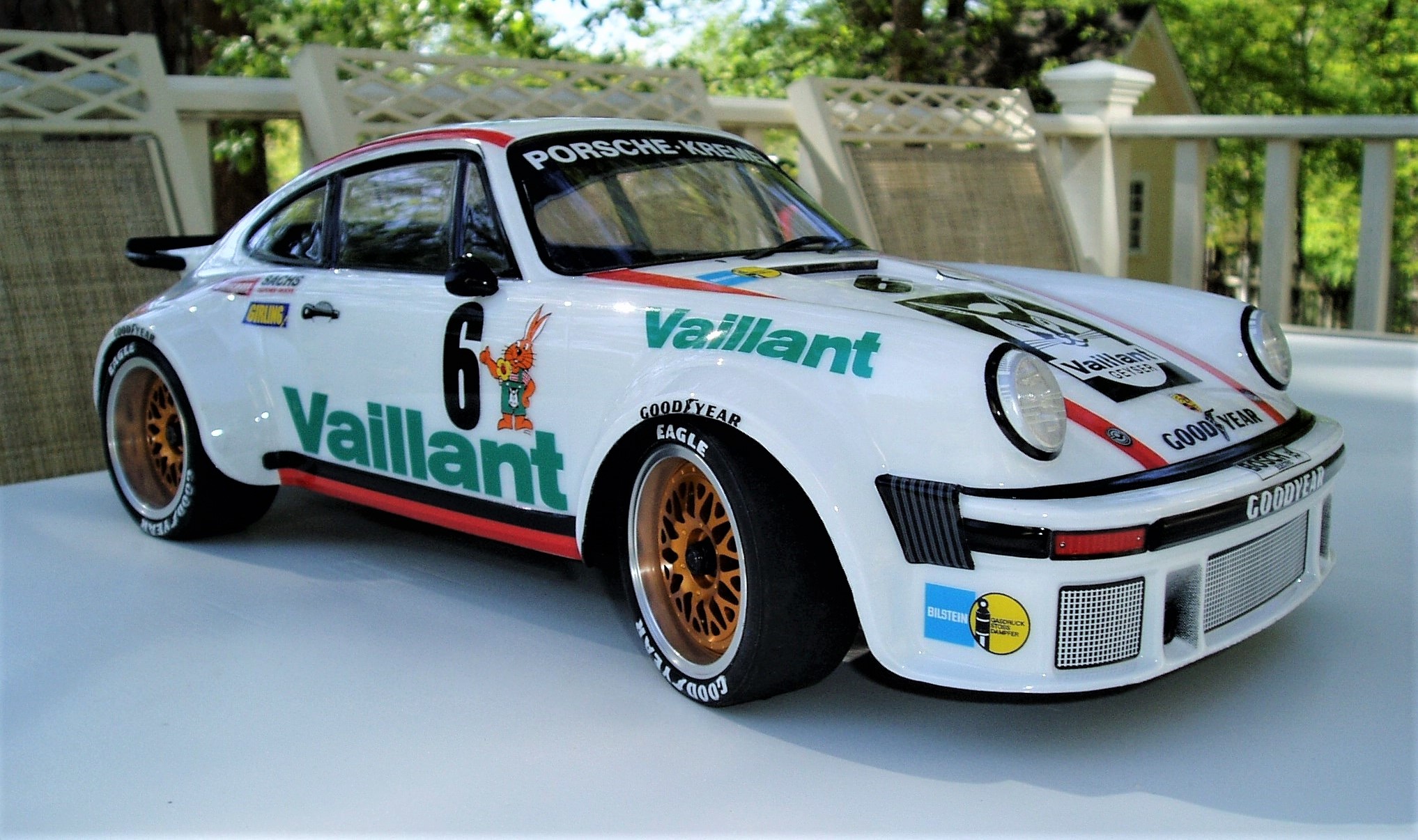

Step 4: Body Paint and Final Details.

RogueIV wrote: Wed Apr 26, 2023 10:37 pm I feel like there's a lot of substeps in step 1 :lol:
Looking good.
Thanks. I started this project between Christmas and New Year's so I've forgotten most of the substeps. :oops:
Often times, I'll document a project intending to post it on the message boards at some point, then I'll start a new project and never get around to posting the prior one. I wanted to get this one up as quickly as possible so documentation wasn't a wasted effort.
I've driven the car a few times and it's a hoot. :D

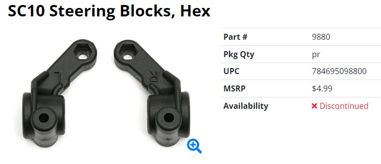

For my curiosity, was there a specific reason that you chose the B4 hex front? Already have it?
If starting from scratch, it'd seem better to start with something more readily available, like the Custom Works kit or something current.
XLR8
Posts: 3318
Has thanked: 1684 times
Been thanked: 1180 times
Re: Create a Porsche 934 replica in 4 steps
Post by XLR8 »
juicedcoupe wrote: Thu Apr 27, 2023 12:15 am For my curiosity, was there a specific reason that you chose the B4 hex front? Already have it?
Yes, I was trying to work with parts already on-hand. I had steering and caster blocks as spares for my SC10.
For the 993 build, since the 9880 B4 steering blocks are discontinued, I've switched to Traxxas 3636 (for their Bandit). The 7919 caster blocks are still available from AE so I'll use them again. Also, the remaining front suspension parts are designed to work with AE caster blocks. IIRC, the Traxxas caster blocks would require longer arms and other changes to retain camber rise, avoid bump-steer, etc. I bought two complete sets of printed parts (for two cars) which included arms so I really don't want to re-design them to accommodate different caster blocks.

A really neat amalgam of parts from several manufacturers.
Great engineering.
And the timeless nature of the body along with the wheels, paint, graphics and lights it's just so realistic.
Well done!

Did you design the printed parts and have them printed? This is so cool, I've been wanting to cut down an old tub and do something like this.
XLR8
Posts: 3318
Post by XLR8 »
n2racn wrote: Fri Apr 28, 2023 12:19 pm Did you design the printed parts and have them printed? This is so cool, I've been wanting to cut down an old tub and do something like this.
Thanks and welcome aboard. :D
Suspension arms are difficult for me to make in my shop so it's much easier to have them printed.
Initially, I'd planned to build an RC10DS for this car but Tamiya's 934 is very short wheelbase and I think it would be difficult to make a DS short enough to fit that body.
Also, the full size Porsche's use trailing arm rear suspension so I wanted to include that feature.
Plus, I was looking for an excuse to create a chassis from scratch. :wink:
