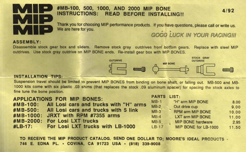

Nice collection of parts, looks like the perfect project Jim, again I shall say :) Just not that the MIP dogbones are not meant to be used with the 5-link conversion, but with the H-arms set-up. If you like I have a brand new Losi retrofit tranny with clear gear-cover and all, I don't think I'll ever use it. Oh, and by chance would you have a spare set of the blue MIP shock cartridges, I just need two of them :cry:

The mip bones should fit fine. I have a set of the MB-100 installed on my 5-link car with no problems. I think that the only difference between the mb-500(5-link) and mb-100(h-arm) are the axle spacers. the h-arm kit includes none, the 5-link includes 3 to "fine tune the bone position"
Jim, I would be interested to see the instruction sheet in your axle kit as it appears to be different from the one I got with mine.
