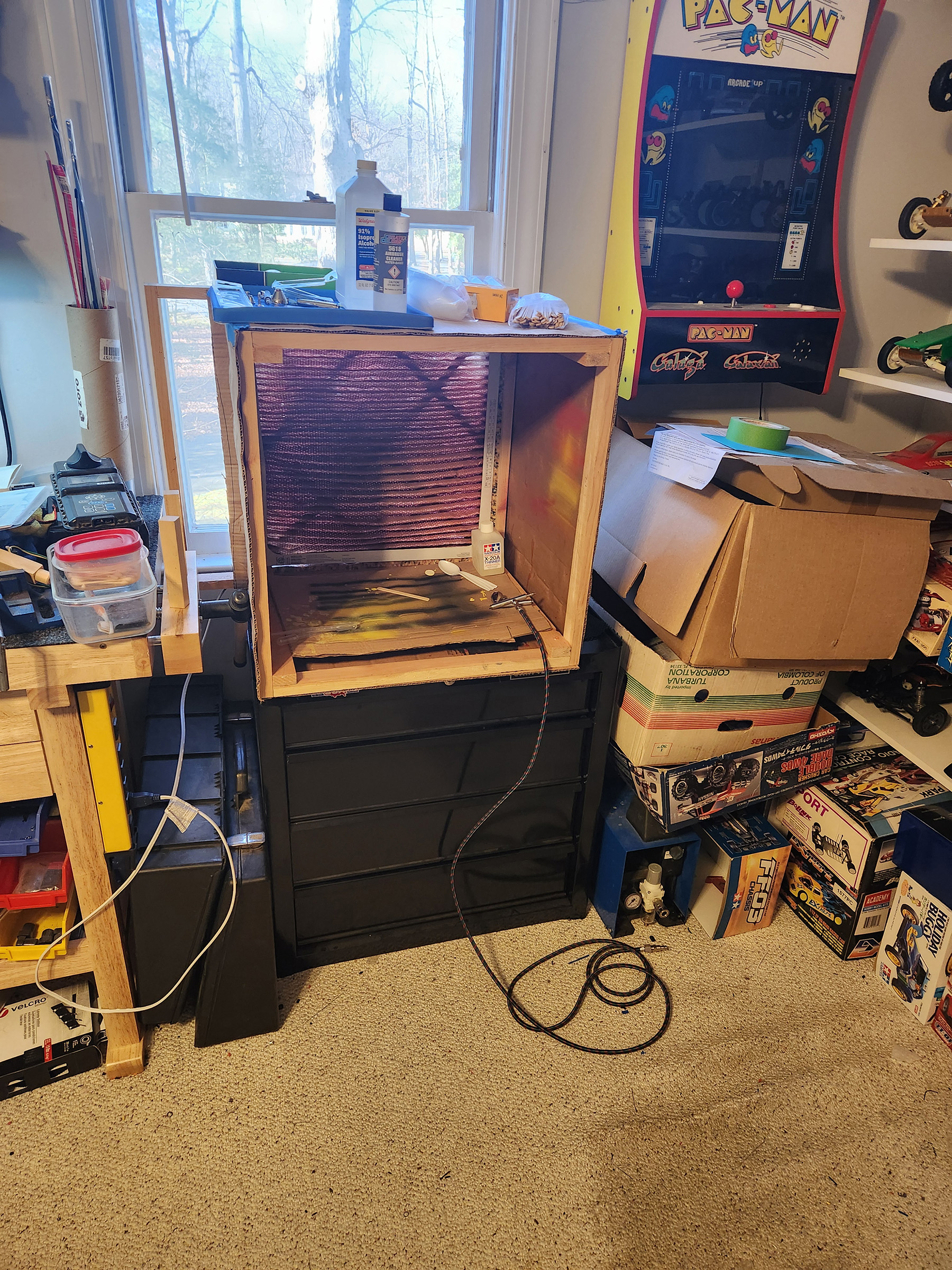

My "station" is temporary, and easy to put up and take down as needed. Most everything just gets thrown inside it, and then it gets thrown under a table. The top of the cabinet is my charging station most of the time.
Its a simple 24x24", 1x2", frame with carboard sides and a filter at the end. Open the window and clamp the cheap box fan under the sash, and then shove the box up to the fan. I keep forgetting to install some lights in it. Works fine for the few times a year and break out the brushes.
