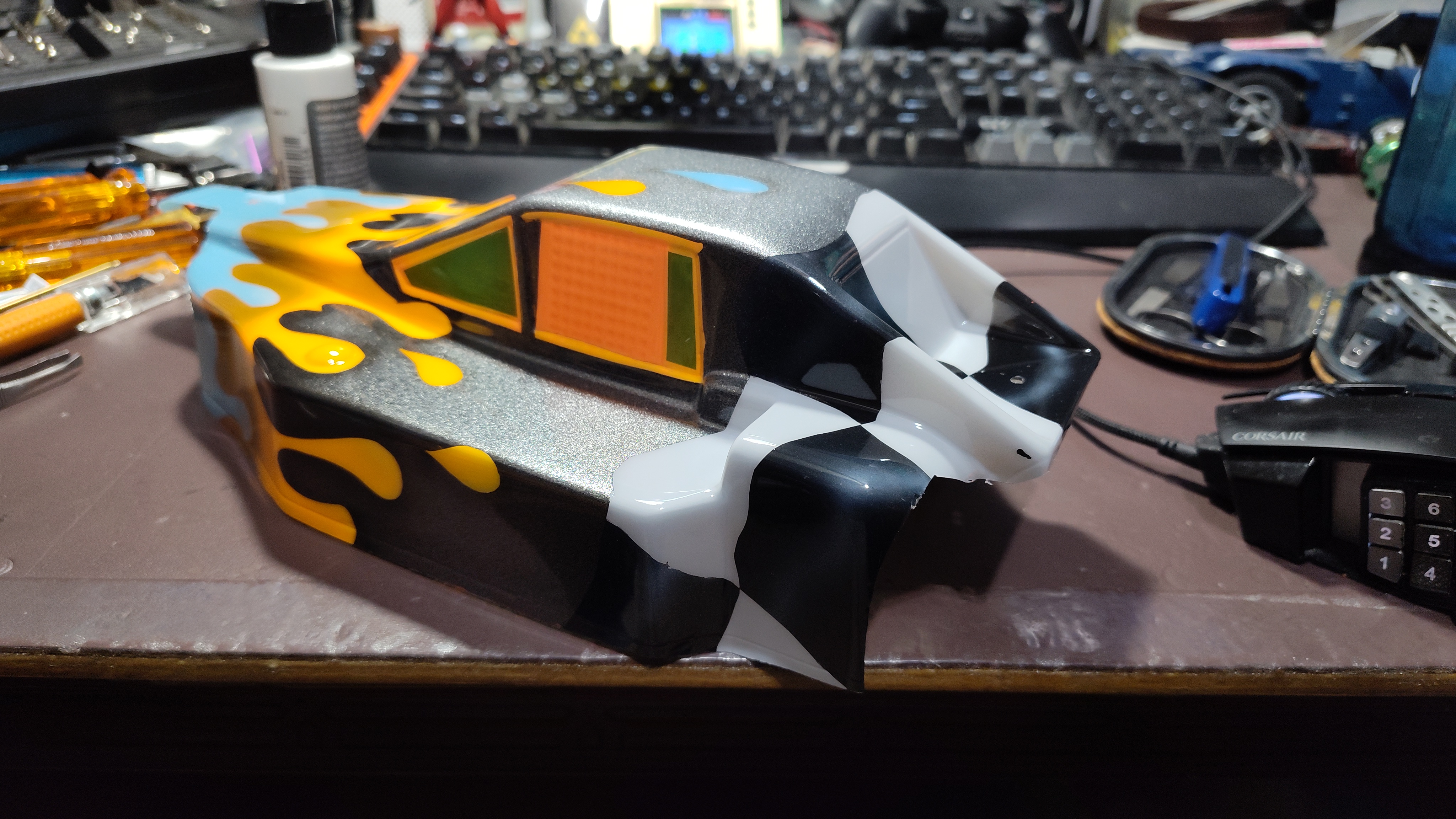

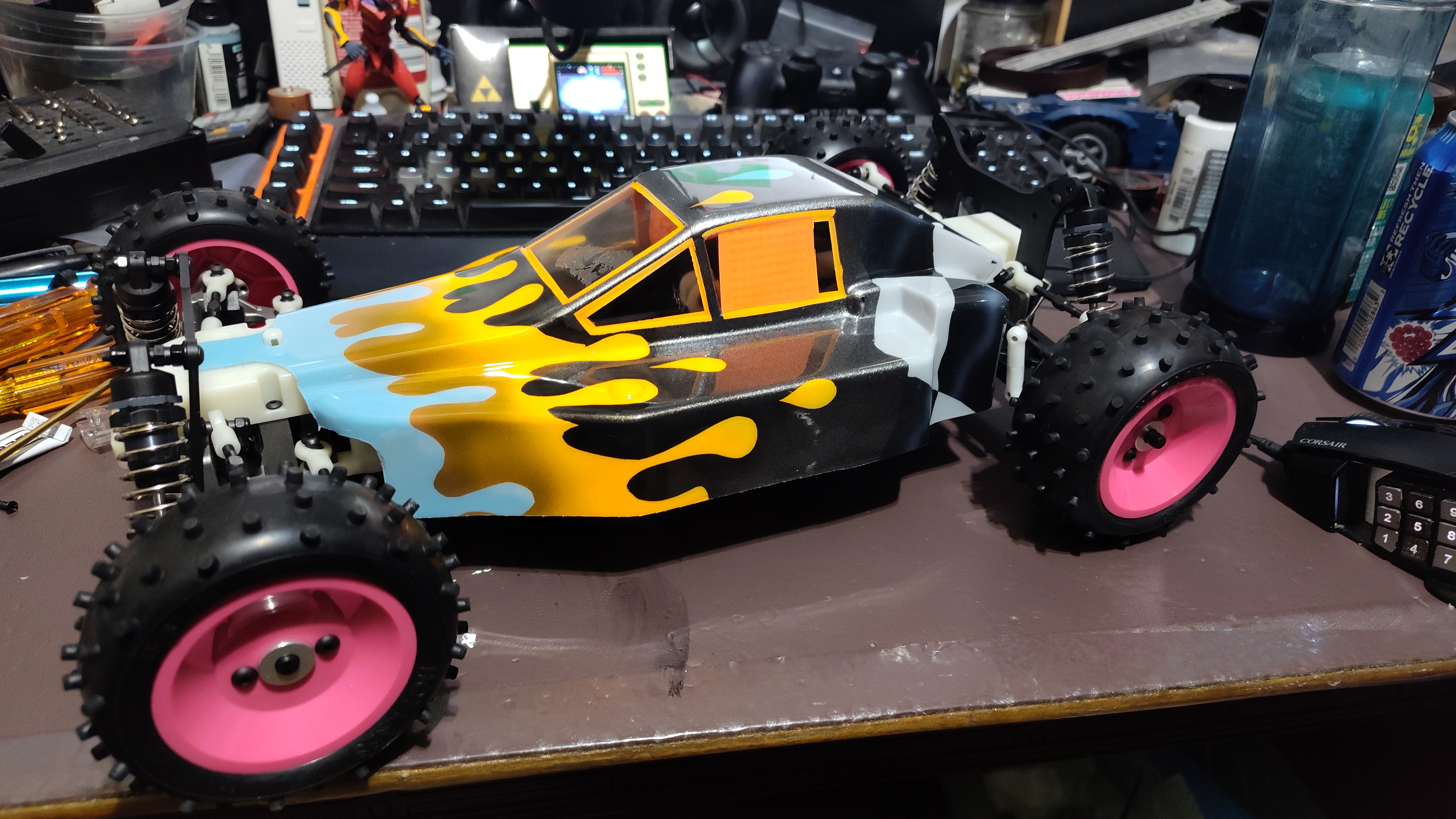

Painted up a spare Yokomo body over the weekend. Decided to try to replicate the scheme on my XX-4 and X-5.
-cutting compound curves is a pain in the ass, especially on curved surfaces
-need to get better on consistent cutting designs and also need a better knife handle that actually fits the blades I'm using.
-bitty designs liquid mask works way better than the spazstix stuff I tried in the past and DIDN"T end in disaster this time(unlike the last 3 times)!
-get the paint mix/air pressure right before starting on the body. Had some issues where I went too heavy on the shading in some areas and it splatters instead of being a gradient.
-Need to use colors that are separated by more shades when doing shading/highlights, a lot of my details disappeared.
-Don't underestimate how much the backing color changes a shade. That was originally Bright Silver but turned to Gunmetal when i spray the black backer. I used this tactic later for the shading on the Orange drips after my original idea was more of less invisible.
-I hate window nets
-just slow down and don't pull of the mask and touch wet paint.
-an airbrush will always clog at the worst possible times.
-a contortionist designed standard airbrushes, I vastly prefer the trigger style one.
-cleanup sucks

Admirable attempt on a Complex paint job.
On the plus side...
There wasn't any real bleed through between colors.
+1 on the dislike of window nets.
Bet it would have looked really pretty backed in white.
Taping some cellophane to a scrap wood frame makes for super cheap practice panels... if you ignore the cost of paint.
On the plus side...

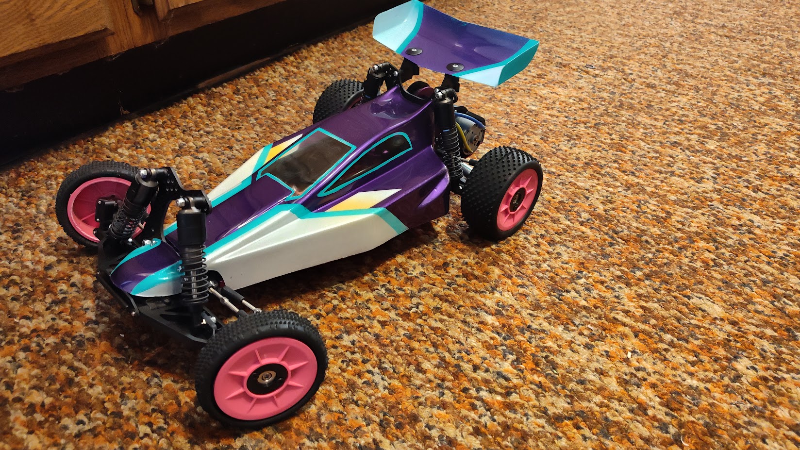

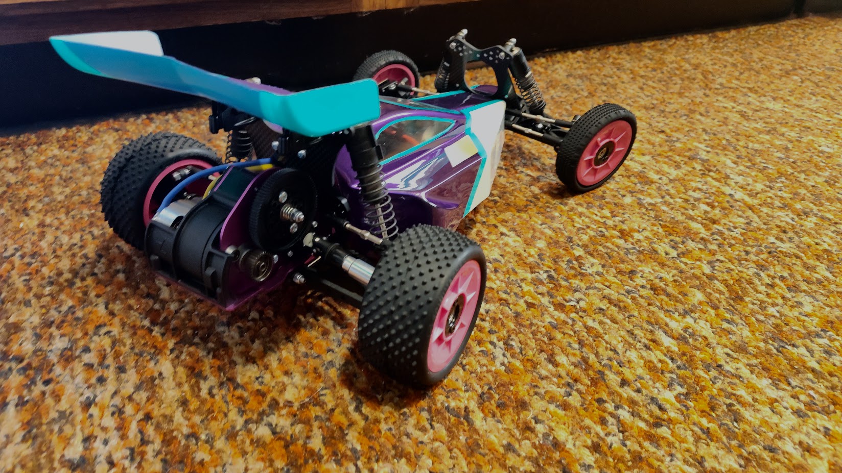

A little less complex this time. Most of this was done with an external mix airbrush as other brush was being horribly inconsistent and I didn't really need to do anything fine. I've gotten a little better at cutting designs but still need to work on my technique in tight areas as the blade kept slipping. I also need a lot better lighting, both at my desk and in the paint area.
The wing I just did really fast so it isn't perfect and I didn't feel like mixing more pearl paint for the white but it's also going to get beat up when I race it anyway. Overall I'm happy with it. Definitely room for improvement but it's a runner not a shelf queen.
