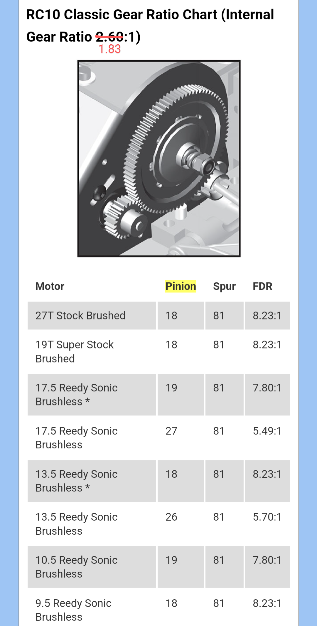

The RC10 Essentials app has this motor and ratio recommendation chart. There's typo that they claim the 6 gear transmission has a 2.6:1 ratio instead of 1.83:1, but they got the final drive ratio math right. I'm not claiming these are perfect recommendations, but they are a starting point.

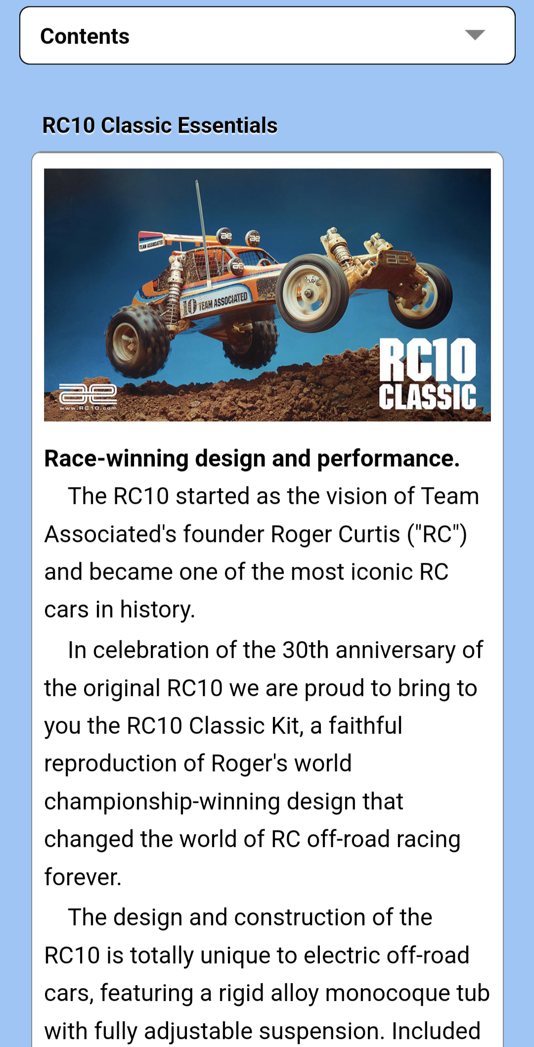

Hi. I see the web app but have not found the section with the table you shared in the second image. Do you mind sharing a link to that page when you get a chance. Your posts have been super helpful. Thanks!Frankentruck wrote: ↑Wed Jun 12, 2024 10:01 am The RC10 Essentials app has this motor and ratio recommendation chart. There's typo that they claim the 6 gear transmission has a 2.6:1 ratio instead of 1.83:1, but they got the final drive ratio math right. I'm not claiming these are perfect recommendations, but they are a starting point.

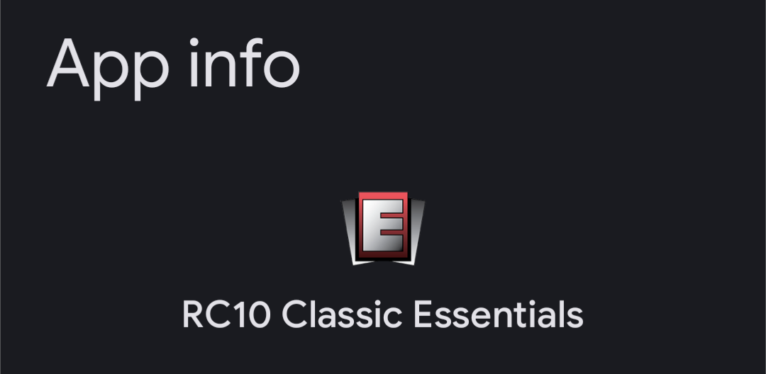

The web app used to be offered as a phone app, but apparently they stopped publishing that. This is the web app link (just to have the link):
https://apps.associatedelectrics.com/ateamapps/vehicle_reference/rc10classicessentials/index.html
The gear ratio part is here:
https://apps.associatedelectrics.com/ateamapps/vehicle_reference/rc10classicessentials/pages/manual-Tuning.html
