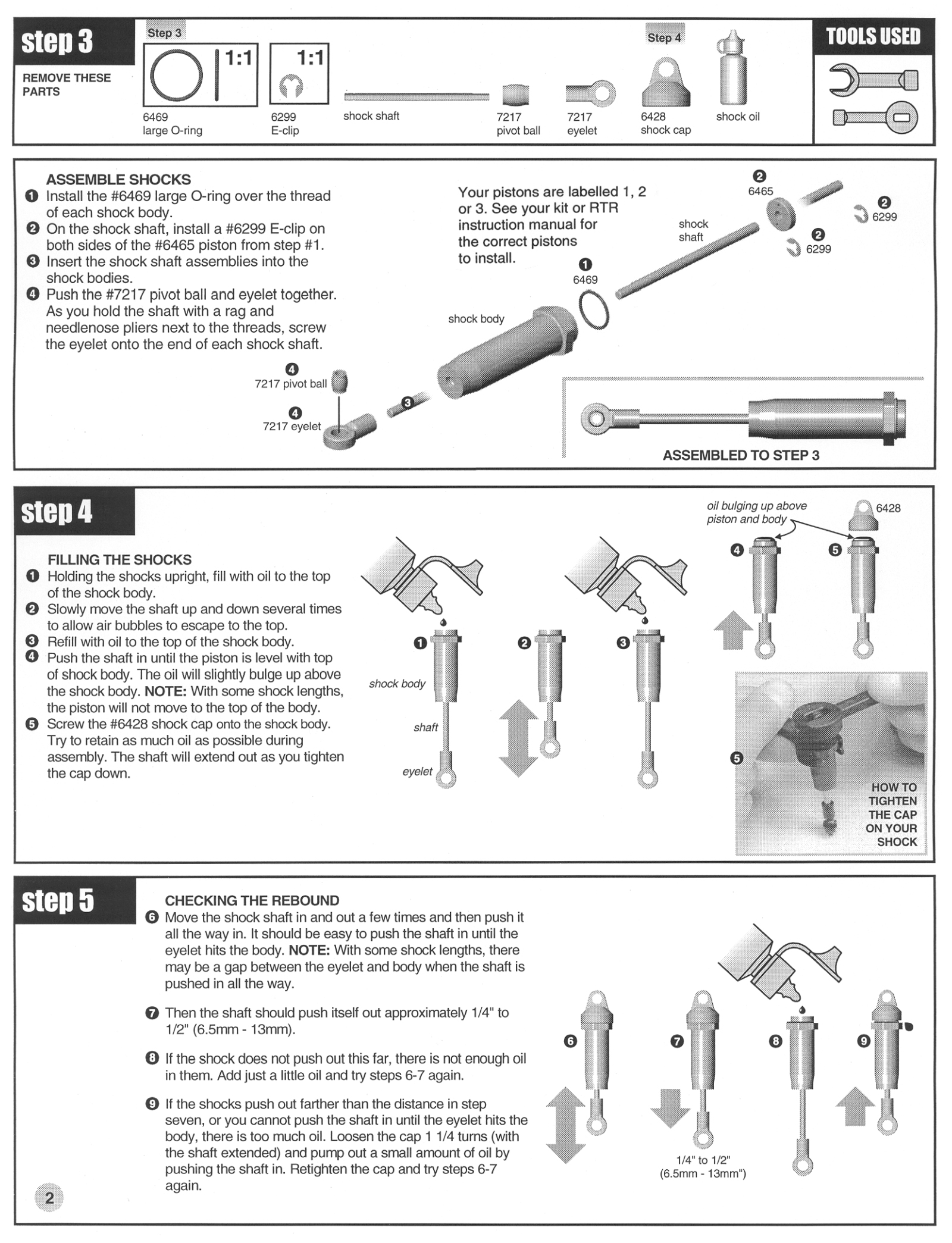

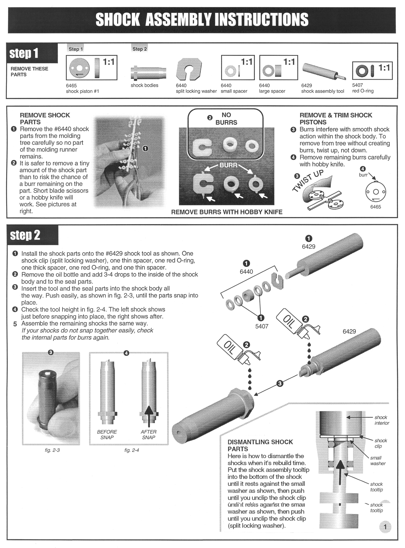

Introduced on the RC10 Team Car in 1991, the seals of the aptly named Team Shocks were loaded from inside the shock body instead of the previous RC10 Gold Shocks bottom loaded seals. The thread pitch on the Team Shocks was also finer than the original Rc10 Gold Shocks, a feature that would extend to later kits in which the Sport versions would receive gold anodized Team Shocks.
Interesting factoid... early Team Cars and the '91 Winter Championship RC10ST's had plastic shock caps, not aluminum like later production versions.
https://img2.associatedelectrics.com/pdf/cars_and_trucks/RC10T/shock_assy.pdf
Team Associated Team Shock Assembly Manual
