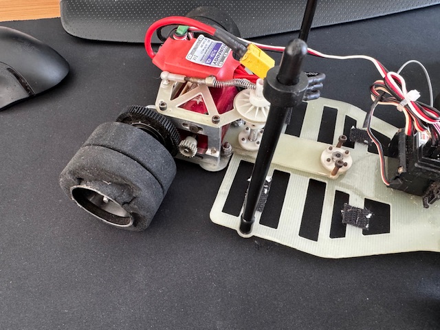

I fixed and cleaned up a vintage fiberglass RC12L. Added a spare brushless motor and an airplane ESC I had lying around. The car drives great at slow to moderate speeds but its almost uncontrollable once i accelerate, even on slow settings on the ESC and expo on the remote I have to feather it. I drove it around on a tennis court near my house and it was great, but the old foam tires are in really bad condition and started losing chunks. I want to keep driving it but need to put power to the ground and think some rubber tires would do the trick.

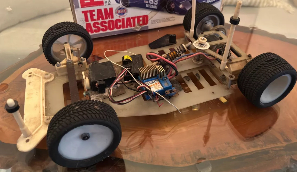

Anyone know where I can get radial tires for the RC12L? Looking for something like the in the photo.

FWIW the picture of the car with rubber tires is an RC10L (not a RC12L) with Proline 2567 rear wheels/Proline 1063 road hawg tires and RC10 buggy front wheels/Proline 1061 road hawg tires.
Converting the axle to accept newer wheels like juicedcoupe said is a good option, but another one is n20capri here on the site made adapters to run 3 bolt wheels that he sells (sold?) through shapeways:
https://www.shapeways.com/product/VGLQFFT6M/vintage-team-associated-rc12l-wheel-hubs
Could drop him a PM or Email to see what he knows about getting a pair.

Dangeruss wrote: ↑Wed Jul 17, 2024 4:26 pm FWIW the picture of the car with rubber tires is an RC10L (not a RC12L) with Proline 2567 rear wheels/Proline 1063 road hawg tires and RC10 buggy front wheels/Proline 1061 road hawg tires.
Wow thank you so much. I recall having road hawgs on my Traxass Rustler back in the day. I’ll look into the shapeways link. I have a 3D printer and some ABS filament.
