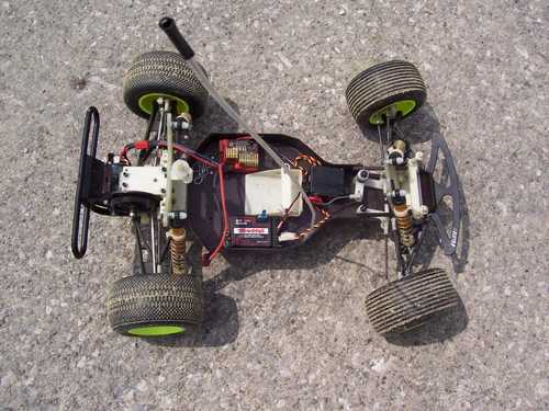

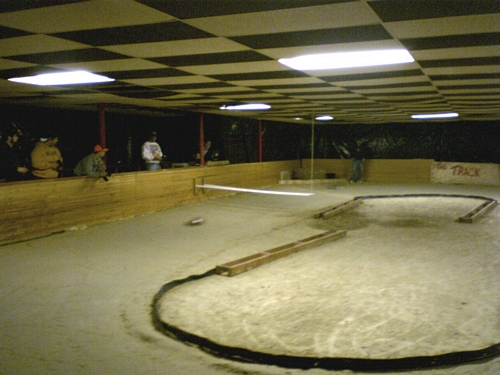

pics of truck and track...
Old age and treachery will win out over youth and exuberance most every time.
Bluegroove
Posts: 6
Joined: Mon Feb 25, 2008 10:49 am
Location: Seymour In.
Re: Vintage RC10T kicks butt at local club track
Post by Bluegroove »

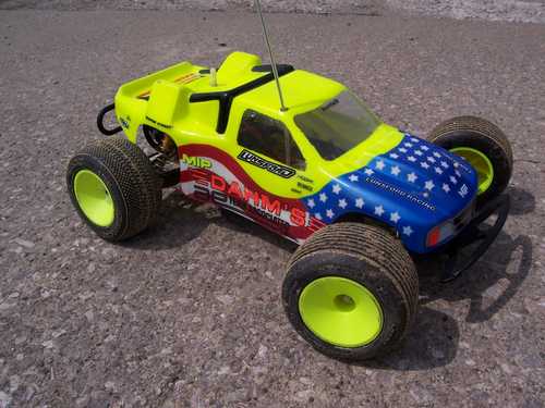

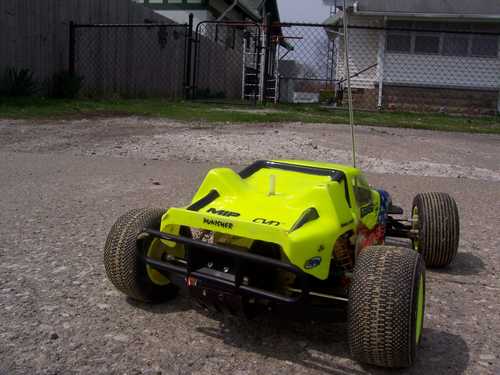

and the truck...

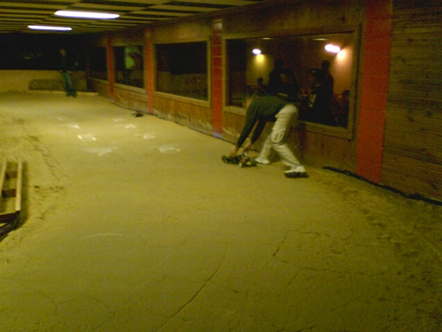

I should snap pics of the "Wall Ride" at my local track. Nice to see a vintage getting used!

Tell that guy to stop leaning over the wall! Sorry one of my pet peeves :shock:
