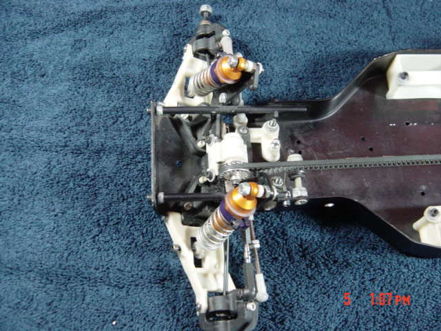

Have a few little things to replace and wrap up (like powdercoating the engine mount). I've had the powdercoated chassis sitting around for ages and finally decided to put it to good use. Haven't decided on the wheels yet. Don't like the plastic MIP wheels so I have to rummage around for a set of aluminum wheels and a body. This is what I've built so far though.

looking great alex!! are those rear a-arm mount a custom piece you made?

super sweet as usual dude. :mrgreen:

Nice! 8)
