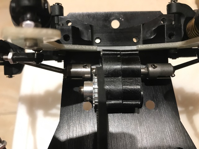

I started an MIP 4WD project, using a Sassy Chassis, and mix of MIP and Andy's parts. The front Andy's arms match the AE factory short arms. The MIP SP-32 was fairly used, but cleanup well. My main issue is the front outdrives appear to be short, causing the cvd bones to barely engage.
Approach 1) Try a new set of MIP outdrives that are slighly longer - problem is but the ID is too narrow.
Approach 2) Get improved engagement by moving the unit further forward - this would require additonal filing the instructions dont call out.
Approach 3) find longer dog bones - not sure of availability
Has anyone else had this problem? Do you see anything wrong with layout or parts used? Can anyone provide dimensions for oudrives and cvd's?
Hoping someone can help.
Thanks Limestang

The problem with the sassy chassis is the holes on the kick-up are pushed forward compared to any other rc10 chassis, I believe creating your issue.

I also think that the short Andy's arms are not swept back as hard as the stock short arms. That's not helping you out either.

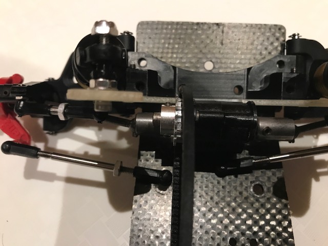

Darn I wasnt aware of the differences with the Sassy Chassis. I found a photo of an SP-32 conversion with a sassy chassis at the following link (scroll down near bottom):
http://www.toybaron.com/MIPreference.htm
I did think about attempting to increase the ID of the new outdrives on my lathe.
Thanks for responses. I will keep you posted on my progress.

Yeah, that's Anthony's old car. Look in this thread, you can see how far front they had to drill the trans holes in the chassis.
http://www.rc10talk.com/viewtopic.php?f=35&t=4917&hilit=4wd%2BMIP
Did your's comes with the trans holes already drilled? I don't know why, but i kinda thin the one I had years ago had them.

Graphite chassis helps. Looks like longer outdrives would add necessary safety margin.

What shocks do you have up front?

It also looks like you have a lot of dropped up front. Might want to adjust shock positioning to help the drive engagement.
Posts: 16810
Re: RC10 MIP 4WD help Needed
jwscab wrote: Tue Oct 03, 2017 8:12 am It also looks like you have a lot of dropped up front. Might want to adjust shock positioning to help the drive engagement.
Yeah. That's why i asked about the shocks.

Thanks for your suggestions. The front shocks are AE .71".

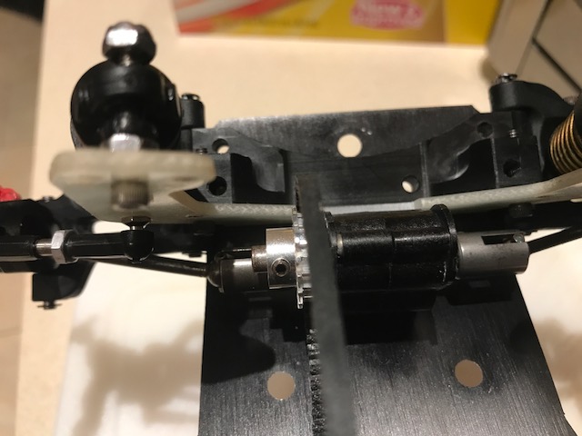

I’ve experienced the very same thing. Just as jwscab wrote, lowering the front suspension a tad will engage the dog bones more.
I wish MIP made the dog bones a bit longer

Yup you should use 0.56 shocks with short arms and a GEN 1 shorter front shock tower. Here is mine, no issue with dogbone engagement.
In fact, now that I think of it, I flipped the front bulkhead to have more room there and be able to push the front transmission more forward and better align the dogbones.
