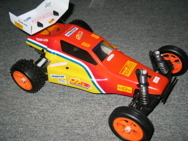

I picked up this car off the bay: http://cgi.ebay.com/ws/eBayISAPI.dll?ViewItem&rd=1&item=330252158077
My main motivation was the box as I didn't have one and I am trying to get one of each. the pricelist included with it is september 1988(scans pending)
It has a lot of the early parts on it, 2-hole links, no-logo motor plate, big lettered/non-reinforced steering arms, and more.
The most interesting part is the chassis and shock towers, and bearing spacers.

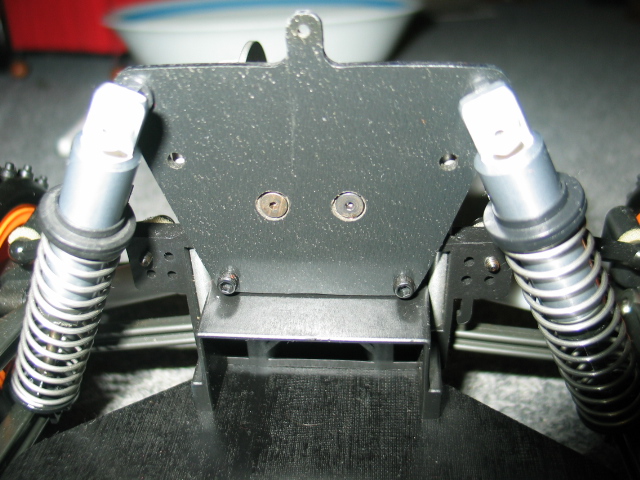

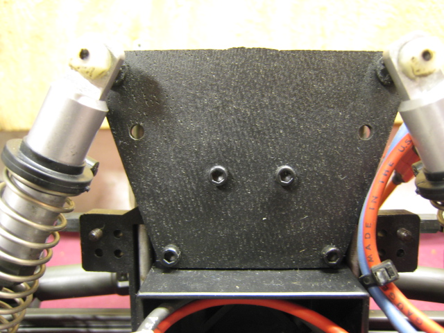

I have not been able to get ahold of the "no-hole" rear shock tower until this point. The 2 shock towers are made of a different appearing material from the regular towers, it is thicker and has a sparkly finish to it. Someone had mentioned in the past that these may be trinity, but I don't know if they are aftermarket or original. The car came with a lot of paperwork, includding header cards for the foam tires and gear charts, but nothing about shock towers.

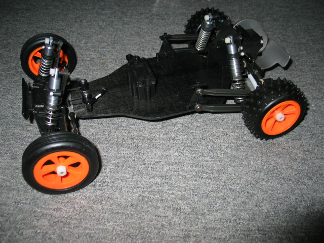

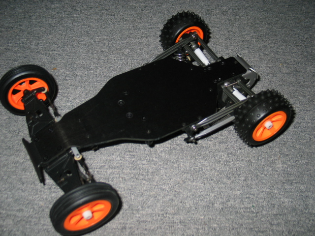

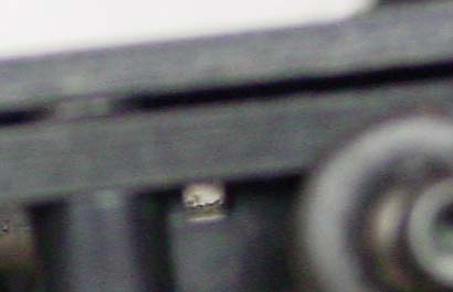

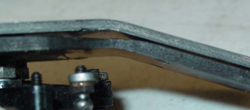

The chassis is different than the other 3 plates I currently have. It is signifigantly thicker(just like the shock tower) it also looks to have been sanded up front at the kickup. it is much too uniform and even to be wear from use especially since there are very few scratches elsewhere on the chassis.
This blurry pic shows a standard plate on top to show the difference in thickness. (My macro function is not doing so well tonight)
The sanded/machined are at the apex of the kick-up gives it a more gradual transition on the underside.

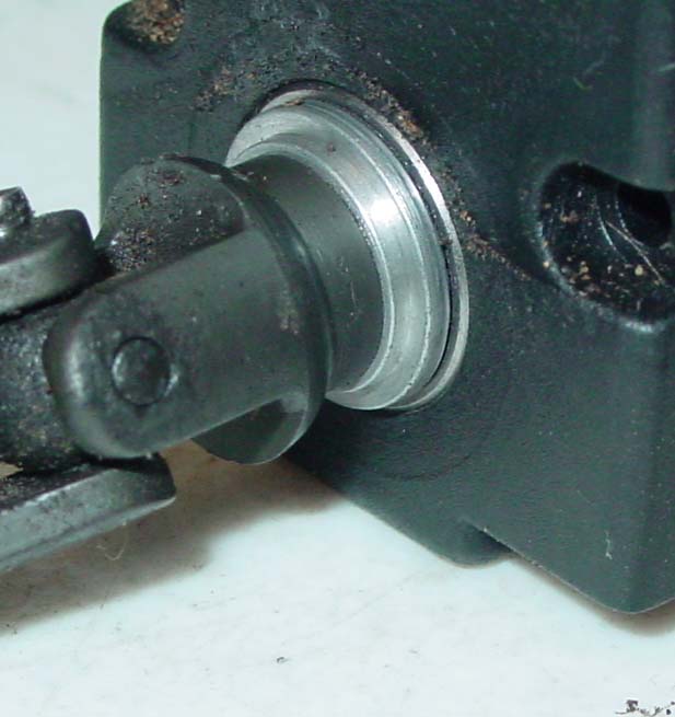

the last interesting bit is the aluminum outdrive spacers/bearing shields. I have never seen these before, anybody else have a pair of them?
as an aside, does anyone know what the 2 holes in the rear shock tower are for? Now that I can look closely at the boxart, it almost looks like the wing tubes are zip-tied to the tower,

Ive never seen the holes in the shock towers but I do have a set of the outdrive spacers. they came on my Early Jrx2

I have a couple of them with the alloy spacers. I have never noticed the other differences. I have an unusual rear shock tower myself that I have no idea where it came from. I will have to post some pics.

my early jrx2 has the same rear tower, except my body mount either broke, or had been cut off. :( it's definately a different material than the front tower. in looks and thickness, as you had mentioned.

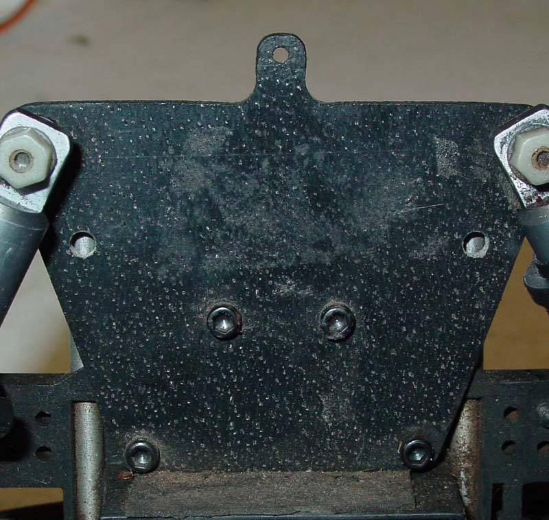

i think it was david (asso_man) who said he thought his "no hole" tower was a trinity. i think the two upper mounting holes were countersunk on his. but that could've been done by the previous owner to mount an esc on the tower.
mine also has the aluminum outdrive spacers, and i think my original junior-t (1991) had them also. but my later, new built version has the black plastic ones.

yes i also have the alloy spacers and the sparkley rear tower.. my chassis is the most interesting part it has a very shinny textured bottom finish...ive added a few optioned parts super sliders, alloy screws,ball raced steering pro centre diff gear and factory painted body with orange rims...one my my fav buggies for sure,worth as much as any rc10 to me..can i say that? :mrgreen:

I was aware of everything but those alloy spacers, they do look great, I'll have to find a pair for my early Jrx-2. I thought the towers were Trinity because a member here told me so in the very first days I was a member, but now I'm pretty sure those are the earlier shock towers (plural because on mine, the front shock tower is of the same material as the rear one, anybody else?). The chassis is also different than any other I've been in contact with: it has a mirror finish, a few pics for those who never went there (the shock towers were on my hopped-up Jrx-2 when I took the pictures as I was still unsure they were original, now they sit on this one):

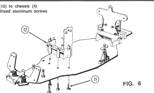

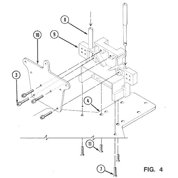

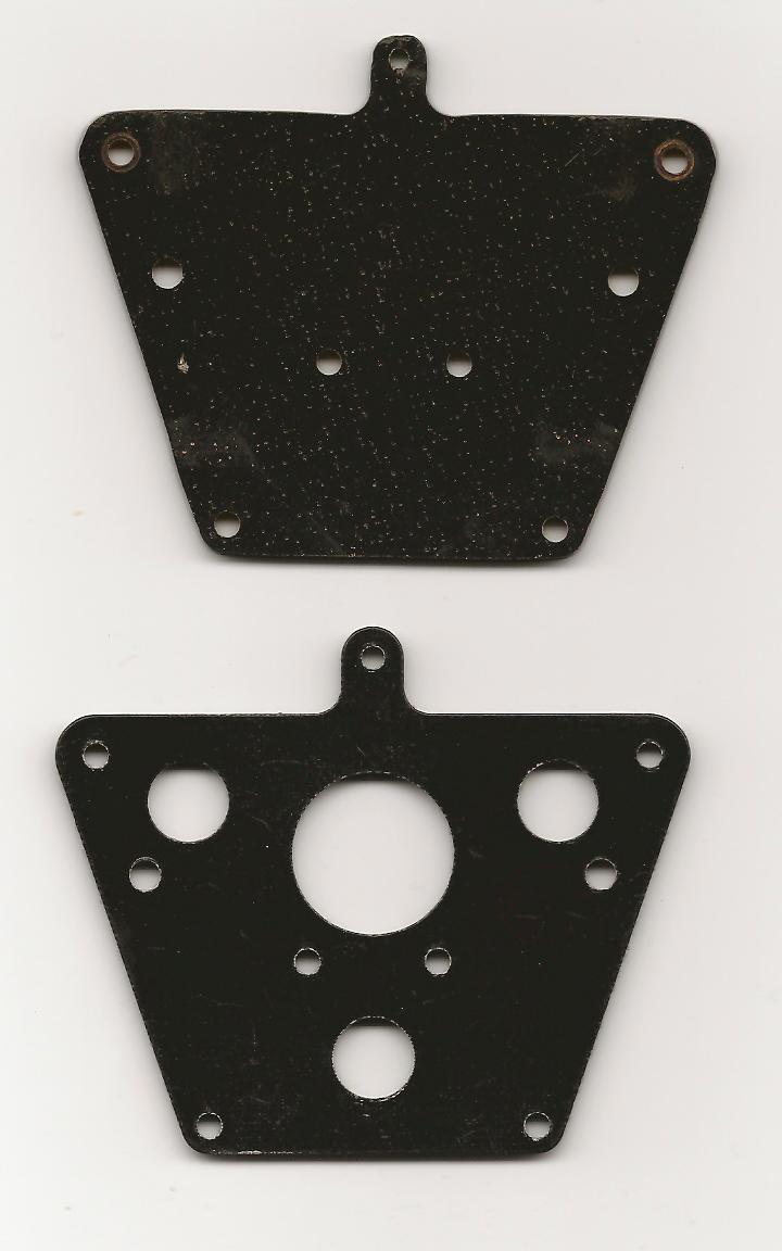

Hello guys from an original owner of just about every early Losi. I believe the first rear tower shown, aconsola’s, is correct. This is how I have always spotted an early car from a later car. Note that the tower dips down a little next to the body mount clip. Same pattern of little spots. No countersinking, standard socket head bolts. Suspect mauri’s might be modded for mounting the speedo, I’ve seen guys do that. No idea on the extra holes.
My calipers are junk, but the front and rear towers are about 0.100”, the fronts may be slightly thicker, less than 0.005” I’d say, based on an early X2 and spares. The chassis are both about 0.125”. Hard for me to comment on finish, they all seem shiny and slightly different to me, and I change my opinion depending on the angle and light and such. Perhaps production variation. But none of the chassis seem to have the spot pattern. The sanding or whatever at the kick up sure is weird, why would anyone need to do that? That’s where they break by the way. Or so I’ve heard!

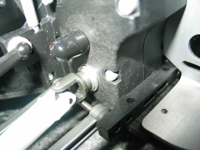

My early car has the metal outdrive spacers, my early truck and extra tranny appear to be plastic.
My first attachment shows my early car and later towers. Then some scans from the manual. Figures 4, 15, 16, 19, 26, and 43 show it correctly. But figure 6, page 4, and figure 37 seem to take care of the extra hole!
Cheers guys, love the site. Oh, I will be adding to the parts/price list thread for those interested.

what version of the manual do you have? My guess would be that you have "production release" on the front cover. I have not seen those pictures like that before.
I just reviewed the manual I got with this car, it is "revision A" , my figure 4 matches, but figure 6 in this edition has the tower looking like fig4.
