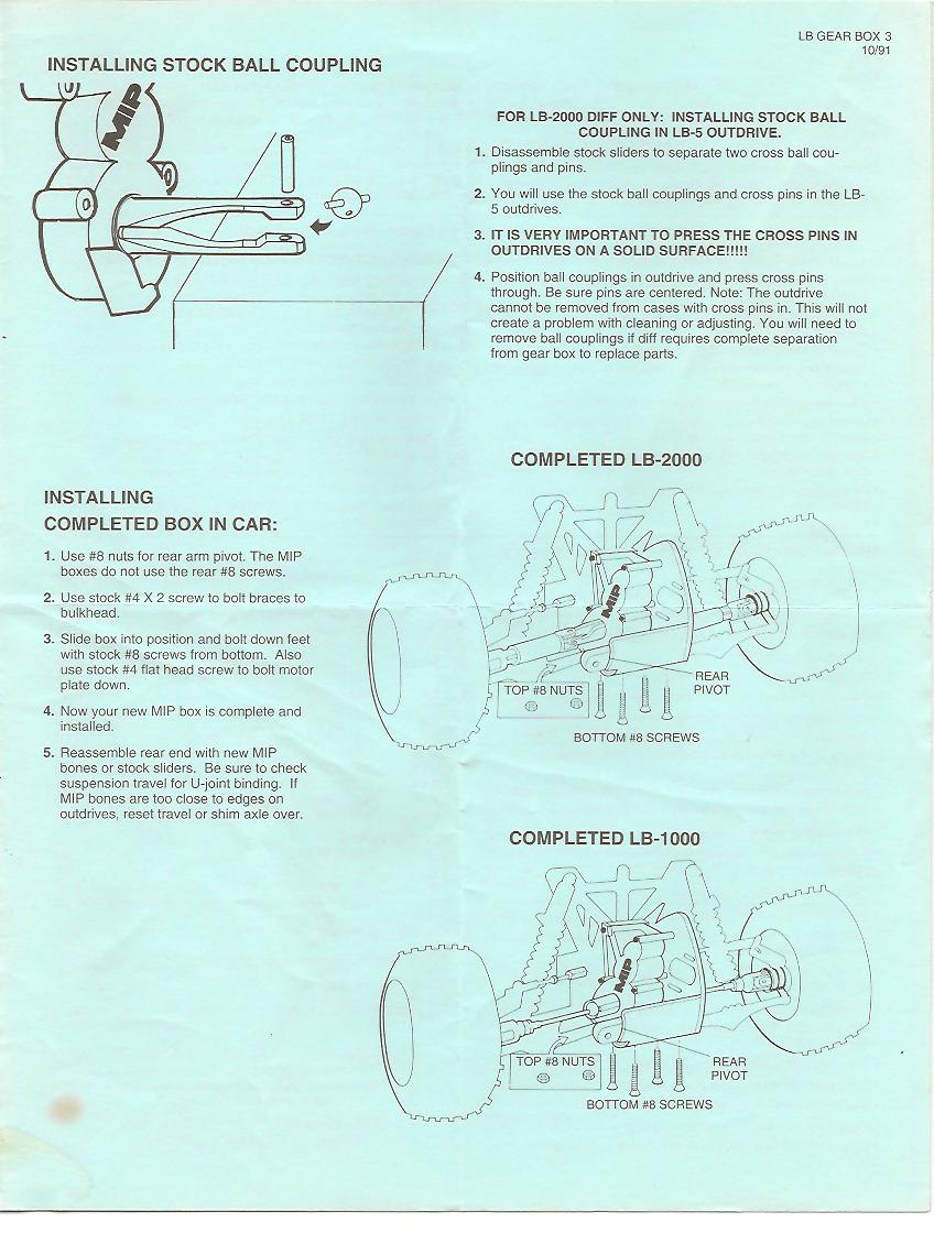

MIP LB Gear Box page 2.jpg (129.34 KiB) Viewed 1872 times

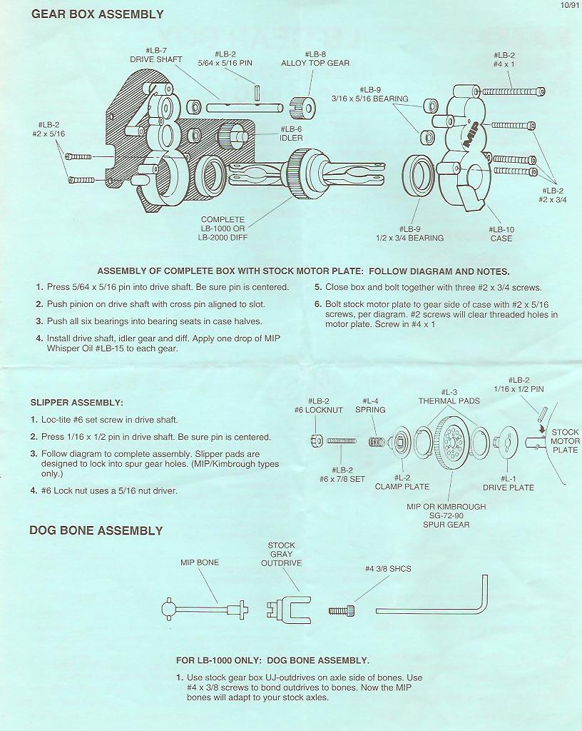

MIP LB Gear Box page 3.jpg (132.91 KiB) Viewed 1871 times
