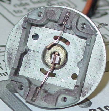

aconsola
Posts: 1999
Location: Upstate NY
Re: Which way does Endbell go on??
Post by aconsola »
Halgar wrote:
Asso_man! wrote:
Halgar wrote:Tuned motors may have different springs on the (+) and (-) brushes. I don't remember what this accomplishes, but it is something to be aware of.
This is mainly because the (+) or red pole always wears faster than the negative one; that's why you often have a softer spring on the pos. :wink:
So on my 540 Mabuchi's I'll need to upgrade that spring? :mrgreen: :wink:
Nahh, Just keep running them until they look like this:
That was a 370 motor that finished off the brush in mid flight :shock:
I've given up flying since, I'm a better driver than flyer, and many of you know how "good" of a driver I am :wink:
Halgar
Posts: 3547
Has thanked: 146 times
Been thanked: 197 times
Post by Halgar »
aconsola wrote:Nahh, Just keep running them until they look like this:
LOL I've got a couple crispy 540's that I was going to open up and look at just for giggles. By the time my clod is finished with them they're in seriously sad shape. On a positive note, I recently just completely opened up a couple of SG Sapphires and all the internals are in good shape. Considering that the truck gets run in mud and muck the brushes and comm were in excellent shape - no scoring, no abnormal wear, no heat damage. I was quite surprised.
