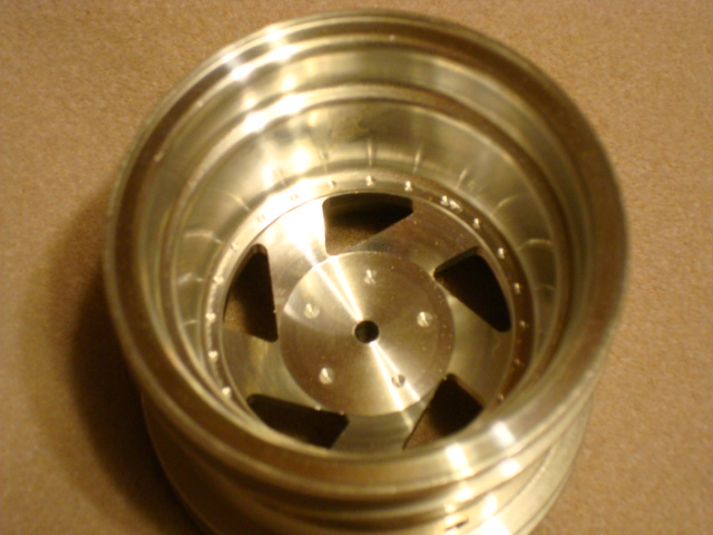

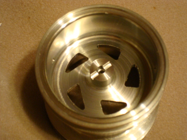

I have this set of wheels, See's Kyosho Rear Truck wheels with directional spokes Model No. 3415
Measurements:
Axle hole is 5mm stepped down to 4mm
Diameter where you glue the tire: 65.5mm
Diameter of outside lip: 74mm
Width: 57mm
Anybody have an idea what this fits? Since it specifies rear, I am assuming it is for a 2wd truck. Does anyone know if it could be used on any of their 4wd trucks?
Thanks fellers.
Measurements:
Width: 57mm
Thanks fellers.

this is funny. i was gonna send you a pm about it ealier today. i have the exact same pair of rear rims and was gonna ask you the same question. you know, since your the sees guy.

OK, i'll be the retard and answer my own question. At least for scr8p's benefit!
Got to digging last night, and it seems these will fit the following:
Big Brute
Hi Rider Vette
Double Dare
Big Boss
USA-1 electric axles I think), but tires for the USA-1 are much wider than these wheels allow.
Seems the Kyosho 2wd monster trucks have a front axle that uses the cross pin in it as well as the rear.
Big Brute
Hi Rider Vette
Double Dare
Big Boss

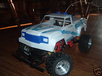

Re: Wheel ID help, please!
They fit the Tamiya blackfoot, lunch box, and will also fit on some of the older Traxxas like the Eagle. I have a set of 4 forsale on ebay right now.
Well don't know if mine are the exact duplicate of yours, See's made many different wheel styles for alot of different rc name brand vehicles and I have not checked the diameter size on mine, but I did try these on 2 different blackfoots just to make sure that the previous owner did not modify the blackfoot that the wheels came and they fit perfect on both.
They must be different then mine,the wheels I have are the same width,height, and bead is the same as the blackfoot stock wheels.

- RichieRich
- Posts: 2360
- Location: Los Angeles, CA
- Has thanked: 39 times
- Been thanked: 25 times
Brandon,
The Kyosho trucks you listed use a weird mounting hub similar to the hotshot where there are little nubs that fit into the wheel. They can be removed which just leaves the axle and crosspin.
