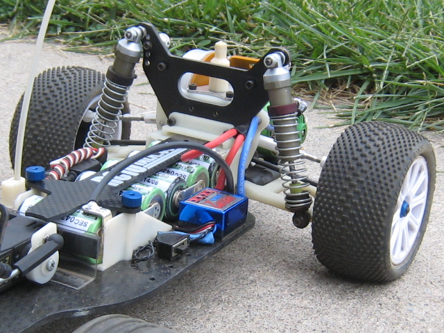

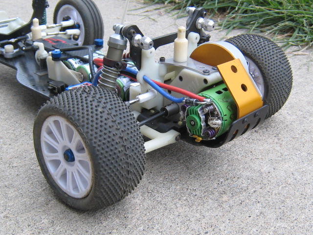

my car handled pretty good, but landing off the jumps was a different story. it definatly needs smaller pistons and heavier oil. when i put the car togther, i didn't compensate for the different geometery of my rear suspension compared to a standard rc10. so it was a bit too soft. and at the track, i didn't have enough time to get it right.
another thing i want to do is make a new rear tower so i can lay the tops of the rear shock inward. the way i modified the 10t tower i used, it's not an option.

the only reason i ended up using the 10t tower was because i had planned on seibenslammin' the body. then i decided not to. but, i already had a brand new rpm 10t rear bulkhead on the chassis, and didn't want to open up a new buggy one, too. so, i ended up chopping the 10t tower down to buggy height. i would've had to add a bunch of external limiters if i hadn't. the problem is there's not enough width on the tower where the shocks mount to lay them inwards. maybe a little bit, but not much. so, i'm either gonna custom make a whole new one, or i'll need to swap out the truck bulkhead in favor of one for the buggy so i can use a standard buggy tower. or maybe i'll make an rpm worlds tower. who knows. i got some time to figure it out.
