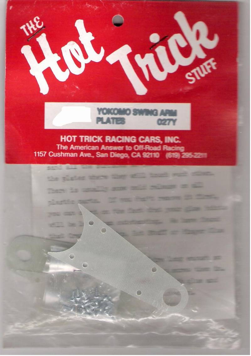

Where I used to run, the 834b's went through a lot of rear trailing arms. Some of the guys would reinforce them with a graphite, fiberglass, or aluminum plate mounted on the outside. I'm not sure if there was a second plate on the inside.

I'm afraid you're going to find that the plastic used on these is not as strong as you had hoped. I found a picture of the rear arm reinforcements I was talking about. I did a google search for Hot Trick Yokomo and saw several of the hop ups that used to be available. Hopefully it will give you an idea about how you can make your own. You'll probably need something a bit thinner than your 3 mm graphite blank. Another problem was in the early slipper clutch. I know the later ones had an improved clutch (like on the RPS SE) but people replaced the early ones with a Delta slipper clutch. You will also find that the shocks are great! (For the Arabs!) You are going to go through some oil. Should be easy enough to find replacement shocks but I don't know where you are going to find a slipper. Maybe someone here can help with that.

Aku told me the main problem is the stiffness of the rear arms. As I understood they don't break but tend to open up casuing the drive shafts to fall out of the cups. The side plates on the arms help ofcourse, but he also had tiny cables from the arm end to the rear of the chassis. I 've seen these on dr. robotniks pictures also.

-For the rear arms, as with ALL trailing arm systems they can flex outward if not secured causing the loss of dog-bones and also excessive drive-train wear. This was part of the design and you are meant to zip-tie the arms to the rear bulkhead. This still flexes though so Hot Trick designed a stiffer system using wires. However the best system I have seen is the tie-rod system, this is the stiffest most adjustable system.
