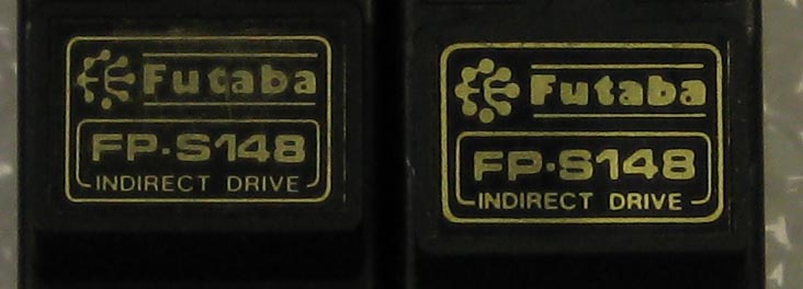

here is a shot of the old style sticker. I can't find a new style one to shoot side by side, but compare it to the one linked above to see the difference.
- Attachments
- olds148.jpg (48.65 KiB) Viewed 1524 times

there's actually 2 different ones like you posted, anthony. the sticker looks the same, but the little logo and the futaba lettering itself isn't as bold. i'll have to get a side by side pic.
