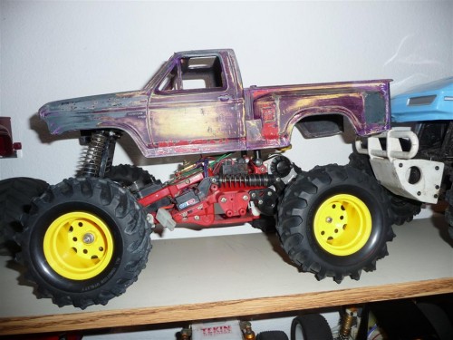

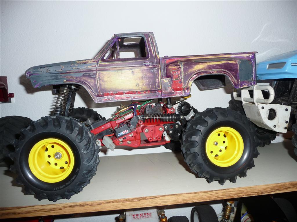

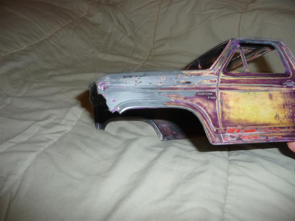

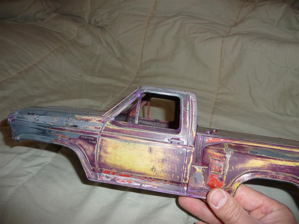

This Blackfoot body has seen better days. There were/are many layers of paint, the front corners both need repair and the front of the hood has a warp or melty spot. It will be a real challenge to bring it to a presentable state. Would you tackle it?

I probably wouldn't resurrect this one-mainly because of time. I rarely get more then 30 min. at a time to play so by my estimation I would finish it by 2013. How would you rebuild the front part of the lower fenders if attempted?

I think i would use styrene plastic stock attached with model cement to rebuild the general shape. I might drill a very small hole in the broken edge with a pin vise to insert a metal pin of some kind for strength. After the basic shape is there I would use auto body spot putty to fill holes then sand, smooth, sand, smooth. Probably use some strip styrene on the back side to reinforce the joint. Obviously this repair would never stand up to an accident, but it should be invisible on a shelfer. I have seen some pretty amazing repairs on some of the older stuff. For the hood, probably I would just fill the warp and sand it out. The FORD script on the hood lip would have to go of course. I think it's a matter of time, rarity and bull-headedness that makes people take on challenges like this. For me, I'll probably make the attempt, just to see if I can.

Yeah, I hear you. I have another very nice Blackfoot that is getting the resto treatment. This one is more or less an experiment. What you seen in the pictures is the result of several days of work with brake fluid and oven cleaner. This thing had four or five coats of enamel on it. I've had varying success at stripping depending on what was used to paint originally and how long the paint has been on. Sometimes the brake fluid works better than the oven cleaner and vice-versa. Lexan is usually tougher. i just stripped Turbo Ultima body and it came out crystal clear but others have clouded and gotten brittle. go figure.
