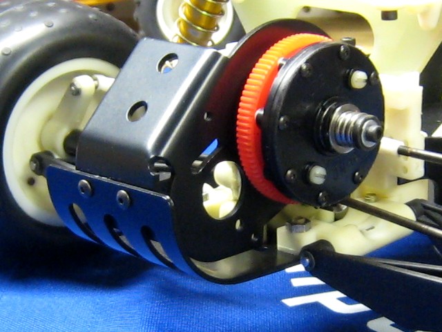

I have this RPM stealth tranny case.
My question is can I use regular stealth internals in it? I also have a stealth with ATC, what is the ATC?

that is intended to use a donor stealth to complete. it uses the stock idler and diff, it just replaces the spur shaft & gear with a different one to drop the tranny ratio.
atc = associated torque clutch (slipper unit)

Although the topshaft on that tranny kit is for a Losi Hydradrive... so, you'll need that 'cause the Associated slipper won't fit. :wink:

templeofspeed wrote:Although the topshaft on that tranny kit is for a Losi Hydradrive... so, you'll need that 'cause the Associated slipper won't fit. :wink:
oops... i didnt notice it was for a hydra!

so basically I can put all stealth internals in this gear case?

shodog wrote:so basically I can put all stealth internals in this gear case?
Jim
ya, but the problem with the kit you have is that it's designed to use the losi hydra drive system, not the associated atc. the kit you need is 8055.
this is what you'd need for that topshaft

It will work with a Losi slipper without the hydra just as well.
btw, I have both, Losi slipper (might have enough to sell one) and a Losi Hydra drive, not really planning on selling.

will a hydra off a losi tranny fit the associated that has the losi shaft?
losi didnt make a ae specific hydra did they?

badhoopty wrote:will a hydra off a losi tranny fit the associated that has the losi shaft?
losi made the topshaft for the stealth to accept there hydra setup
