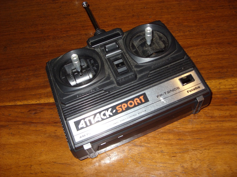

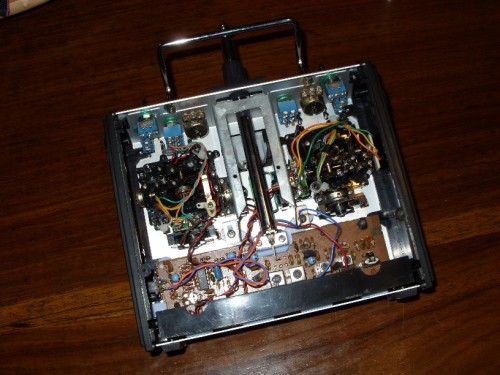

It all started because, since a few months ago, I thought my 75mhz AM Futaba Attack was old, well, after all, I got it for less than USD$10 back in 1992 when I was going to school in Chicago. :roll:
One thing I did not like about the attack, even though very economical and robust, the trim shifts a lot, I have to adjust the trims everytime I run my cars, even though I do not run my cars too often. :cry: Well, this was a design problem, there ws one rheostat for each channel and the trim was simply a physical shift of the whole rheostat, which was a bit pre-historical. :roll:
My old transmitter. A bit dusty but it works OK... and I though it could look smarter....

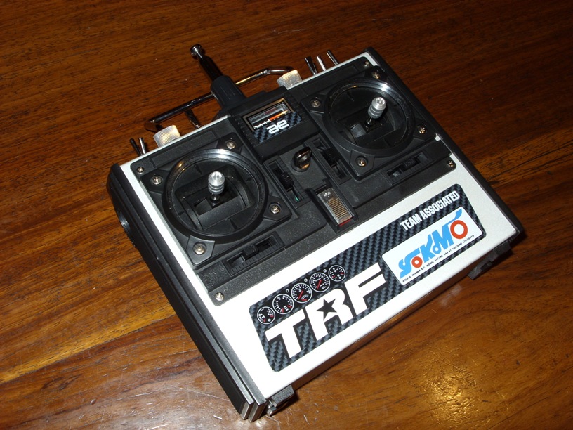

Then I found this Expert 7ch transmitter NIB for sale on the bay a few months ago and got it for ~USD18, shipping was expensive though, cost me close to USD$50 in total....
It is smart looking, professional look alike, after all, with many switches and buttons :roll:
I told my colleague at work, the whole reason I bought it was because it looks smart, as though it would have changed my IQ by a % point or so :P

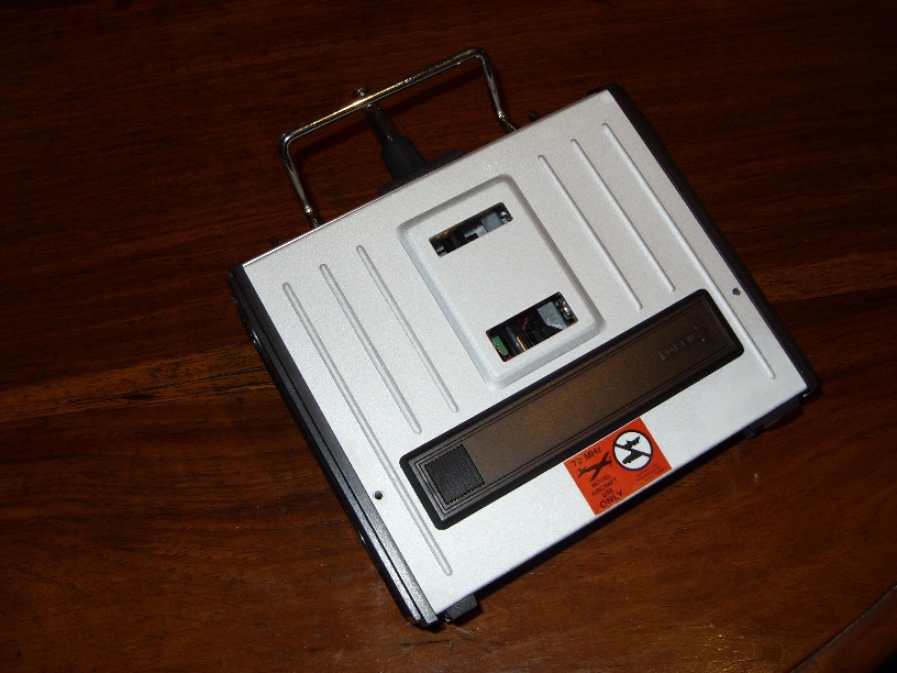

This the back, nice and clean with a small window so that one could tell the frequency module inside, it was FM 72mhz, meant not for cars, therefore you see a red sticker at the bottom.
This is the transmitter, a bit larger than my Attack, thicker by about 1cm. There was as sticker dated 1989. Perfect condition...

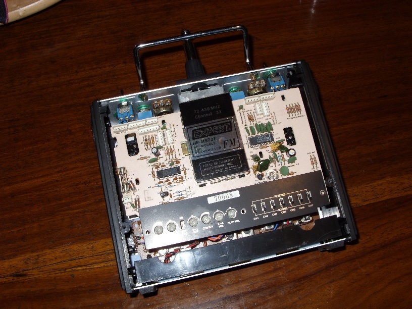

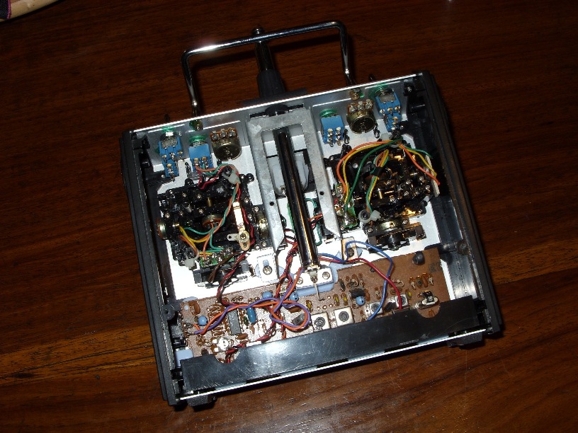

This was the look of the transmitter after I unsoldered the wires between the board and the control switches on top of the transmitter. Rather clean design.

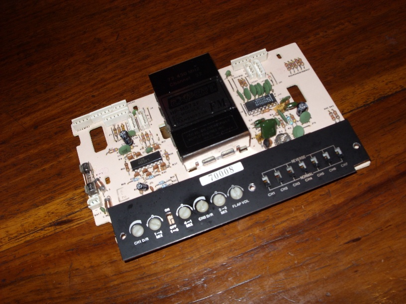

This is the whole circuit board of the 7ch + the frequency module. Rather simple. You can see the little switches for reverse and channel mixing. I felt like I have destroyed an art.... no, an antique.

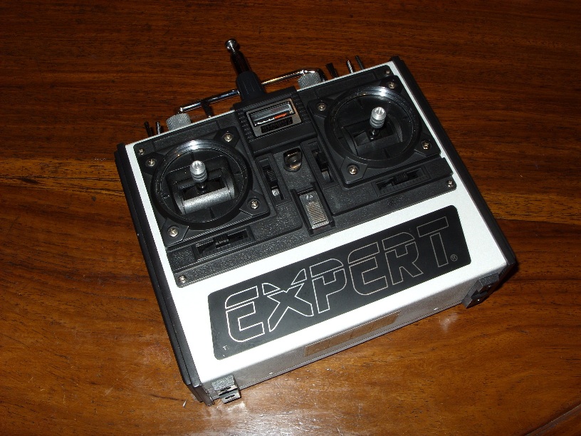

This is the completed item. Basically, I transplanted the circuit board of the Futaba Attack into this case. The light blue colored areas at the antenna base was dental acrylic resin, which is very strong and I used to reinforce the antenna mount.

Ok, at the end, the project was successful. :P
However, only one of the switches on the top panel was used for servo reverse. :wink: the other switches were there to show of my intelligent capacity (or dis-capacity) :mrgreen:
The main advantage was that now there are 2 rheostats for both channel 1 and 2, the additional trim rheostats make fine adjustments so much more reliable. :mrgreen:
This is still essentially a futaba attack 2ch 75 mhz AM transmitter with 20+ years old technology.
This project reduced my net worth a bit but did not change my IQ in anyway at all, which was disappointing :( but not surprising... ;)
