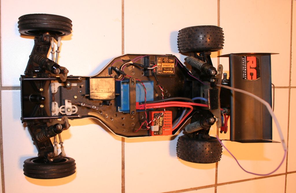

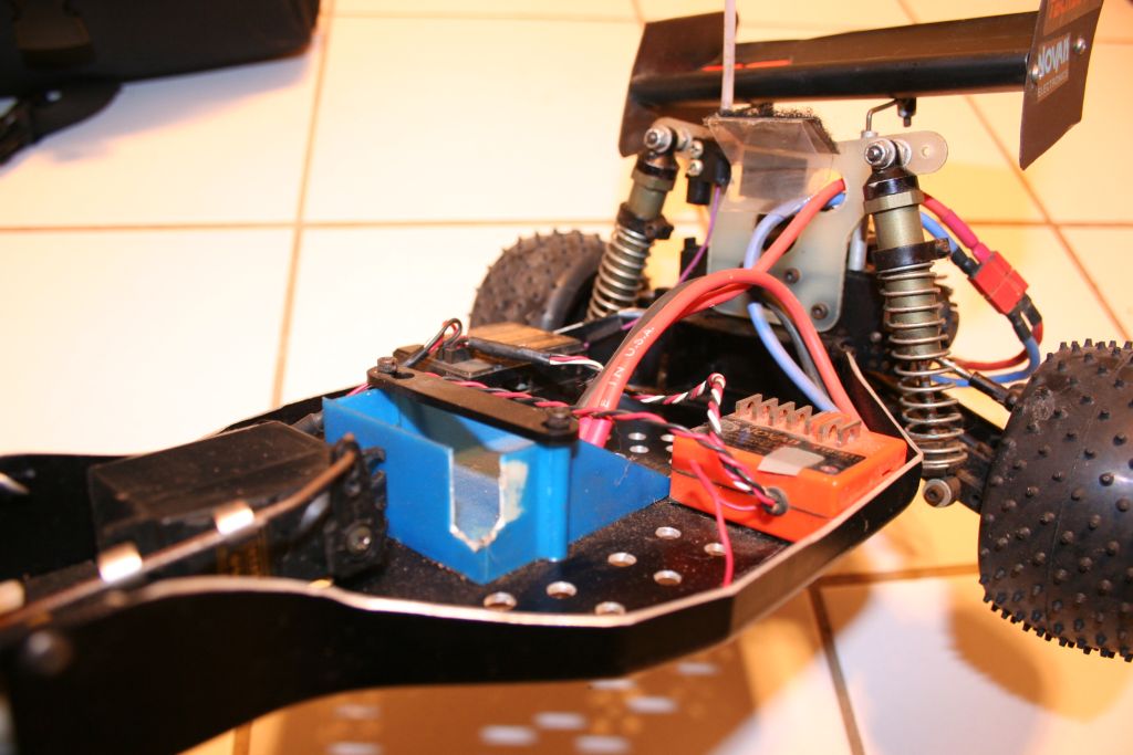

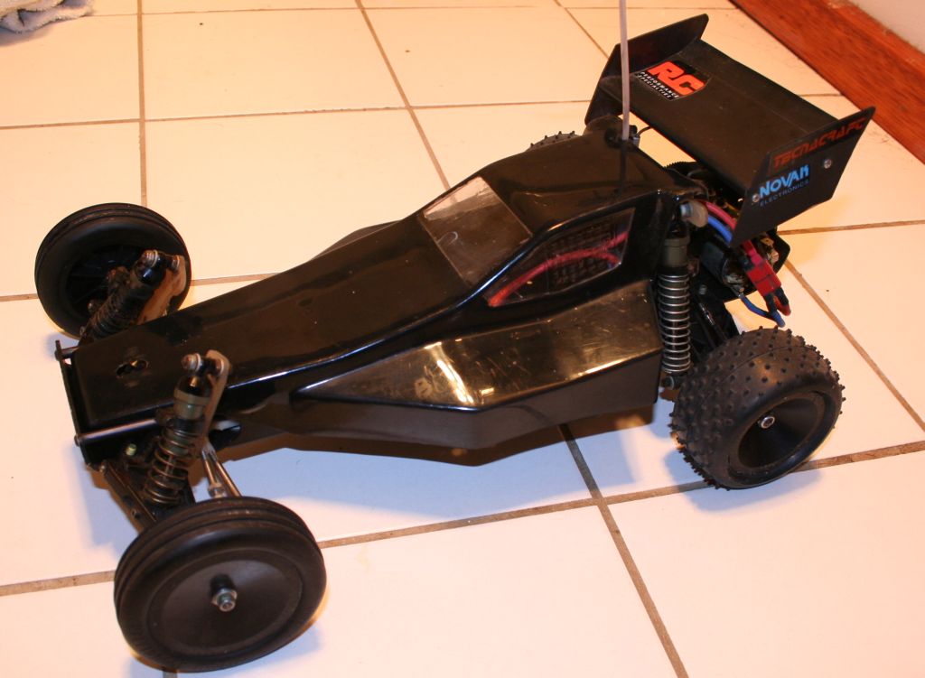

I used to race this sometime in the early 90s it's been in the shed ever since but I thought I'd digg it out and show it to you guys, it hasn't been run in over 15 years I think and maybe one of the oldest all black stealth bomber themed cars that exsists. I can't remember exactly which car of Masami's the chassis mods are copied off but back in the day I modified the chassis to be pretty much an exact copy of Masami's car. It used to be the quickest car in 27T class at the local club when I ran the slot machine motor and was only a couple of grams over the legal weight limit. The spring setup is exactly how it was whenI last raced it and as far as I can remember was also copied from Masami's car (I was obessed) so there maybe something in that for someone into the history of these things. All the rods and arms on the car are titanium.
I allways wanted to upgrade it to the wider front arms that was a option for this model not long after it was released so if anyone knows about that kit and if there's any new old stock laying around I'd like to get hold of those parts to finally make the car how I wanted it
P.S I'm not sure how it ended up with the blue battery holder, it had a black one when first built :)

most likely, the front end your talking about would be the rpm "worlds" conversion. which has been discontinued for quite some time. and when you find them, they bring some serious coin.
but, you can piece a kit together, although it won't be all that cheap, neither. first you'll need a 10t noseplate, 10t front bulkhead, 10t inner front hinge pins, and 10t nose brace tubes. the worlds conversion had a special front shock tower, but you could use the tower from a 10t/t2 if need be. it'll bolt right up, but the top of the shocks lean in more. you'll also need a pair of 1.02 shocks for the front now, too.
then you'll need to get these arms. they're a copy of the rpm worlds front arms. they are sold individually at $8.00 a piece....
http://dynotech-racing.com/partDetail.php?RefNum=2701
dynotech also reproduces the worlds front tower in carbon fiber for i think $40. there's a thread about them somewhere on the forum.

Nice wing, looks like a Tecnacraft aero-foil painted black.

I found the associated pinion gears on towerhobbies before: ) thanks. Yeah I believe that's what the wing is (that sounds right to my memory) and yes it's just painted black. I kind of wish I still had the original wing on it. I bought a complete rolling B2 team car on ebay a couple of days ago, it'll be a while until I have it but I bought a few b3 parts for it so I can drive it without worrying about breaking the rare(er) b2 stuff, I'm interested in seeing what gains associated made over those years.

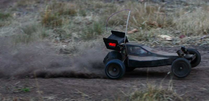

Went for a spin with this today first run in about 16 years, the tires were slipping badly on the rims but still managed a picture. The car only has 1-2 hours run time on it since new so it still drives like a new one
