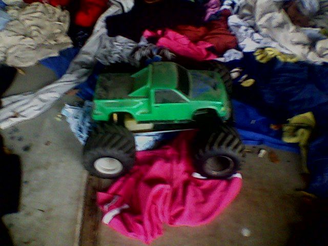

Hey guys help me out here. I have a friend that has what he claims is a Nitro Monster Crusher. This truck is super old and from what I remember it steers front and rear. He wants 50.00 for it. Can you tell me who made it and if its worth the 50.00? I have no pics of it and have searched ebay with no matches.
I just got pics through fone but they arent the greatest What the heck is this thing?

Haven't heard of it RC Chick. I have seen what was once a LHS owners son's kyosho nitro monster truck that had an aftermarket rear wheel steer setup. If it runs, is complete and has a radio system it would be worth $50 in my opinion but would have to see it first to see what kind of offstream setup it is. you got any pix of it?

I do but they are bmp and my computer won't let me change it. this site doesn't allow bmp.

do you have like adobe photoshop or something that will convert it to jpeg or something like that?
Re: Nitro Id help -Pics added!
Thanks for the pictures
That is the Kyosho USA1 Nitro Crusher, and the manual can be downloaded here.

That would be very similar to the one I was thinkin of anyway...and well worth $50. Don't know how hard it is to get parts for but it would be hard to lose money on that deal...even if was a complete POS.

If it's bone stock, I'm thinking a USA-1. Tomolupus called it a Crusher which sounds about right. Follow the link he posted and see if the truck looks like the manual, if so you've got your match.
As far as value, as with all things, value is based on what someone is willing to give you. The USA-1 trucks were less popular than the Clod (electric ) because they were harder to modify, had less support from aftermarket retailers, and generally not as good.
That being said, if you've got the time and the interest, $50 for a rig ain't that bad a price, keeping in mind that you'll likely put in 3 or 4 times that amount to make it a decent runner.

Official title was Kyosho USA-1 Nitro Crusher
One I found for sale but didn't buy
A very sweet shell I did buy Cheers to Brandon for arranging USA post.
And my Nitro one unrun unpainted
Hope some of that helps, and it's a steal even to break for bits if the tyres are good

I was so focused on the the truck, did anyone else miss that it's parked on top of pink undies?

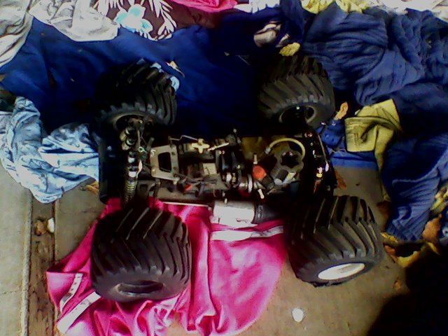

Thanks for the help guys. I have always wanted that truck, ive known him for 10+ years and drove it once way back then, but the motor broke. All I know is he has since lost the remote but has rebuilt the motor but never ran it or started it since he rebuilt it. He says it starts with a wheel start whatever that is. I just wanted to see if I could get it to run and drive it a few times and then fix it back up to sit on a shelf. Im going to get it in a few weeks so I'll take better pics when I get it.

The truck pictured is a USA 1 Nitro crusher. There was also an electric version that was based on the Kyosho Double Dare but the USA 1 had slightly longer arms. The electric had 4 wheel steering.
The nitro crusher shared about 95% of the parts with the Kyosho Burns. Some of the unique parts were:
wheels and tires (captain obvious strikes again)
front and rear shock tower
Body mounts
8 kyosho kelron shocks
front bumper (slightly narrower than the burns)
Gear reduction system (1 large and 1 small sandwiched together) placed between the clutch bell and center diff gear
hope this helps...

Thats a wheel starter, possibly what he means, otherwise a starter box, basically has one of those mounted and you drop the trucks flywheel on to spin it up.

The head on his looks alot like my OS RG.21 which is a real decent runner. Even without the radio it will be a nice price but as Halgar mentioned its what you're willing to pay for it. To me and my money situation using your reasons for wanting it $50 isn't too much. It isn't going to lose any more value than that and you wouldn't have any problems getting your money back out of it again someday if you had to/wanted to liquidate your rc collection. To me its a great find and look forward to your pix when you get it.
