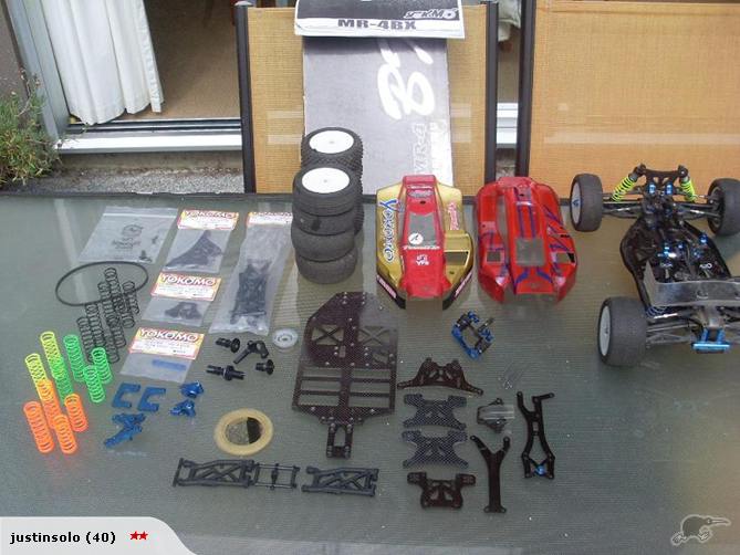

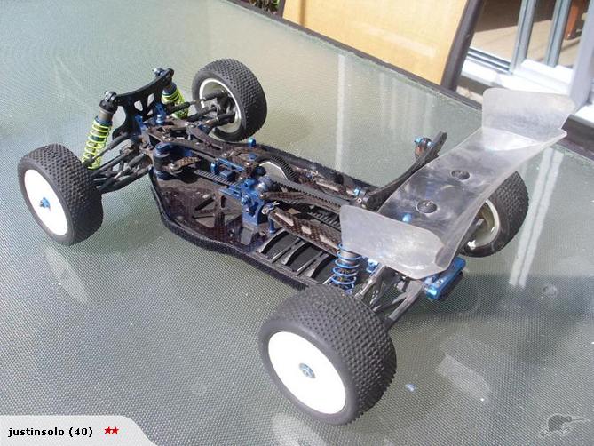

Totally stole the car for what I paid for it...Got the car,two bodies,a new spare chassis,lots of new in packet parts,a Tekin G12 ESC,three sets of wheels/tires,a new IB 3700 battery a new 15x2 motor...All for US$100!
Here she is,I'll be picking it up on Wednesday.

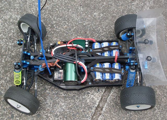

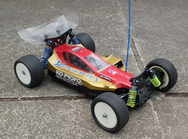

I rebuilt the diffs,tweaked a few things and took some photos...Please excuse the front right spring that isn't seated properly :oops:

Looks good, that's a neat brushless install in a chassis that's difficult to keep tidy. Can you access the motor pinion? I had difficulty changing pinion with my brushed ESC there.

minichamps11 wrote:Looks good, that's a neat brushless install in a chassis that's difficult to keep tidy. Can you access the motor pinion? I had difficulty changing pinion with my brushed ESC there.
Untidy wiring is one of my sore points,I try to really plot it out first.
The Mamba sists in there nice,after a few tries.It is a tight chassis,that's for sure. :shock:
I can indeed access my pinion with the Castle brushless motor in there,they have a longer shaft than most brushed motors.
Maybe try installing your pinion gear backwards?
I'm usually forced to on brushed XX era Losi vehicles.
