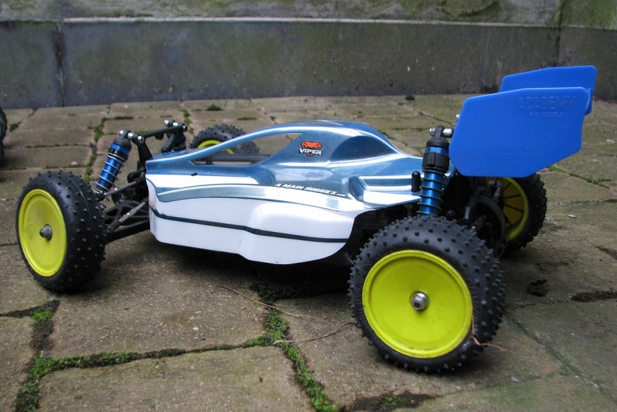

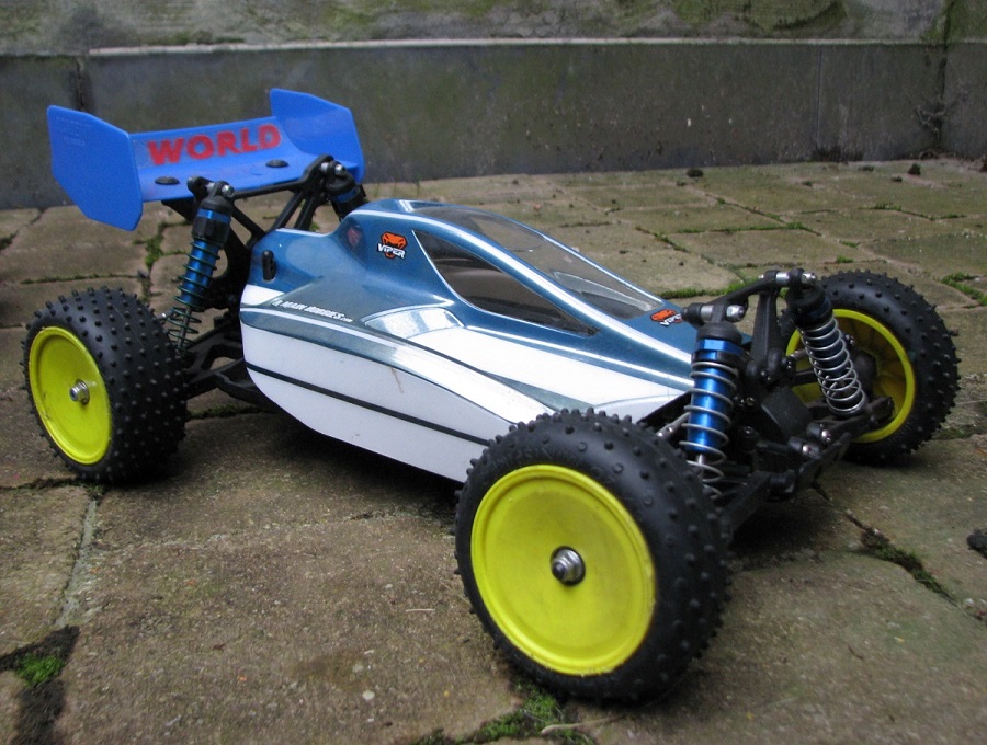

I'm just putting up a couple pics of the cars I ran during my radio-silence.
There were more, but these are the only ones which are still presentable.

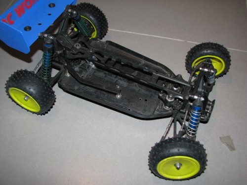

This Yoke got a new full bottom chassis which I trimmed most of the inner ribs off: to allow some different layouts. The servo is moved on the centerline now the belt is gone. shorty in the back opposite of the motor, and ESC and receiver in front of the motor. Blue associated GT shocks do a great job, and give just a little extra travel over the originals. But more important : they leak a lot less. The body is a Tamiya Baldre I painted about 6 years ago.
And for compatibility with most of my other cars, it runs on 12mm hexes all around.

joking aside, i would like to see how you modded your chassis. and you're running all hexes on stock axles? or did you find some cvd's or cva's that did the job?

Didn't get the joke, but I was told there's a problem with viewing the pics in my recent posts, so maybe that's it?
Should be fixed now.

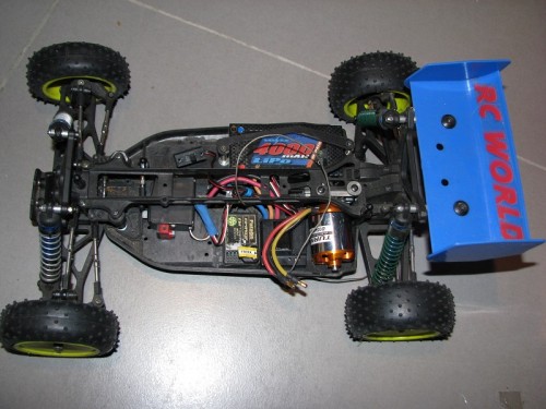

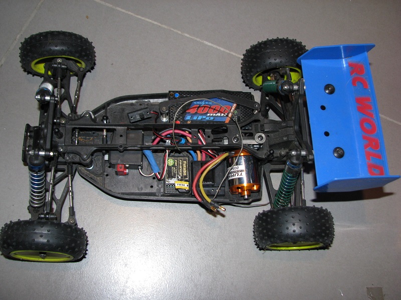

And here are some under-the-body shots: with a mockup of the electronics and current state.

Oh, for the hex conversion: up front I think I used tamiya M-chassis axles (the kind you find on the non-driven wheels). In the back are universals and different hubs, both from 2 different Academy cars I think.
