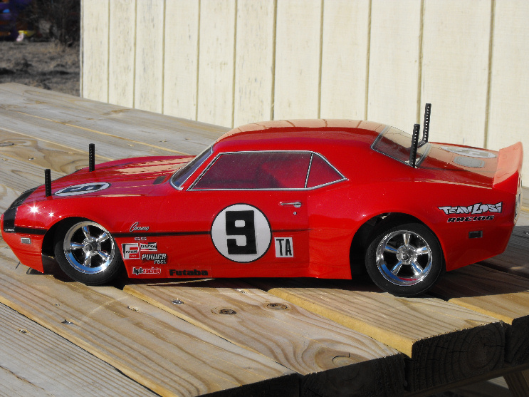

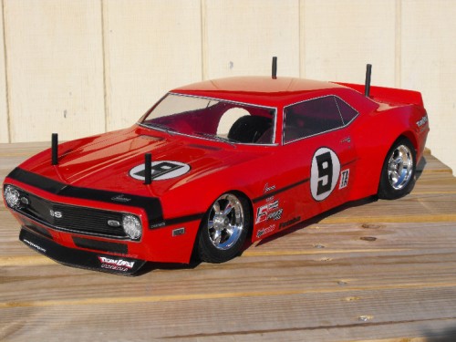

well here are the picture of my first atempt at a trans am car. I am not happy with the wheel base on this car yet but I am still working on it? Its a long way from finished and I am working on another one thanks to Red Scamy I will have a Saleen Mustang up this weekend.

That is sweet! Simple and effective. Can't wait to see the next one!

Thanks, its hard to make a 1st gen Camaro look bad :lol: I like things simple

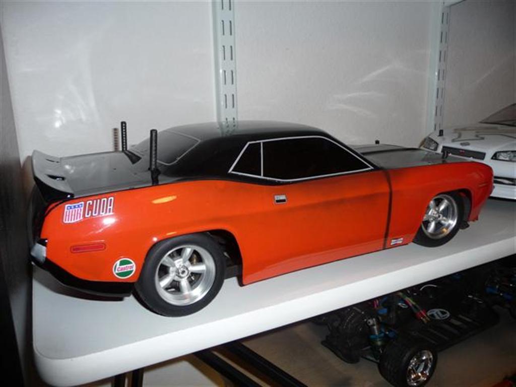

I had this Cuda looking pretty sharp, to me anyway, until I sprayed window tint too heavily and it ruined the orange paint. I don't know what to do with it now...

that sucks! I ordered a new Camaro body in case I have to redrill the post holes. I have thrown out more bodys than I have ran. I guess I am to picky. its getting expensive :evil:

Not a perfect solution, but spray the rest of the orange with solid black on the whole car. It will run dark, maybe a rust or even brown, but it won't look like a complete mistake.
The Cuda bodies are hyper thin around the front light buckets, so a few whacks into things, and they tear easily. Before running them, run a thick bead of ShoeGoo down the front fender corners and let it dry. If you are planning to race it, re-enforce the wet ShoeGoo with filament packing tape strips like a mini fiberglass patch kit.
The Camaro is probably the most durable, but the heaviest. The Cuda is one of the lighter bodies, and my favorite racing bod for Vintage Trans Am. I'll probably be running a Cuda at the USVTA Nationals this April.

That's a good idea! I will try it out. Nothing to lose! Thanks for the shoe goo tips. We have a local club that races trans am but I'm too chicken to go down there and demonstrate my crap driving! I'm way too old to run with the little kids and the big kids kick my butt! Check them out at:

As far as the wheelbase issue goes, is there any way of flipping the rear arms to shorten the wheelbase? There may be some tricks you can do. I was able to shorten & narrow a Kyosho Triumph by using different modified arms. No chassis mods.

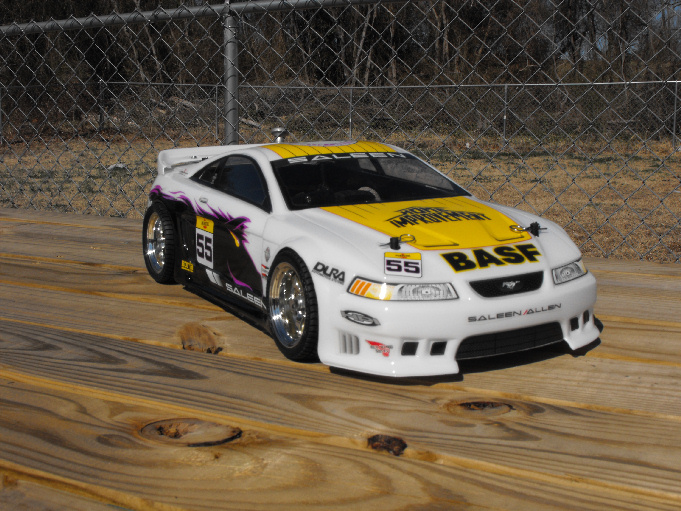

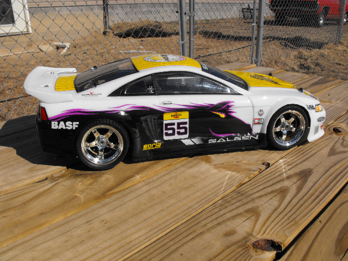

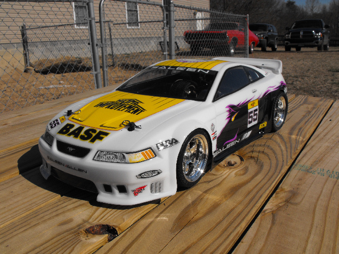

Well the weather was nice enough to take some pic's today. here is my second xxxs with a Saleen Mustang body.
I know the wheels are yellow on the real car, but these look so good I dont have the heart to paint them. 26 mm X 9mm off set on rear with 31mm tires their fat. 26mm X 6mm on front with 26mm tires.
