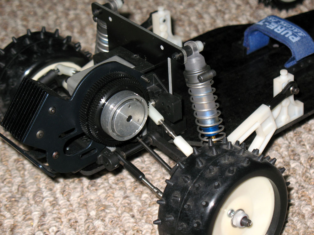

Any one ever see one of thease. its cool. I just but it in and don't know how it will work. It said street car only. And you can't even push it backwords. I can't wait to try it out. This car is fast as it was can't wait to se how fast it will be now.

I've got one installed on my JRX2, the only difference is the top shaft. But I never run any of the builds so I honestly don't know how it works. However, I would like to know myself.

I have one of these on my electric RS4 original. They work okay on an electric car. The problem is finding the sweet spot for the shift point. During the first part of the battery, it shifts too easy and towards the end, won't shift at all. These work way better on Nitro powered cars becuase the motors power is consistent throughout the entire run.

DO NOT RUN THIS SETUP WITH REVERSE!! I found out the hard way and stripped a gear. I got it for my RS4 Rally Around 2000.

Yea I herd that. It said not even to turn the wheel or push it in reverse. And i did . And the nosie that came from it was not nice. They said it will mess up the one way sprag in it.

I had one of these on my DS. First run while testing in the street without the body on, it flipped and the top shaft broke off, the spurs and clutch bell separated and rolled away. Back to single speed.

I had one of those. And yes, the shift point can be tricky since when the battery starts to dump, the motor may not hit the shift point. This may not be an issue now with Lipos. Also, the one I used had a MASSIVE wobble. Just too much rotating mass, I guess. You can't fit a gear cover over it so it's only for street use. I sold mine on ebay years ago. I think it's a novelty part.
