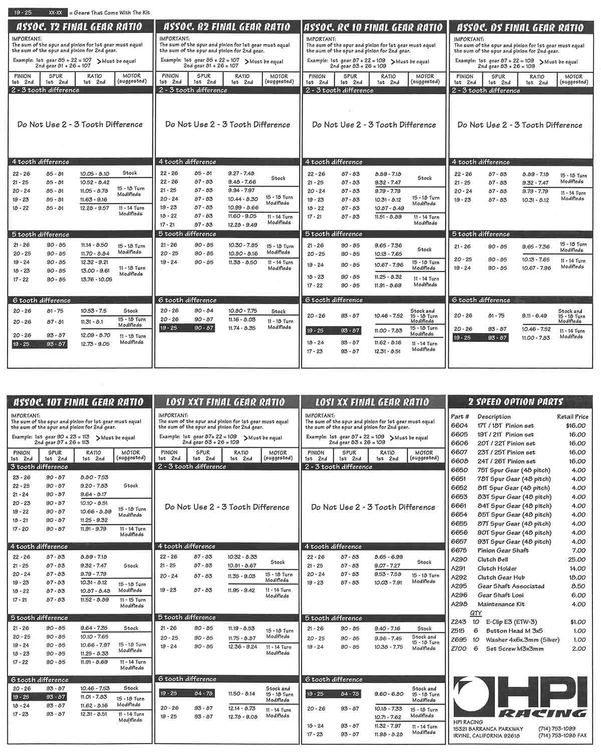

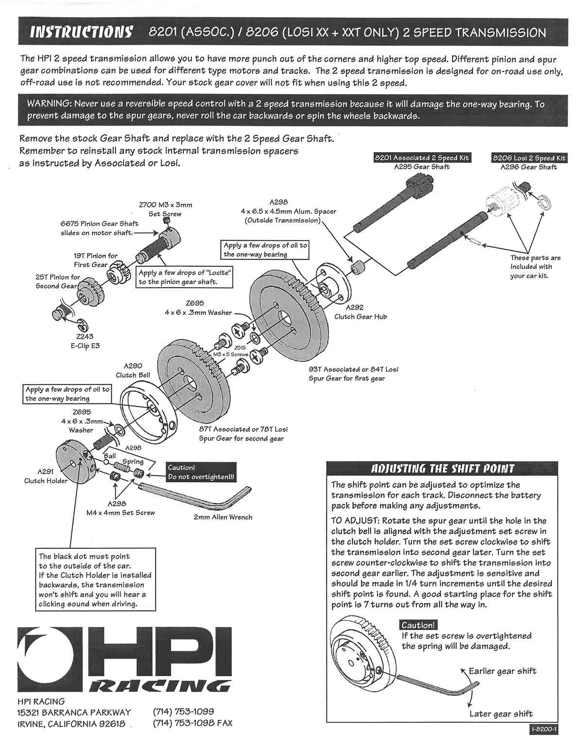

HPI 2 speed trans set-up manual for the RC10
Post by Asso_man! »
As promised!

Excellent, I recently picked up a 2 speed kit and the stealth shaft to put in on a stealth tranny.
