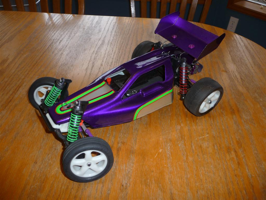

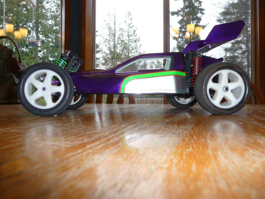

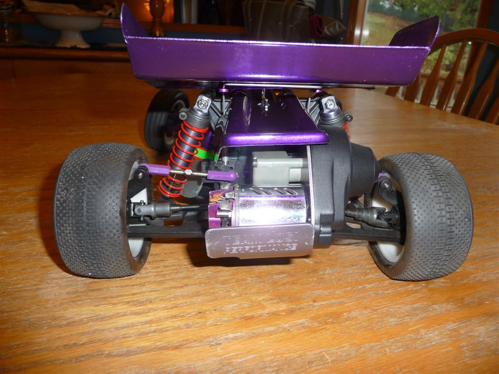

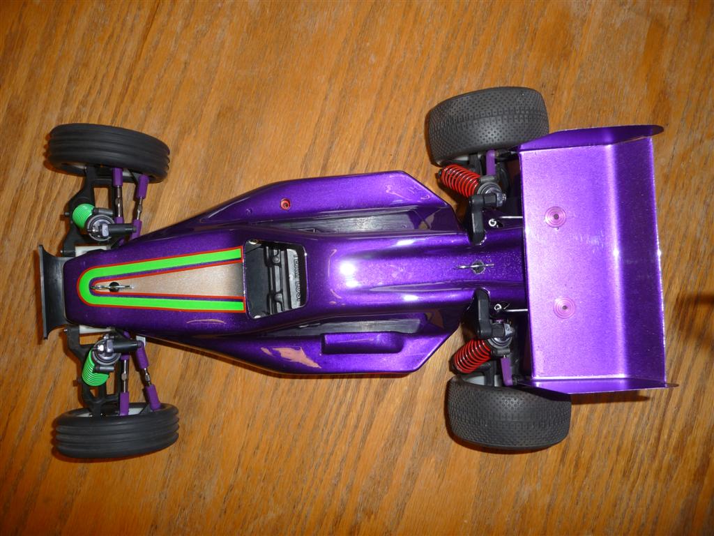

Well, actually it is mostly new. Just a couple of pieces need to be replaced to make this a real beauty. I can't take credit for it, I got it from Rick (bearrickster) last week. He is turning me into a Losi addict. :mrgreen: I love the efficient, clean design of these cars. Rick was kind enough to send a new unpainted body along with this one, which I actually really like. The only thing I've done to the car is dust it and for kicks I added some red pin striping to pull the red rear shock springs into the overall color scheme. Oh yeah, I stuck the funky old ,motor in it because it had purple stuff on it. :lol:

Are you using XX hubs for those wheels?

wts873 wrote:Are you using XX hubs for those wheels?
Actually, I don't know. Rick built the car so I'm sure he'll chime in and let us both know. :shock:
Gary
bearrickster
Posts: 4372
Location: Hollywood Maryland
Re: My new (to me) Jr2!
Post by bearrickster »
Just on the front I used XX carriers and hubs. you have to drill out the hinge pin to make them work but then you can run matching modern 2.2 tires. I like the red on their. I have its twin almost done you can have a pair :lol: :lol:

maybe it's just me but the front track width seems smaller than the rear one

Asso_man! wrote:maybe it's just me but the front track width seems smaller than the rear one
Good catch, I think you're on to something.
Looks like whoever had this car put Andy's narrow AE arms on the front.
nope they look like RPM ones and I even wonder if they are not RC10 "'91 world's" ones :shock:

they look like the correct "rpm" losi arms. i think it's more the negative backspacing of the xx wheel that's making it look so narrow. or it's whatever knuckle/axle is on it to make those rims actually work on that car.

Here's my response form this thread: http://www.rc10talk.com/viewtopic.php?f=27&t=6037&p=57276&hilit=rpm#p57276
As far as the offset, the XX wheels do have slightly more negative offset, so the result is that you car's overall width is narrower than a stock jr. The way to fix this is to use a pair of RPM jrxt arms (slightly longer than the stock losi). This will bring everything back to specification when using the XX front blocks and spindles.
