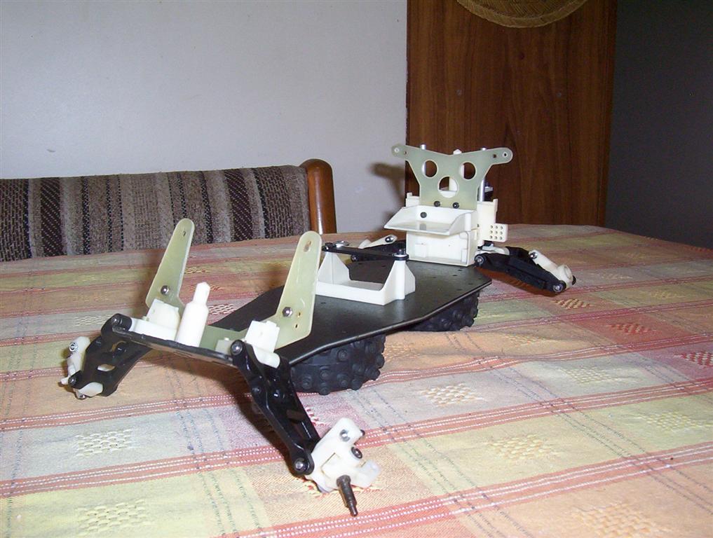

Hi Guys,
I made a start today,
Cheers, Dave. :D

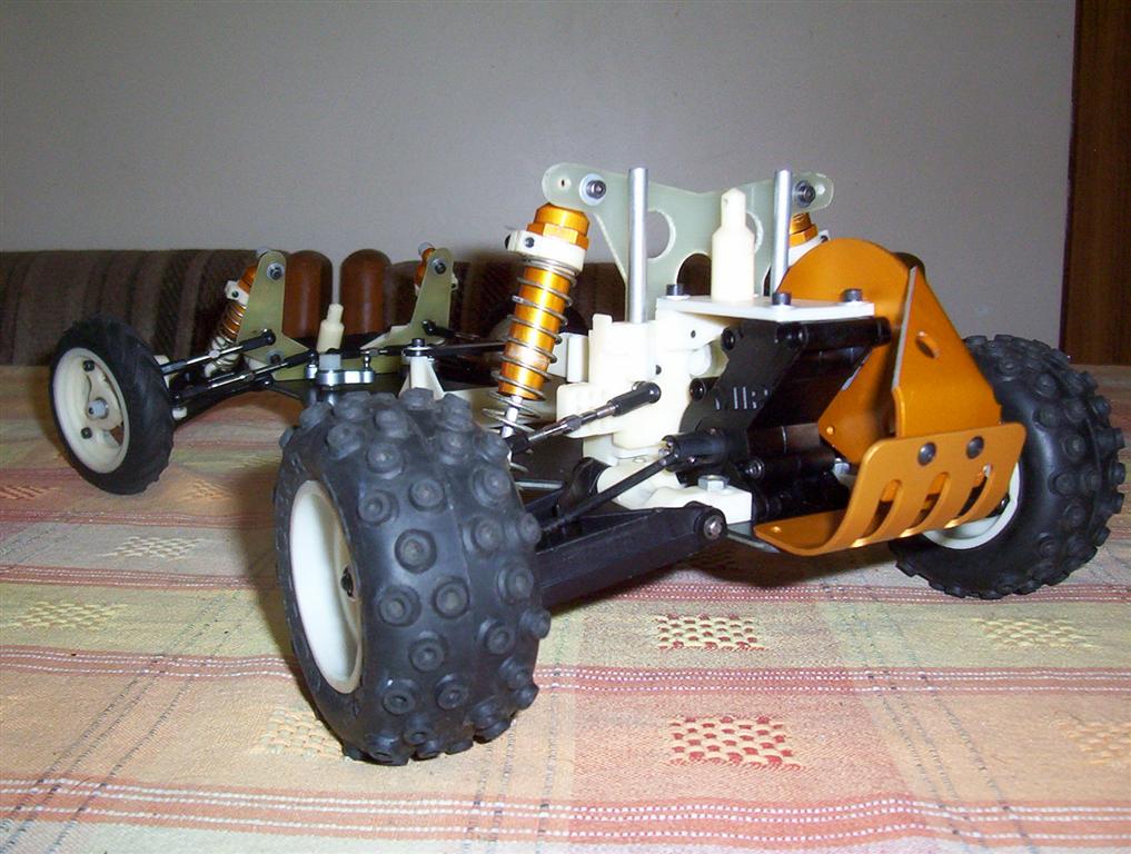

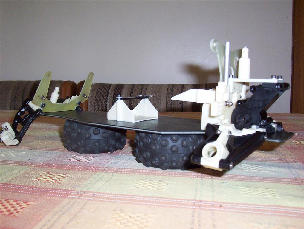

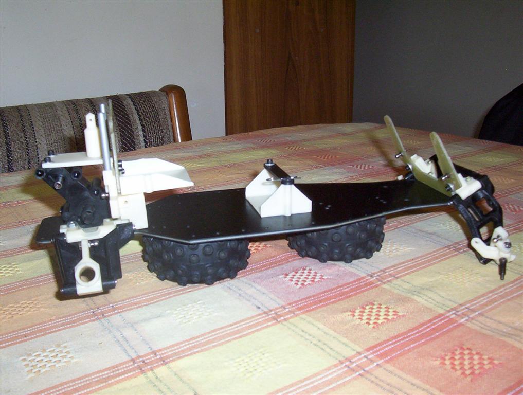

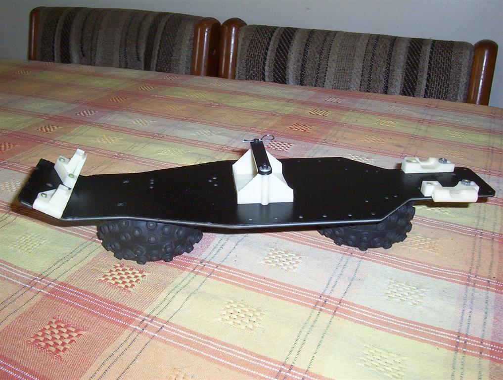

My first MIP gearbox restoration,
The outdrives were corroded onto the shafts, took some getting off.
Everything else went well, it has a ball diff and does not have the Tork control on the top shaft.
The idler gear was loose on the idler shaft, I center punched a couple of marks on the shaft and
also used Loctite heavy duty retainer for slip fitted parts.
Latest pics,
Cheers, Dave. :)

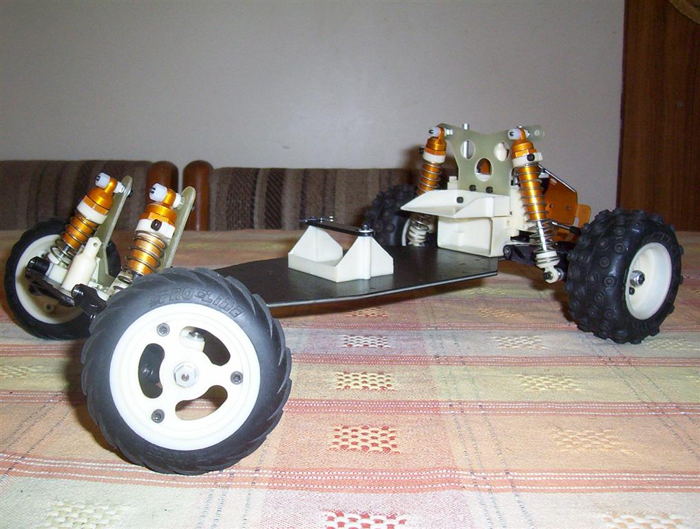

Here is the latest pics with my Jelly bean wheels with your favorite tires, Octi Grabs! :lol:
Cheers, Dave. :)

Are the Trinity rear wheels 2.2"? They seem like a later addition to me and don't match too well with Jellybean fronts. I would expect something like a 2.0" Proline 2519 rear on a MIP trans car with Andy's arms.
DaveM
Posts: 1254
Has thanked: 727 times
Been thanked: 26 times
Re: Dave's Graphite Resto
Post by DaveM »
Hi Phin,
Thank you for the information.
These are the wheels that came on the buggy.
They are Trinity 2.2", are they too new for a pre 1990 buggy?
I do like the Jelly beans on the front with the solid rears.
Cheers, Dave. :)
